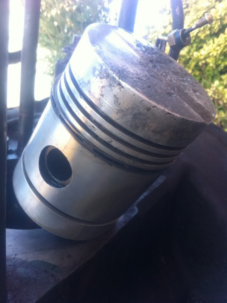

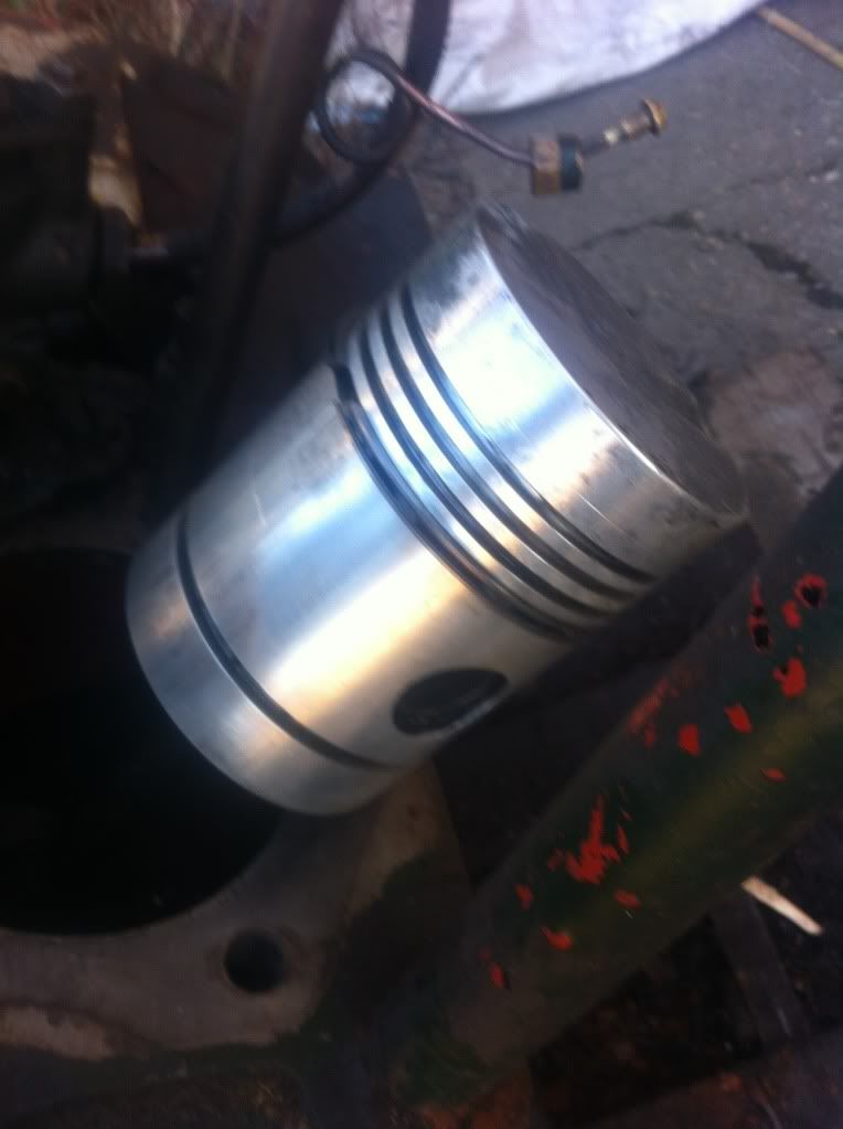

Thursday I decided to have ago at freeing the rings, 2 broke unfortunately. So new rings where ordered and should be here on Tuesday.
So today I decided to get all the rings out. They where stuck absolutely solid and had to take them out piece by piece.
The piston was then cleaned up and all looked okay.
So as soon as the rings arrive I can get it all back together and running I hope.
Ill put some pictures up later
Many thanks Lewis

Post by Hughesy on Sun Jan 13 2013, 21:24
Heres a couple of pictures of the piston.
This week i plan on borrowing a engine crane to move the engine onto another trolley and drain the oil whilst its up off the trolley.
Put the new rings in. Then rebuild the whole thing and get it turning over nicely.
Many Thanks Lewis

Post by Hughesy on Tue Jan 15 2013, 21:17
Well piston rings arrived today and they required gapping so took them down to a friend and he is gapping and cleaning the bore up alittle more.
The rings fitted in the bore without any gap. They require a gap of around 11 to 16 thou.

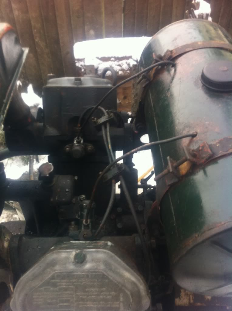

Post by Hughesy on Sat Jan 19 2013, 22:11
Hello all

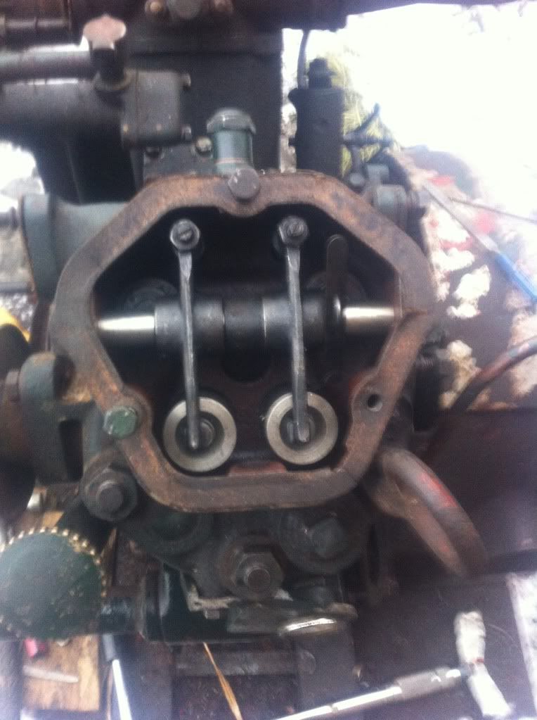

Got some more done today, The piston rings were gapped for me and the bore honed. I fitted the new rings wthout any trouble and then dropped the bore back on.
I then tighted down to required torque setting and re fitted the valves after that.
Both sides were checked for clearance on the valves. Then the rocker covers went back on.
The engine started to look a little more complete then.
The engine turns over great with so much compression its near on impossible to swing.
Glad its got decompressors fitted and a starter motor.

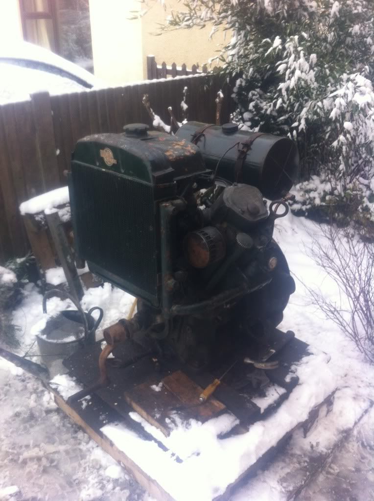

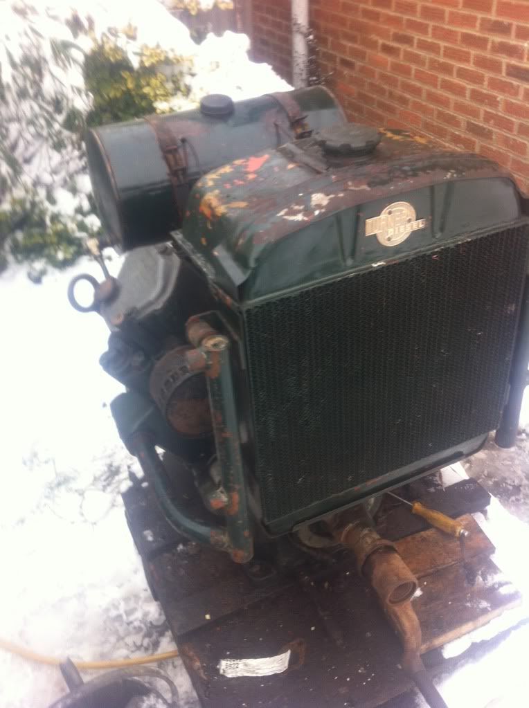

I then decided i would refit the radiator. I need one new section of pipe for it so will have to aquire one of those.
The diesel pumps are spraying diesel as i turn the engine over so thats a promising sign.
More to come tommorrow.
will be reftting the starter motor and the fuel tank. and priming the system hopefully.
Many Thanks Lewis
Age : 24
Re: Turner V Twin Diesel
Post by nutgone on Sun Jan 20 2013, 01:34
Are you going to wait until there's water in the coolant system before you start it up? (hope so).
Looks good anyway. I'm beginning to see just how big it is now. It was difficult to tell before, but she certainly is a big old lump isn't she?
Coming along nicely. Very Happy
Oh yes, & what's all this about electric start?!! Talk about luxury! Posh or what?!! lol!

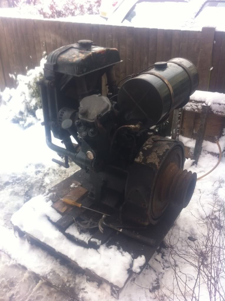

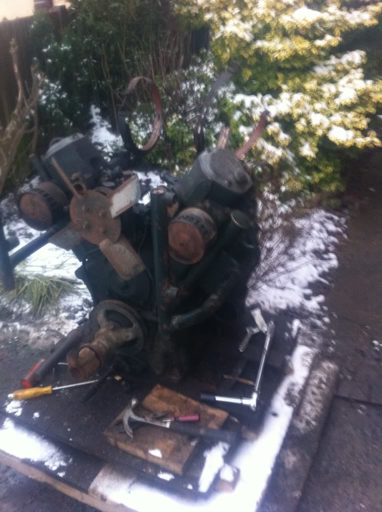

Well the engine is Nearly There.
The diesel Tank went back on today. The water Pipes all went on and where checked for leaks. Only one leak on the water drain tap.
The Engine has a lot of compression. You can bearly turn it over by hand. I Can also hear the injector pumps creaking so i believe they are working.
I need to test the starter motor now and also get the new bottom panel fitted to the exhaust.
I then need to get it running.
