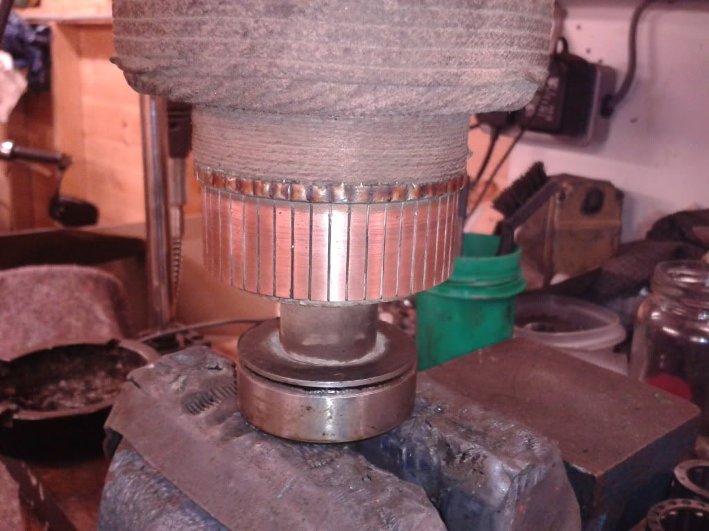

OK, quick update, the HT lead arrived so I finished off the engine, clamped it to the bench & gave it a quick test fire....

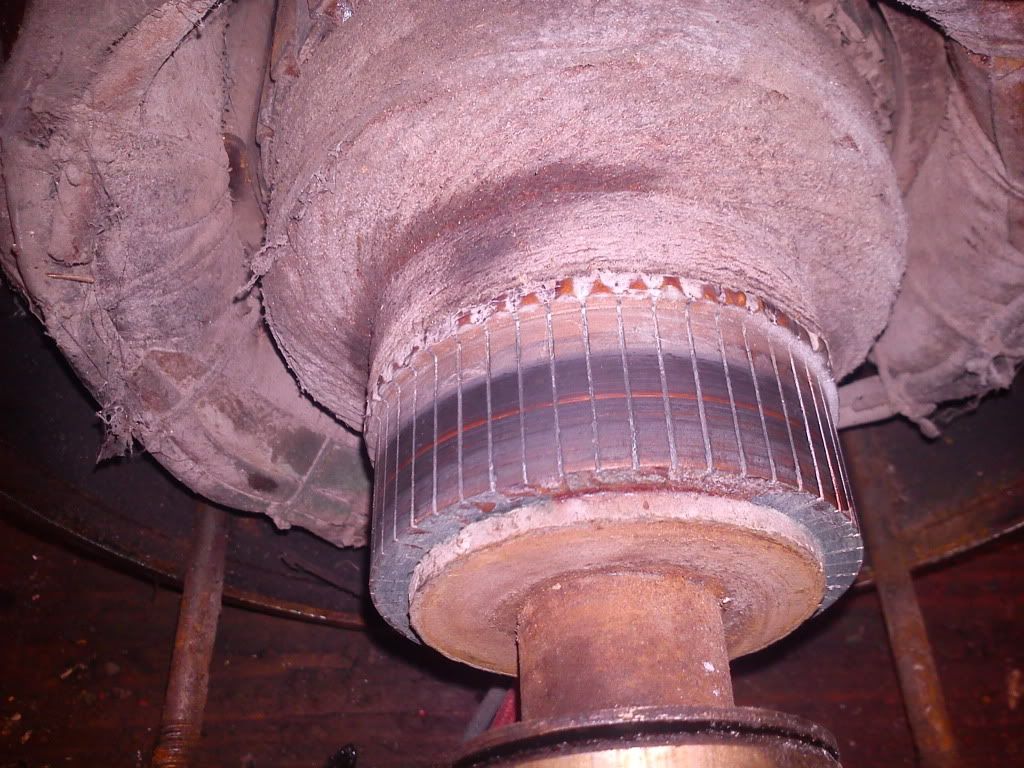

I also took the genny apart to check the brushes. The commutator is a bit dirty....
So I have under-cut it & polished it up (but forgot to take another pic Rolling Eyes )

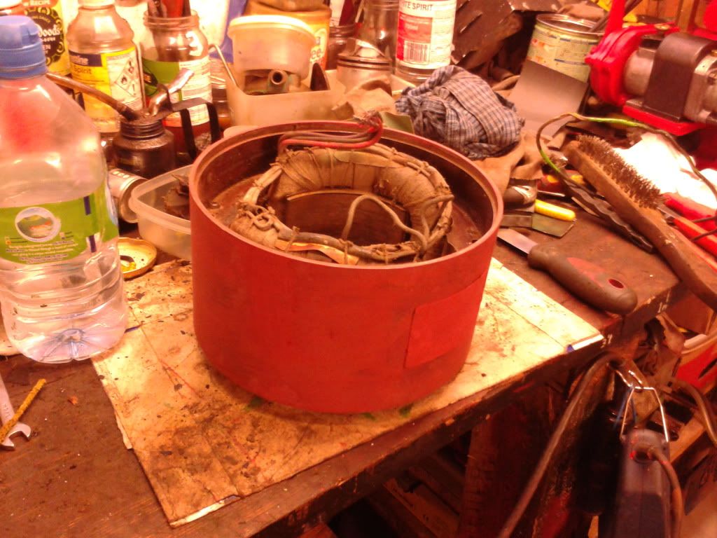

Anyway, on with the chassis. I took the flanges off each end & inside I found an original Tarpen silencer....
I think I can safely say that won't be going back inside.

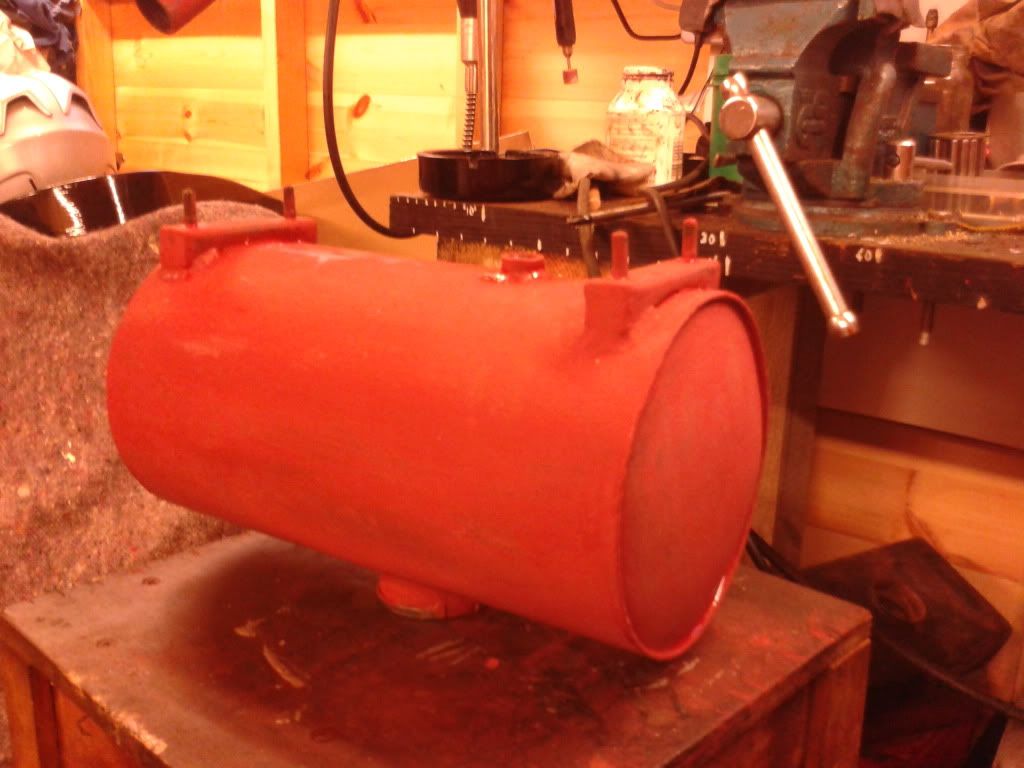

I de-greased & cleaned up all the bits yesterday....
I have also started painting some of it....

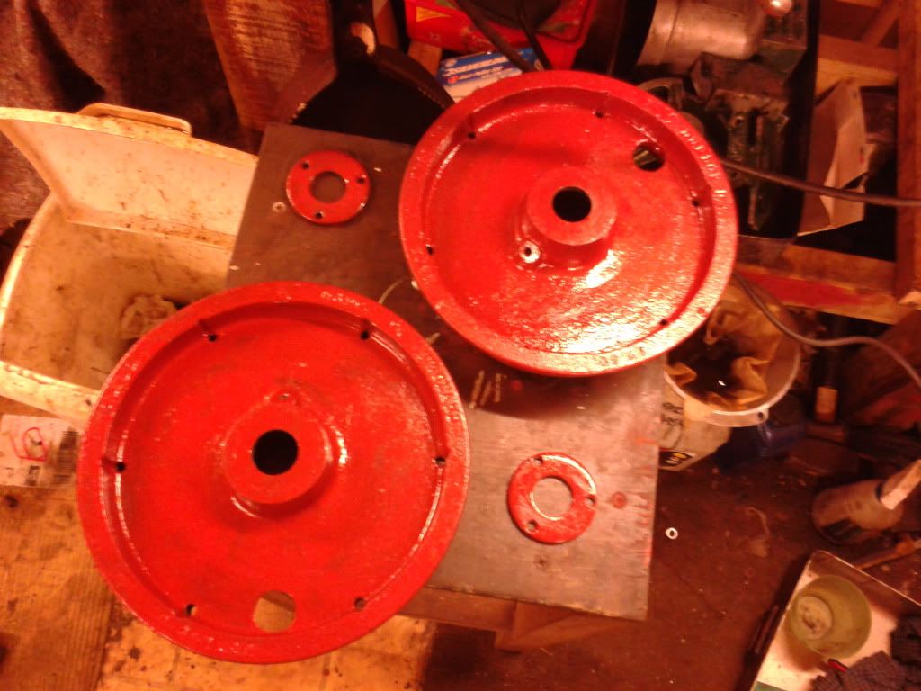

& I have split the wheel rims for preparation (these are different rims once again, this time they are Dunlop tyres & rims, both the others had Avon tyres on them, they still have the large caged needle roller bearings though)....
That's about it really. I just need to give all those cleaned & de-greased parts a final check over & sand down before priming & painting. The colour this time is slightly different once again. The paint left over from last time had got a skin on it, so I mixed it up with the small remaining "touch-up" pot of the bright green I had saved & thinned it all down with some white spirit, there should be plenty for the job now.

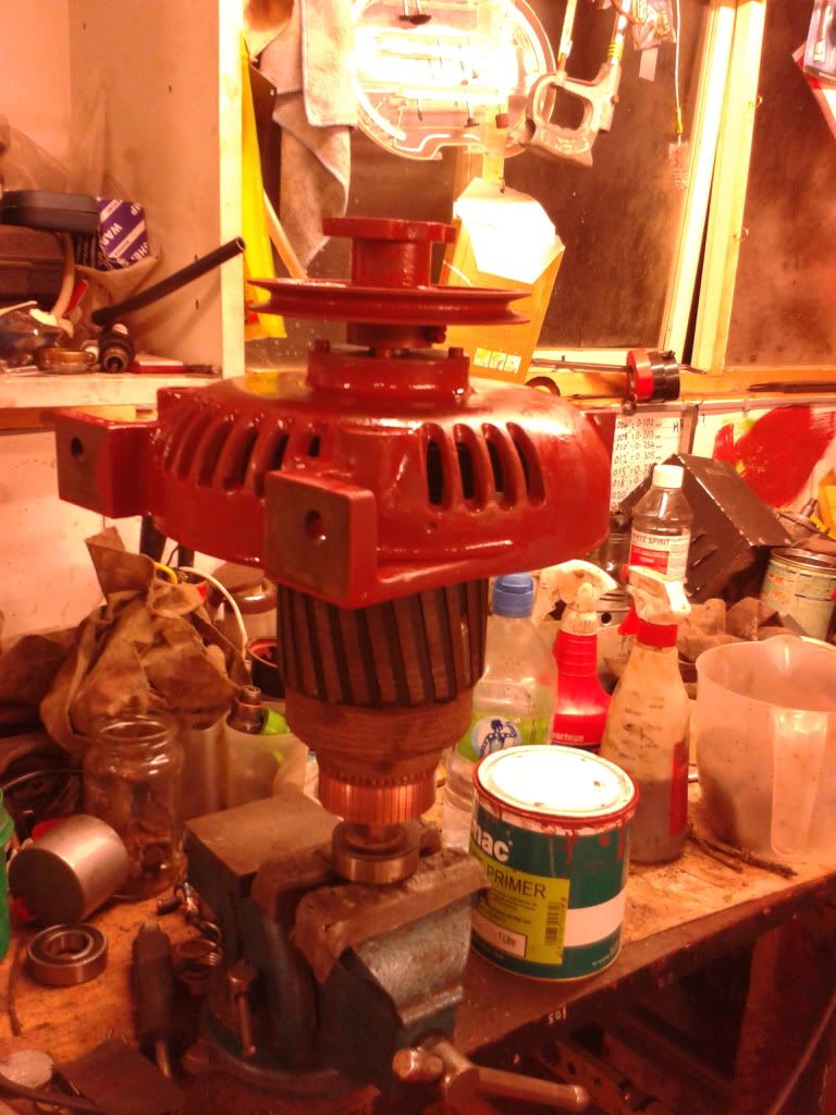

Decided to pull my finger out yesterday & get on with this one, so I've cleaned up the genny parts & managed to re-grease the hidden front end bearing (with the aid of a large syringe & some flexi pipe Shocked )....
I've cracked on with the prep work, got the drill & wire brush attachment out & the primer & paint brushes, here's a few results....
here's a before & after shot of the commutator, I polished it & under-cut the segments....

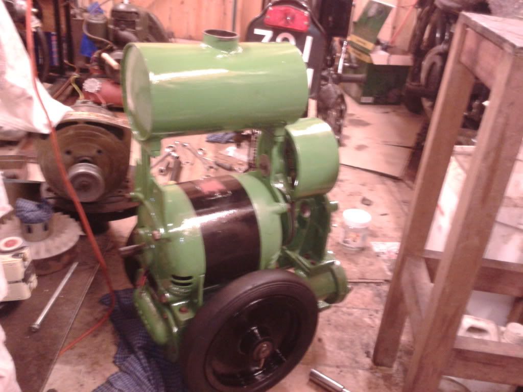

I also put the genny back together, then I thought I'd piece together a few other bits.

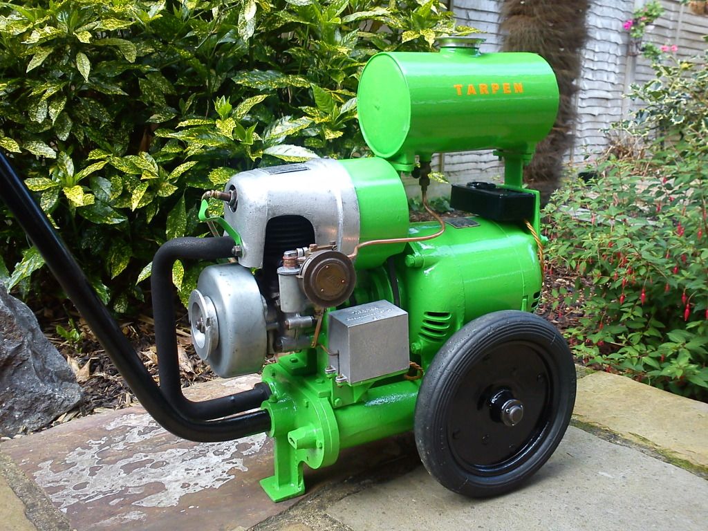

Long story short I ended up with this....
Most of it's only finger tight, as a lot will need to come back apart to finish off the painting.

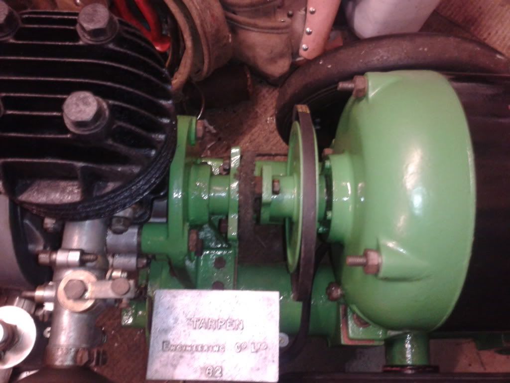

I lined up the engine & genny & put the shaft coupling back together (remembered to put the fan belt on this time Embarassed )....

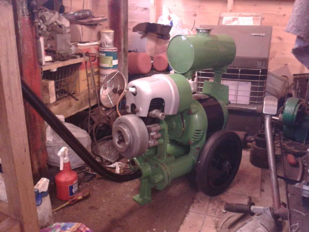

Post by nutgone on Sun Jan 20 2013, 18:17
Aaaaahhhh, that's better....
Yes, that is 2-stroke smoke, Smile
Yes, she runs!!! Very Happy
Much happier now. I've taken a few bits back off now, to clean the petrol, oil & grease off for final coat of paint when it warms up a bit (or when I can get the workshop a bit warmer for a bit longer).
One thing I did notice, it was quieter than the other 2. I have got my original Tarpen engine back from Ian's garage & taken it apart, that one also has a cast iron piston with the wide rings. But, looking back over the "Tarpen 2" resto thread, that one definitely has an aluminium piston. Maybe this one is quieter because the rings are such a good fit in the piston (I've learned recently that piston rings are responsible for a lot of engine noise, especially in air cooled engines). Maybe some are just quieter than others, but this one seems quieter, without it's silencer insert, than my one does with it's silencer.
Mind you, IMO, mechanically this one's in better nick than either my other one or the one I just sold. the bushes & bearings are all in better condition as are the genny windings. I'm still not keeping it though, so someone will get a very good one when it goes.
