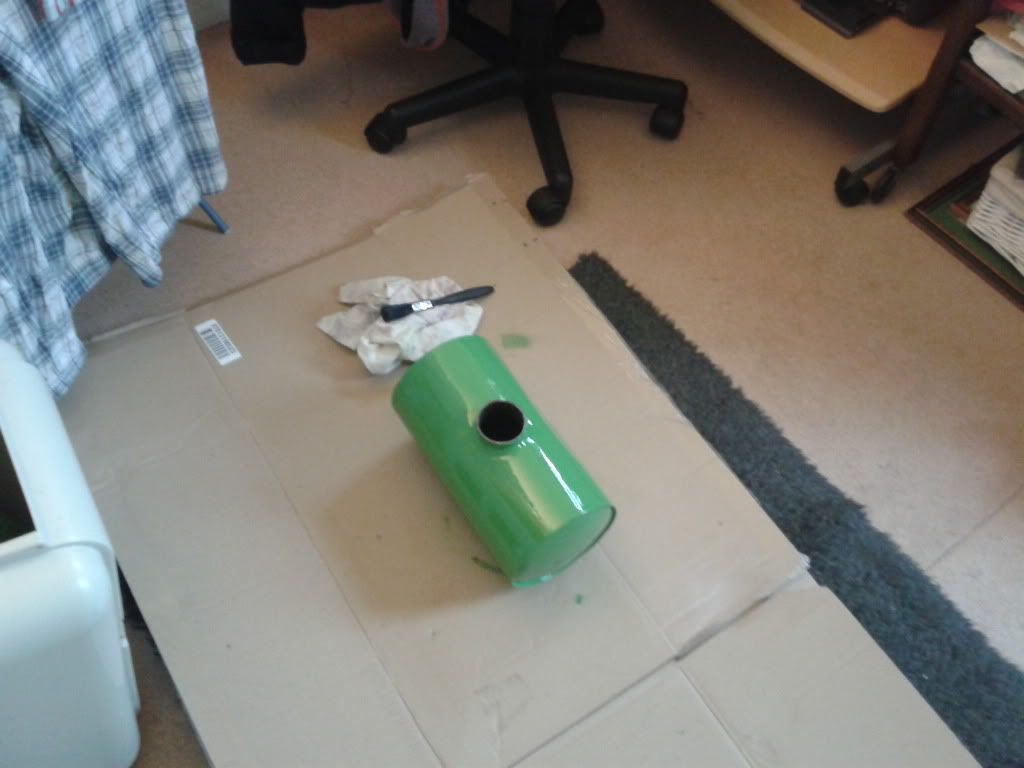

So, in order to move things on, I have moved things indoors. Yes, that's right, I've "manned up", "grown a pair" whatever you call it. I put some cardboard down & bought the fuel tank in to give it it's final coat of paint....
This had to happen as the tank is the most important bit right now, the paint needs to dry, & needs to look good, before I can apply the new transfers & go over it with some petrol proof lacquer. It's too cold to paint outside & I wasn't going to heat the workshop just to paint a tank!

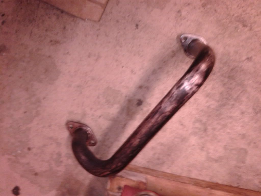

I also attacked the exhaust pipe the other day with the dremmel tool & a small hard grinding stone. I have ground the whole thing, from end to end, so where the plating remains it has been keyed, & where there were any rust bubbles it has come off to expose the steel underneath. I then followed that with a coat of Kurust....
I will complete it with a coat of high temp black (I bought a new tin the other day, but had to get BBQ paint this time, as the shop was out of the normal High Temp one. It's still Plasti-Kote though, a trusted brand). But this paint needs to be baked on within 8 hours of applying, so I'll do that nearer the time.

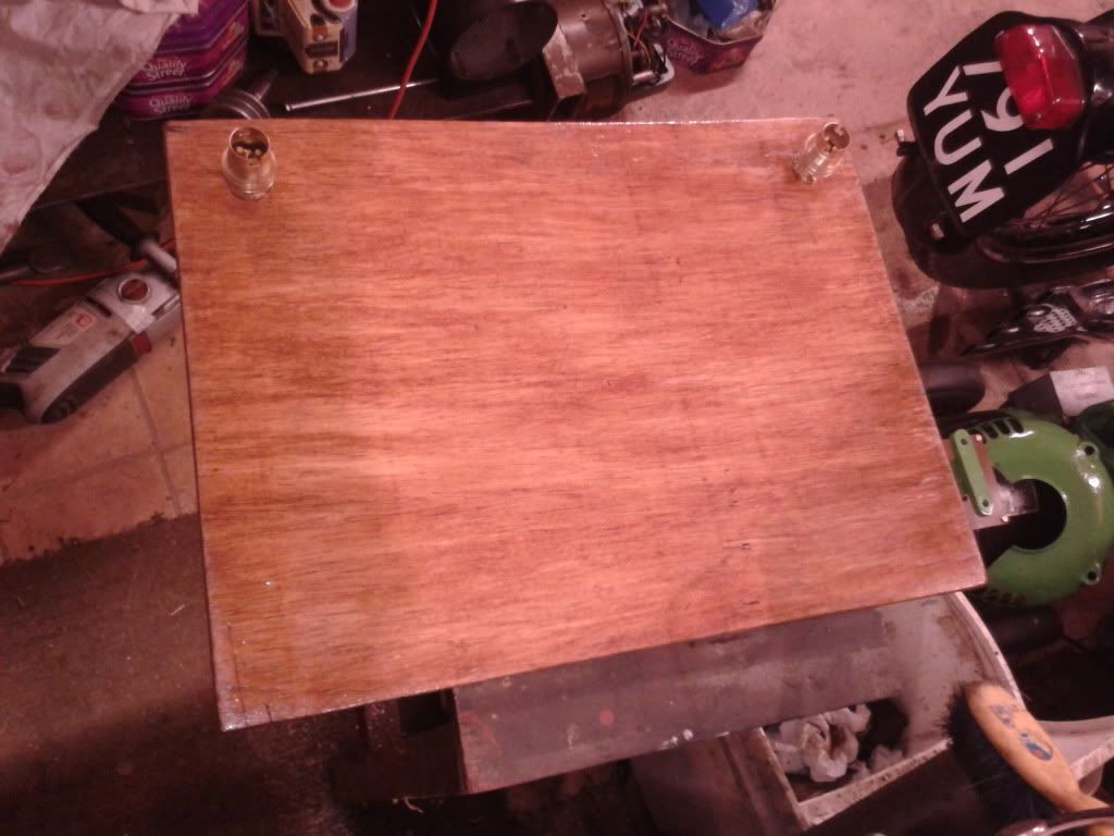

Tonight I cleaned up my lighting board & gave it a coat of varnish. I will get some 110v light bulbs & sell it with this engine (I will make myself another one when I get some money & when I need one, I haven't got the time or money to make one right now). I will give it a 2nd coat of varnish tomorrow evening....

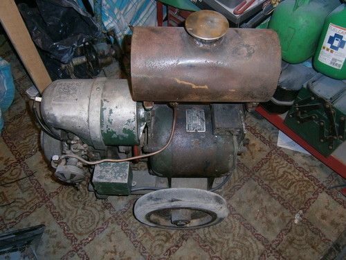

Not bad, but I wish I'd taken some time to remove the dent from the fuel tank. Trouble is bodywork isn't really my forté. here's a couple of before shots....
