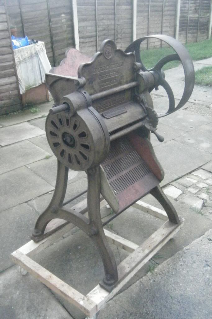

Hi, we have an old antique forage chopper and are currently thinking of ways to attach it to an electric motor or an engine. it is similar to this one (will take owns pics shortly)
i would ideally like to work it from a v belt pulley or similar. Does anyone have any helpful ideas?

I can't be 100% sure without seeing your own pictures but you may have trouble finding something slow enough to run this as a lot of engines will be too fast. More pictures from different angles would make things easier.

by the looks of it it is a hand driven one ... as the pulley looks more like a handwheel , that would of had a wooden handle on it to turn by hand . I have seem machinery similar to this with handle taken off to take a flat belt . Or you could try and find a pulley alot smaller for a flat belt ???
I have a bamford oil cake breaker and the pulley is alot smaller but i will be using my fairbanks which is a slow running engine anyway
something like this would be better .

yes it has a handle. more or less the same as this

I'm not a big fan of converting hand wind machines to run off engines or motors, many people do it with old pillar drills. These machines were never designed to be run from things as powerful as engines, often the gears aren't up to it & I think if any accidents were ever to happen liability would come under serious question, especially as you lose a certain element of control. When you're hand winding something you can stop as soon as something goes wrong, with an engine or a motor powering it you first need to spot something's gone wrong, then you need to do something about it.
However, it is possible, but you will need a very small pulley on your engine & a very big pulley on the machine to slow things down properly. It could take a fair bit of trial & error to set up correctly.
Some old machines were set up for both hand or engine operation.

To be fair, I would have no issues driving it via an engine, in fact it would be safer, as with the handle gone you could easily fit a heavy mesh guard with some kind of staggered outlet or simply let gravity do its job.
Although the one in the first post and the one in the video are 2 completely different machines, the cutters are enclosed in the picture and the handle is cast into the drive gear, the large pulley is no more than a flywheel to aid cutting by providing momentum.

There's plenty of small engines, Villiers/ BSA's about with built in reductions so that might slow the engine output then you need to sort out a pully. Can't see to good in your pic how the handles attached and what the shaft size is or even if a pulley could be found to fit or you'd need something machined to fit.
