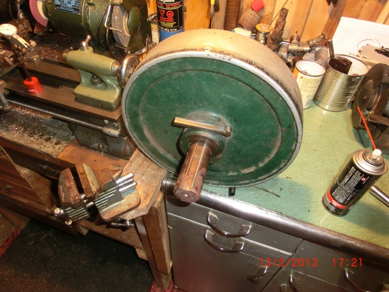

Working on turning up a Gib key removal tool, but doing it on a very small lathe, so it will take a bit more time today and if I am lucky, it will get the job done today also.
John.

I did'nt get anywhere with the Gib key tool I attempted to make, as the OD is too small and the bolts that would push to react against the flywheel boss would have their heads interfere with the width of the shaft.
It can still serve and do the job with allan screws, but it is on the back burner for now as my good friend the machinist came to have a look and said for me to go to the shop tomorrow and make a proper one and be done with it.
He has a 3" lump of round, and he has a shaper that will do the key clearance cut in a jiffy.
He also has a few pullers similar to the one I have so he may well have the solution laying right on the work bench!
A friend in need is a friend indeed and I will see what's up tomorrow.

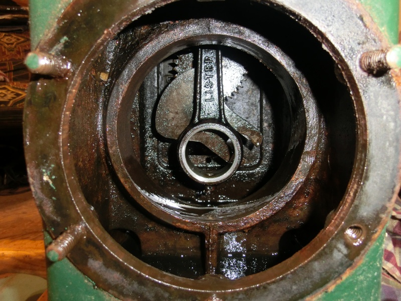

In the mean time I could not hold my anxiety anymore bounce and took the main shaft assembly out and had a look.
Lo and behold, bits of rust on the inside crank case? Hmmmm Suspect Not really but it does look messy Laughing
Rust on the lower skirt of the barrel/cylinder? Arrrrggghhhh!!! NO SPLASH SPIKE!!!! affraid
How long since it went for a dive?, I thought the bearing assy looked a bit dry and the spike is nowhere to be found, it is not in the bottom!
The split pin that holds the spike in is in place so I will remove it to see if the butt of the spike is in the hole.
If not, then it must have been removed and thus not splashing oil and wear the bearings.
Makes sense.
How much wear and tear since? (Don't know Jack!)
Damage anywhere? (Not that I can see.)
Will she live?? Sad (Of course, don't be silly!)
Here are some pics to show you what I mean, but I am not worried too much, as this type of setup can probably handle the abuse better than I think.
The gears look funny and the stuff on them makes it look like a lot of wear but it's not, they're fine so I will assume that the rest of it is too.
Here goes,
You can see the spike is missing, and it is probably in the murky leftovers at the bottom. (it wasn't)
In retrospect, everything looks pretty clean after all, and my worries were only the same reaction one gets when someone hits your car with a sledge hammer and then realising it's his!
Good, one more and that's it then.
Cleaner then I thought it would be, the last and maybe only rebuild was done some 30 years ago I think the man said, so if this is what it looks like with about four years or so since it ran (without a spike? No ), I think I did well for a first time engine, and it should'nt give me too bad of a time.
Cheers, John.

John, looks like you are winning and things are moving apart. Sure once it's cleaned out of all the muck it'll look great. How did the water get down there, through the rockers ?.
I am amaazed with mine nothing got down there, considering it looks to have have been left exposed.

You sure made some progress John and glad it's not all bad news when you have it stripped.

I just had to give the Gib key one more shot before taking it to my friends shop for butchering.
It took a few good blows and it came loose.
I had always thought that hammers, wedges and levers were invented because they work, and I am happy to say that they did just that.
I applied a bit of heat to the hub with a propane torch, merely just to have the flywheel work a bit, but it didn't even scorch the paint, I then put one of the chrome moly spacers (think of a post drill drift wedge) in between the boss and the gib key head and hammered that into place.
Then I clamped the drift down with a "C" clamp so it wouldn't become a projectile when angered, and I gave it a few good blows with the bigger Machinist's hammer, and thought I felt it give.
A few more tries and Voila.., it had moved a mil or so ( In faith I had marked the shaft against movement of the key.)
It was harder to slide the rest of it out and that alone took 15 minutes, but it's done!
Cleaned her up, and papered the shaft, beauty!
Here is a pic of it cleaned off,
As if you all have never seen this before lol, but hey.., I'm a happy camper!

Anyway, I did get back at it in a rare spurt of impatience and lobbed off its head! affraid
It came along without complaining and made it easy for me, it's full off debris from sitting I suppose, sawdust, critter hair, bug parts and a few pieces of tree.
No nuts or any other food.
No spike parts either, but upon taking the remnant spike part out of the big end mounting hole, I found a piece of drilled ready rod. (threaded 3/16th el cheapo stuff.)
It broke where it was drilled and showed wear in such a way that I believe it was loose in the first place and slowly beat itself silly over time and finally gave up the ghost. Neutral Some mothers do 'ave em! I can't figure how someone would take a chance to ruin a good engine with crap for a fix!
The hole is ok, and I'll make up a new splasher that fits properly and hope I do it right. In any case I will always double and triple check my work, it's the only way you get to see progress untill things tick like a clock.
Now that I have had a boo and saw what's up inside the cylinder I am truly happy, it is as clean as can be other than the carbon.
The piston is the raised head type and I thought I understood that for the year that was not an option, but the rings are very good and loose, and they're the big ones, also the way it came I believe, every thing in the cylinder group looks wonderfully well and proper.
It also does have the deep recessed chamber and the shrouded intake valve so that seems correct.
The push rods are straight but have a small bit of damage. On the exhaust one there is metal to metal damage like a small crease, most likely from eating spike parts.
After dressing that up it should be serviceable again.

Oh, The water jacket weld repair looks to be watertight and solid, it is a crack right under the cylinder deck on the flywheel side, and the repair consists of a fish plate welded over the initial weld on the crack. A good repair I think, but ungainly.
In the future I will probably remove that plate and repair it properly with lots of heat relief, so I can have a better looking or maybe unnoticeable fix.
But I want to have it running first, I can see the light at the end of the tunnel Laughing I want to HEAR it!
All in all I think things look peachy, I think I bought a beauty and I am having the time of my life.
