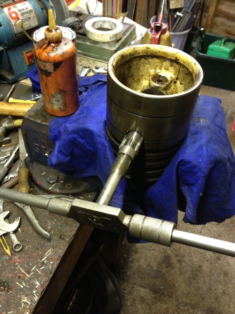

Exhaust pipe being rethreaded.

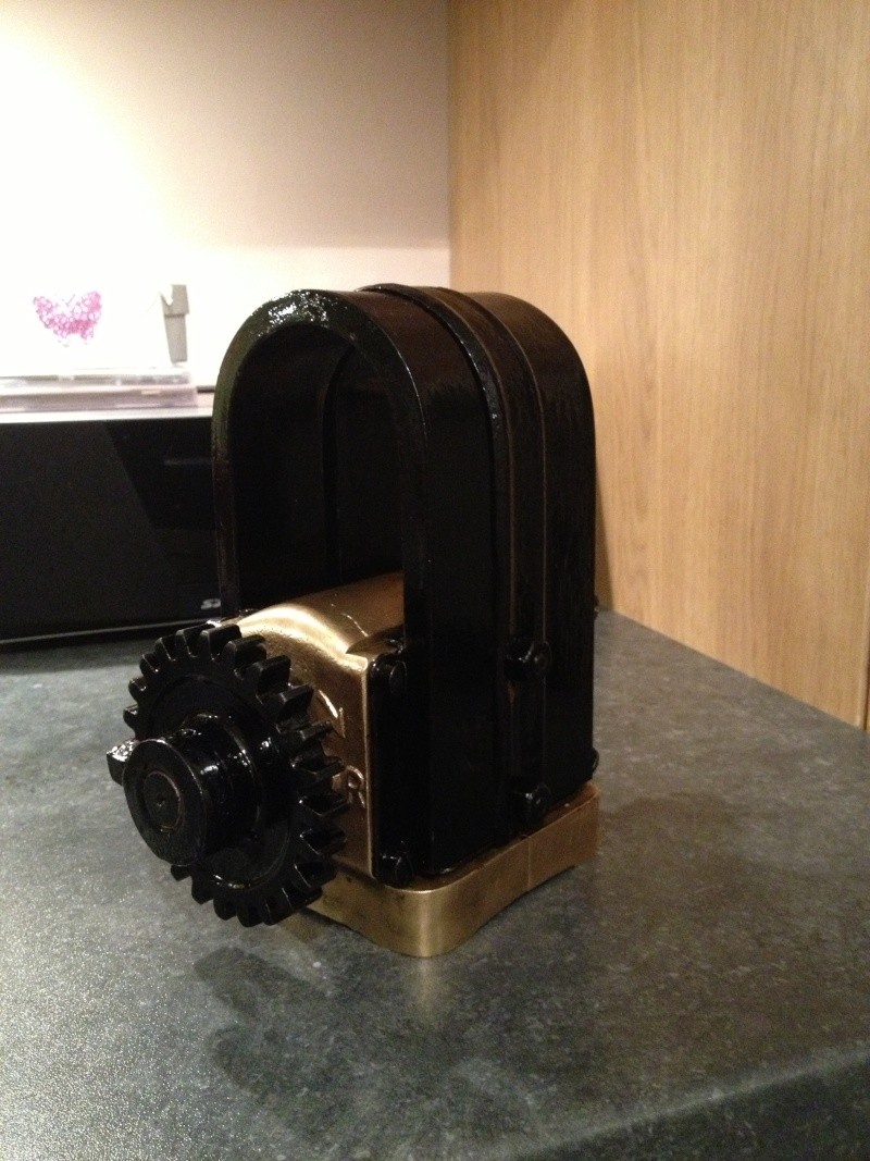

Rebuilt Magneto
