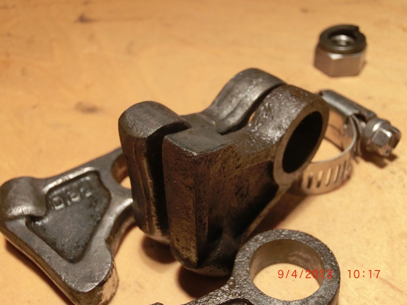

Ok,
Pics as promised, I locked the splash pin in by using a piece of drill rod, and then I squashed the ends together causing the pin to fatten inside the hole, so the result is a tight fit with the ends peened as a secondary safety, I much prefer that over a split pin, as they are made of weaker unknown material and as far as I am concerned they always seem to break or crumble when you dont want them to
It's just wrong to use one in a place where everything is trying to self destruct or destroy everything else!
I also took a burr to the oil holes in the rod's bearings (I do it in the racing engines so why not here?) to increase the amount of oil present within the bearing surface, and I believe that it helps to disperse the oil better at the same time as well, I need to finish them with a polishing compound and a small cotton wheel to make sure there's no snags anywhere. (It's bronze so I should be ok anyway.)
Then I took the old and the spare cam followers and compared the condition of them. You need to know that these "better" ones are like new as compared, those bits were kindly sent to me by Pete as he just had them laying about, they are like new to me as you can see in the pics and they are not too far off from new anyway, as they only have marginal wear on them.
The old ones are worn so bad that they can't be used period as they will slop around on the bearing pin they ride on and will eventually destroy it.
Note the rounded follower lobes on the replacement followers as compared to the totally worn flat ones on the old ones
The bits inside of the governor elsewhere in this thread are also very badly worn and will require replacement or a lot of work to bring them back. If I have to I can turn up some of it on the lathe, but the weights will most likely have to be replaced if I can find them.
Nothing says I can't improvise, but I don't want to go that direction as it is only more work and takes away from the original.
Finally; the gaskets that came in the kit from Stationary are good, except the paper ones :stick lol: , I'll use them for templates to cut my own
Well at least I can now start with the assembly of the bottom I was going to do yesterday, but I just couldn't get it started as I have another flu (how many of them can a man have in 3 months??) and the pickup truck needs work on the fuel system still and the brakes done.

Hi all,
Well, I've been home one day and did some work on a genny head I picked up, then I got in the mood to do a bit more of assembly and general cleaning up of bits and bobs for the Lister "D", while waiting on bits to assemble the Gov. section, and then the rest of the "D".
Hah! got a call from work
I thought I was going to have a few days to work myself in tight with the generator and the "D", but just one phone call nixed that idea!
I have to go out again tonight or at best tomorrow morning, so I'm hoping that the load will be delayed a day. (which it could If I say three hundred hail Marys!.., I'm not even Catholic, but prayer seems to work. )
Sofar I've had the crank and bearings back together and it bolted on for posterity or just plain lack of anything else I could do to the engine, other than some valve work which I need new valves for, which are next to order when the paycheck arrives. (may as well do a proper renewal of that system too while everything else is being re-done anyway.., keep things on an even keel?)
This engine is never going to be able to get sold for the cost of restoring it! Just as well anyway, as that'll keep me from selling it plus I'll have a dowry to give for my daughter If she'll ever marry! (last one!):angel1:
I took the shaft assy off again and made yet another new gasket for the housing, I don't believe in re-using paper ones if I can help it (some times you need to though,) plus it keeps a template for cutting new ones handy.
Then I took the piston and rod, had another good look at it all, and came up with a handfull of 3/4" "C" clips (free from Fastenall to keep old friendships and services solid,) which are just a bit to big for the grooves in the gudgeon pin holes.
That made my mind go into survival mode and I clipped one end off one of the "C" clips to make it bend beyond where it would touch together (now it only has one hole to latch onto in order to squeeze or pull it,) and installed one to see if that was acceptable and it worked like a charm, a bit more playing needed but it still installs and removes easily.
Now the rod/piston assembly is complete with gudgeon pin installed and the crank shaft can be mounted back in the crank case properly together with the piston assembly.
Next I can trial fit all the timing gear and have that ready for when the governor is ready to be installed and tested.
When I'm done with that, I may have enough time left today to go back to the generator and behead it to remove the old engine timing case, and clean that end up a tad.
I may even get brave and paint it! wow....., I did say that.., (don't get to be too expectant of that last statement, as I want to save all the paint jobs till next year or never! which ever comes last.)
Thought I'd give you all a bit of an update so's you know I'm still alive
Here's to success and time, , John.
