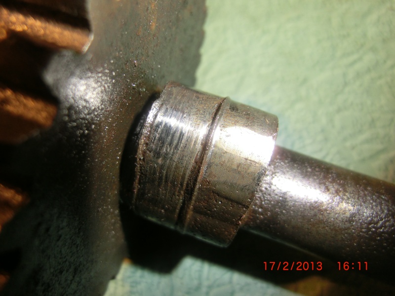

steve w wrote:That worm gear has took a good hammering, you made a great job of the piston.
Steve,
Yes it did and thank you.
The rest isn't any better, there are no bushings that I can find on the dog shaft and it had a regular spike for a dog lock pin, I'll bet it belonged on a farm Laughing I'll have to ream the hole and make a new lock pin for that.
Also the hole that the dog shaft rides in, has a square key like groove the length of the hole, I assume this is for lubrication?
The large gear on the shaft is knackered too and will need replacing.
The lobes (or is it only supposed to be a one piece one that serves two lifters?) are toast as they are totally chewed up and unserviceable.
Is the lifter system operated by one wide lobe for two lifters, or is it two separate heighth lobes on one lump?
I'll have to research that, as I do think both valves lift equal amounts and would require only one lage lobe that way.
I can't tell at this point as the wear is extensive and I can't make out if it is or isn't. Rolling Eyes
The small gear on the spiral shaft is surprisingly good to use with minimal tooth wear. The hole it lives in is worn and has a lot of play and probably will need reaming and a set of bushings made.
The spiral shaft upon removal gave birth affraid to what looks like a worn out piece of stainless shim stock at the gear end or a severely worn hard bushing, and upon checking, the dog shaft also had one like it.

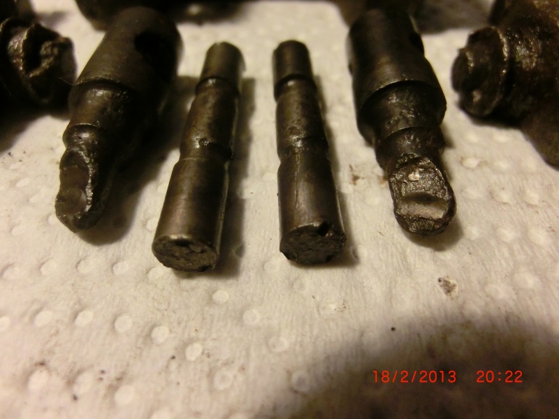

Post by Smitty on Mon Feb 18 2013, 19:24
stationary stu wrote:John if there's anyway I could help with you getting the parts you need just give me a shout and I'd be happy to help you.
Wow now that's seen some work in it's life time and must have been on it's last legs 4 years ago. I know you say about cost of parts etc to get her up and running again, thing is most of us do the same and don't think about the costs till it's finished. There's a few members on here that's spent a lot of money just to get an old engine up and running again, it's a labour of love.
Hi Stu,
I am thankful for your offer to be a friend and to want to help, as others also have here.
This is rather why I chose to be "closer to home" for membership in a forum, as the character of people is different here (Let's say the European Hemisphere is more civil lol.) And there's lots of truth to that I promise!
The engine has certaily seen its share of work I think, but what's worse is that it has been left to run without oil for too long and neglected in maintenance as well, and I realised how much so when I opened up the Governor!!!
Everything is stuck in there and saw equally as much damage. The oil cup that should have fed the innards was a bolt stuck on for some reason, and the balls on the balance pins are flat like knife edges.
The plunger was stuck bad but came out in one piece and I can put some brass on that to reshape the head. I have to turn up new balance pins as they're done. The flyweight retaining pins are so bad that the weights can be wiggled back and forth about a 1/4 inch lol.
And last, the thing was filled with a slush consisting of water and left over oil and rust, with a cake of hard crud in the bottom about a half inch thick, It came out in one piece Shocked .
Needless to say the engine is in a somewhat better situation at present, and will hopefully get a new lease on life in a bit! cheers

The governor pins are usually worn John, they can be drifted out and rotated 180 degrees and refitted. Peen the ends of the pivot to prevent them coming apart though! I have found you an early connecting rod, a camshaft with good teeth and a couple of cam followers, plus a 4 ring piston and gudgeon pin (circlips missing though) if you are interested, can post some pics tomorrow?
Re: First lister D, and first time everything else in old engines.
Post by Smitty on Tue Feb 19 2013, 00:36
Foden wrote:The governor pins are usually worn John, they can be drifted out and rotated 180 degrees and refitted. Peen the ends of the pivot to prevent them coming apart though! I have found you an early connecting rod, a camshaft with good teeth and a couple of cam followers, plus a 4 ring piston and gudgeon pin (circlips missing though) if you are interested, can post some pics tomorrow?
Hi Pete,
Yes please do, I'd be grateful for anything I can use and sofar you're making my day! Very Happy
Also I believe my gov pins are so bad that rotating won't help, but I am in the middle of cleaning things up and I may be wrong, so I will post a few pics after i'm done with that.
Regards, John.

Ok,
Done with the oily mess for now!!! cheers
Crank case is clean, parts are clean and taken apart, wiped and brushed, covers checked for cracks, crank case cleaned out and nothing noteworthy found other than an good repair which was an ice crack most likely, under the top deck of the crank case at the wheel end.
The head is also good but still needs the hopper brushed clean of debris and there's a 1/2 inch bolt in there loose where I could just see it round the cylinder wall.
The governor was taken apart, cleaned and laid out for pics.
Here's the scoop on pin and pivot wear.
First the way it was when taken out, Note the springs being inadequate, it must have run slow enough Rolling Eyes.
Note the wear (and lots of pitting) on the governor pins, they can be re-used but barely. I may touch them up with a bit of weld put on. The pivots are also pretty worn but that's easy.
Surprisingly the holes for the pivots on the weights are not damaged, so all that needs to be done is new ones made from drill rod, case hardened a bit for wear resistance.
Springs can be had locally and a variety at that. I'd like to set it up for running round 5-700 rpm no load.
That winds up the exploratory part of the restoration, and now it's waiting for parts to show up and doing small repairs on parts, on which I will take my time as it's going to be a while for all the parts are here to make it work.
I am not going to repaint as it is not bad at all, but that will be a job for next season for when it has been running a bit and just in case I have nothing better to do Rolling Eyes
Back soon with some repair updates,
Regards, John.
