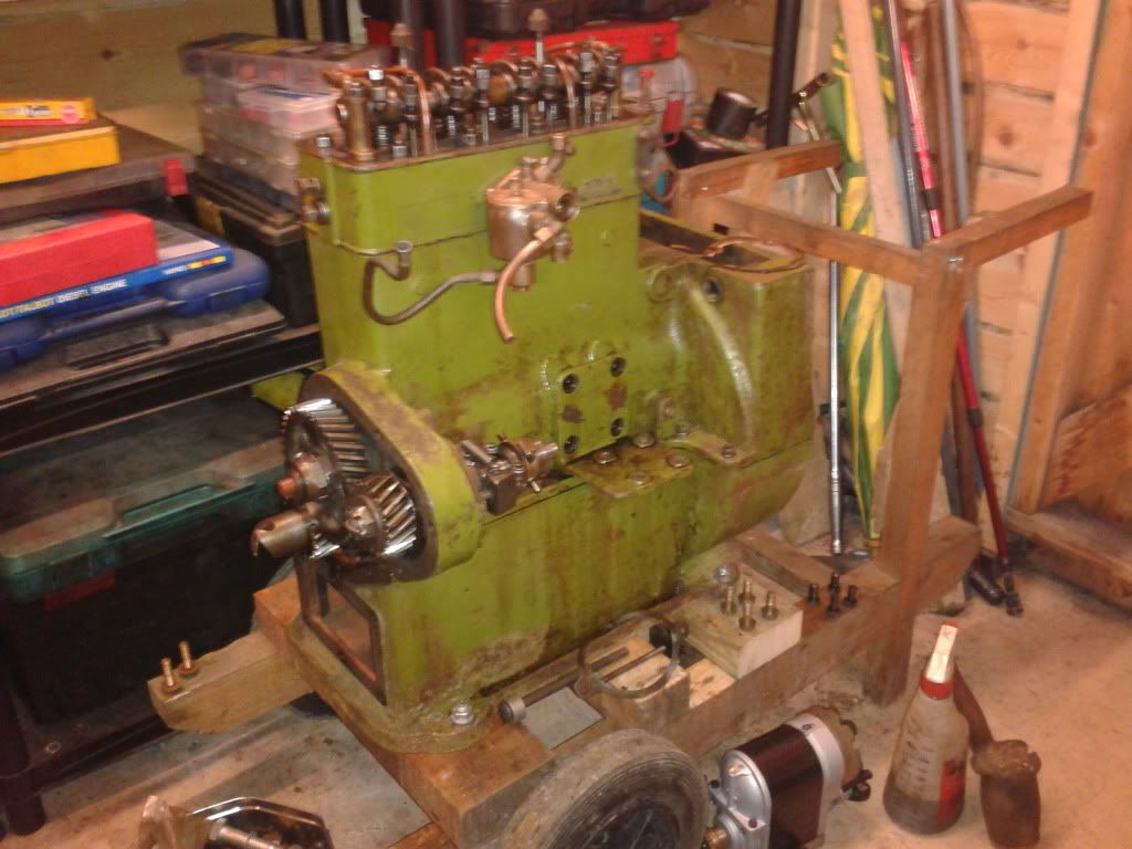

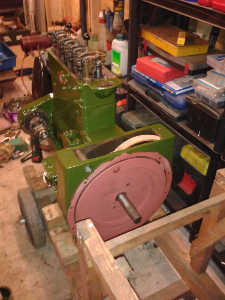

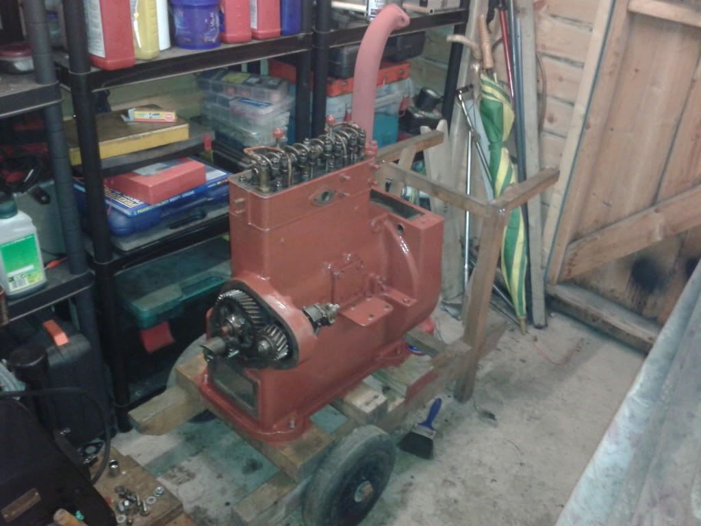

Anyway, look who's been a busy boy this evening....
The only bits left are the sump, crank case & cylinder head....

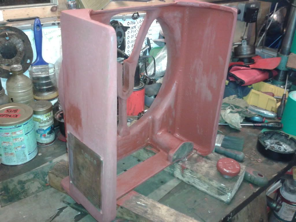

I'm not going too mad. I just gave everything a rub down with some P80 abrasive paper then gave it all a quick coat of thinned down red oxide (I thinned it partly as it's so cold, partly as I prefer the first primer coat to be a "wash coat" & partly because it was getting a bit thick anyway). I will probably give it another primer coat, then let it go off nice & hard (that Teamac primer does go off quite hard) before giving it a quick rub down with a fine abrasive sponge pad, then probably 2 top coats with the Morris Engine Green (possibly with a quick rub down between top coats, but it might not be necessary).
Some of the castings are a bit rough, but I'm happy to let that show through a bit, I don't want to go over the top on this one. I will pick out the cooling fan in red (post office red), & the radiator core, starting handle & possibly some of the governor parts will be black. I might even paint the oil filler cap black & pick out the lettering in red on it, but that might be a bit OTT, not sure yet (I never was too good at picking out lettering anyway).
I can't seem to get the magneto shelf off the side of the block. It has 4 screws, which I have removed, but there also appears to be 2 brass pins holding it on & it refuses to budge. I don't want to risk breaking it, so I might just have to leave that on & work round it.

As far as trolley design goes, my plan is to make a slightly lower trolley to mount this engine on. I will be using modern industrial caster wheels on it, but I will be covering them up with a mock-up of a permanent concrete engine bed, as I believe these engines would have originally been mounted in permanent situations, like in a plant room or engine shed.
It means I can make a simple flat bed trolley, then make up some boards to go on the sides (covering the ugly modern wheels) with either a concrete effect from something like papier-máché or flexible floor screed, or with real tiles on them (perhaps a black & white check tile pattern made from simple square wall tiles).
I have an idea in my head, & hope to be able to make it into a reality without too much expense. Any ideas on how I could achieve this are welcome.

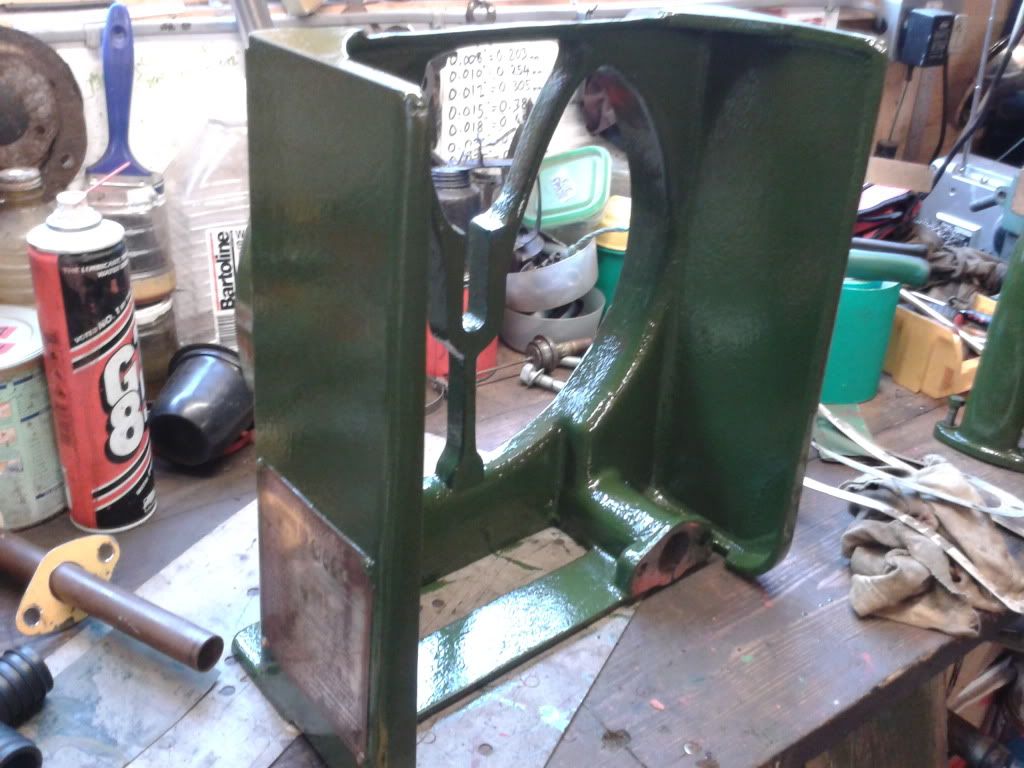

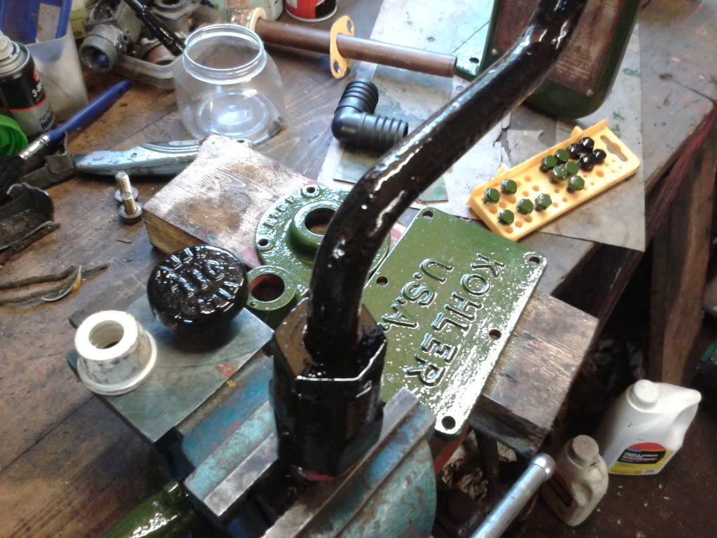

Well I gave the red-oxide primed parts a quick rub down with an abrasive sponge pad & gave them a 2nd coat. I have also started to sand down the main engine block, sump & head all as one bit (I've done one side, just come in for dinner, will turn it round later, sand the other side & see if I can get a coat of primer on it, then I can 2nd coat that tomorrow ready for the paint to arrive in a day or two).
Also, remember these....

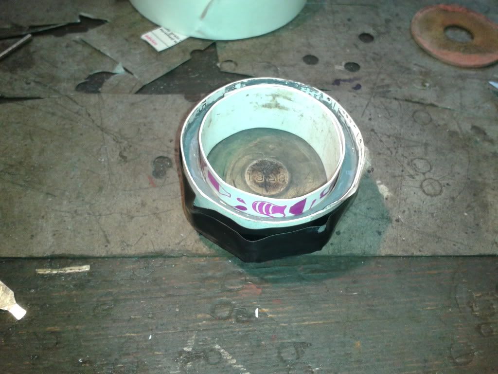

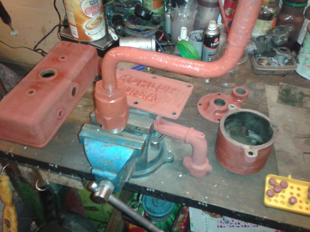

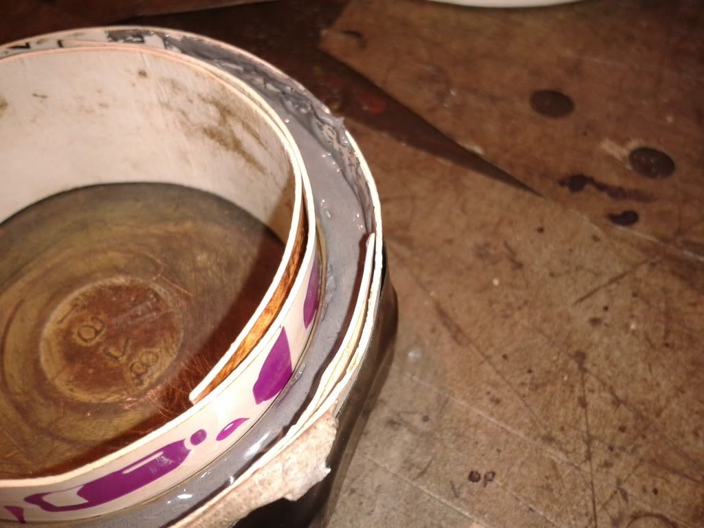

Well it seems someone has been telling porkies on their eBay listings. These are supposed to be 32mm diameter, when in actual fact they are 35mm, so they don't fit!
Well, I'm buggered if I'm posting the damn things back, so out came the sharpest Stanley knife & I got on with re-shaping them (don't worry, I also had some silicone instant gasket arrive today as well, which will help to seal these).
I have shaped them with the knife & gone over them with a rasp & some P80 sand paper & they now go into the holes in the engine block & bottom of the rad quite nicely (in fact I expect they will seal without the silicone, but I will use it anyway, as there's no way I will ever use it for a gasket, can't stand the stuff really, but it is good for sealing against water).
These bungs take copper 22m pipe as a nice tight fit in the internal holes, which I have plenty of. So I will make up a 22m copper bottom pipe, with a drain tap in it at the lowest point (instead of an elbow coming out of the block I will use a reducing T & put a normal central heating type drain valve in there). Once covered in plenty of paint it shouldn't look too bad. I might even make up some metal plates to go over the bungs, shaped like flanges they can use the threaded holes/studs already there & will not only hold the bungs in place, but will serve to hide them as well. (I doubt this side will be on show anyway, but I want it to look reasonable at the very least).

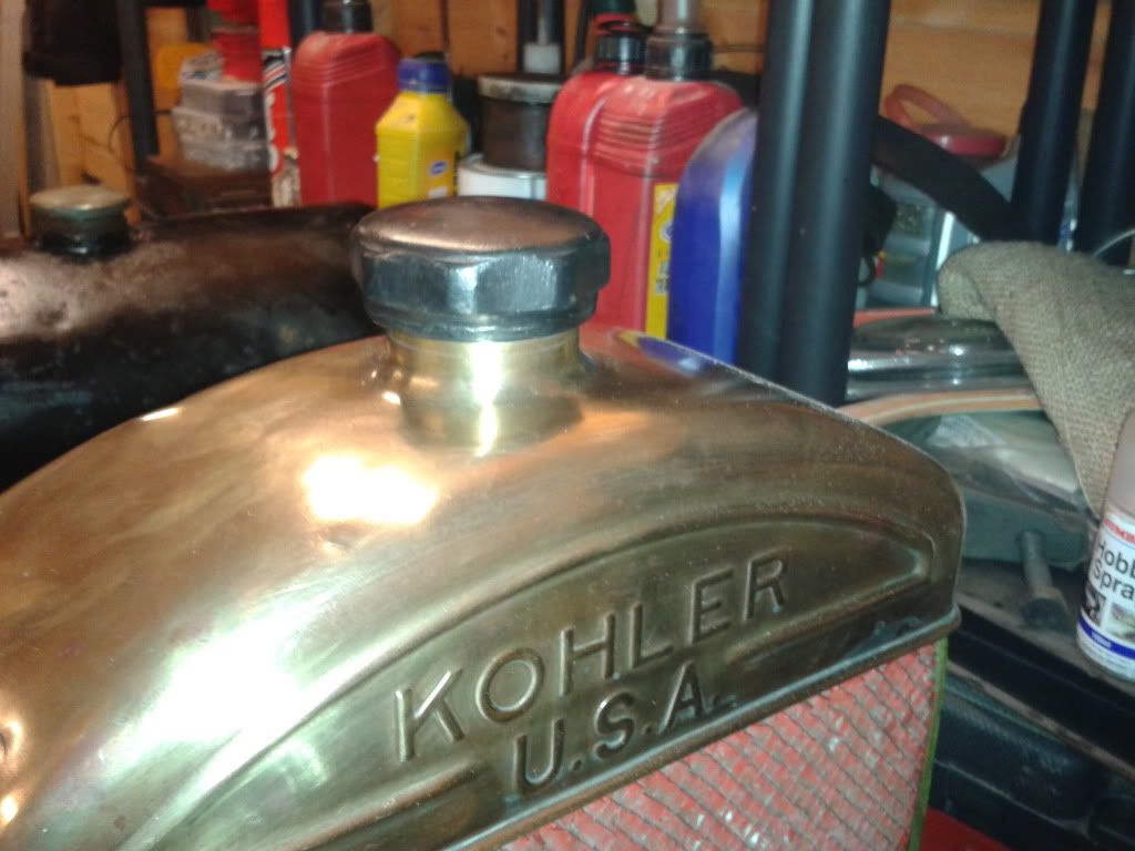

Detail is one of those things I have time for. Take this for example....
Can you guess what it is yet??? (best Rolf Harris voice for that one Laughing )....
No??? Here it is after I finished what I was doing with it.
That's the original radiator cap. It's made from Bakelite with a brass insert. The Bakelite had gone brittle around the very edge & had started to crumble away. There was also a chunk out of it on top, where the indents are for the finger tightening.
I broke all the loose stuff off & got back to a sound base. The brass insert was coming loose as well, so I have built up the missing Bakelite in several layers with J.B. Weld (2 part epoxy metal glue). It's taken a few layers, & for the final layer I made the card inserts you see above.
Once the glue had gone off hard I sanded it back to shape & gave the whole thing a coat of black fire grate polish.
The devil's in the detail. Very Happy

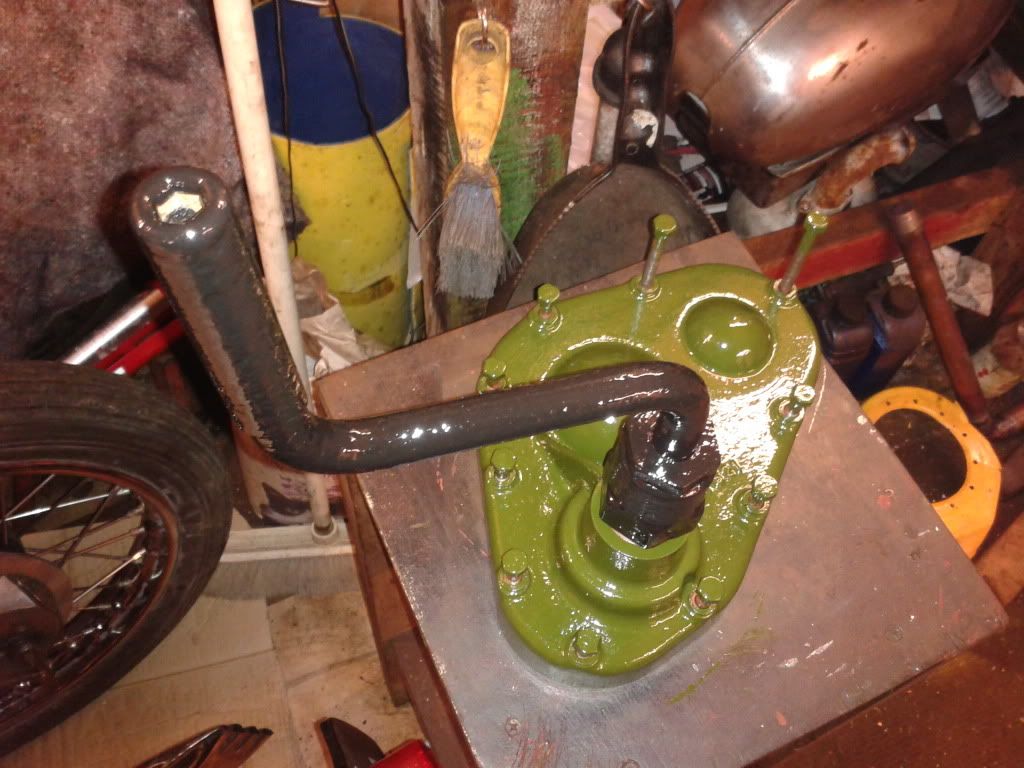

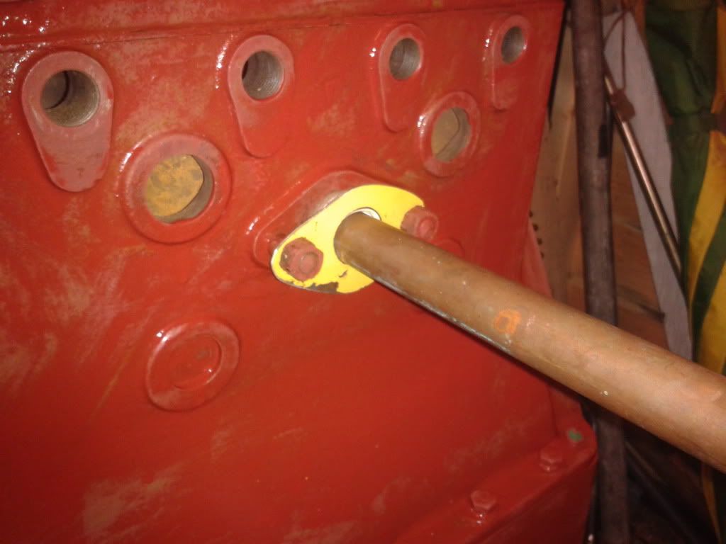

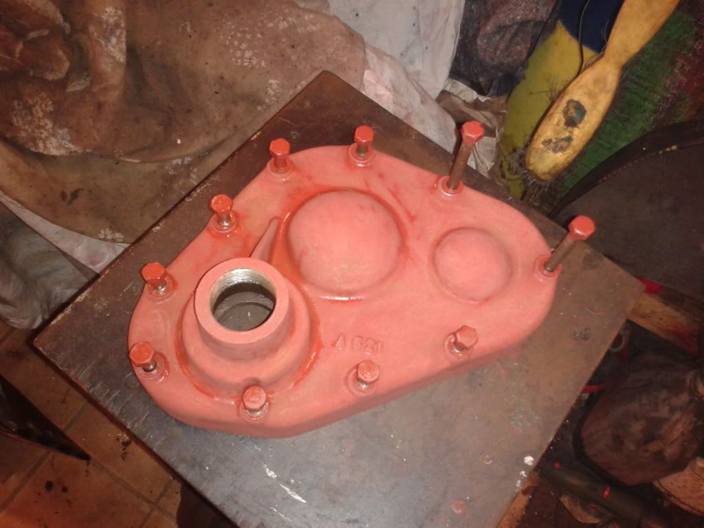

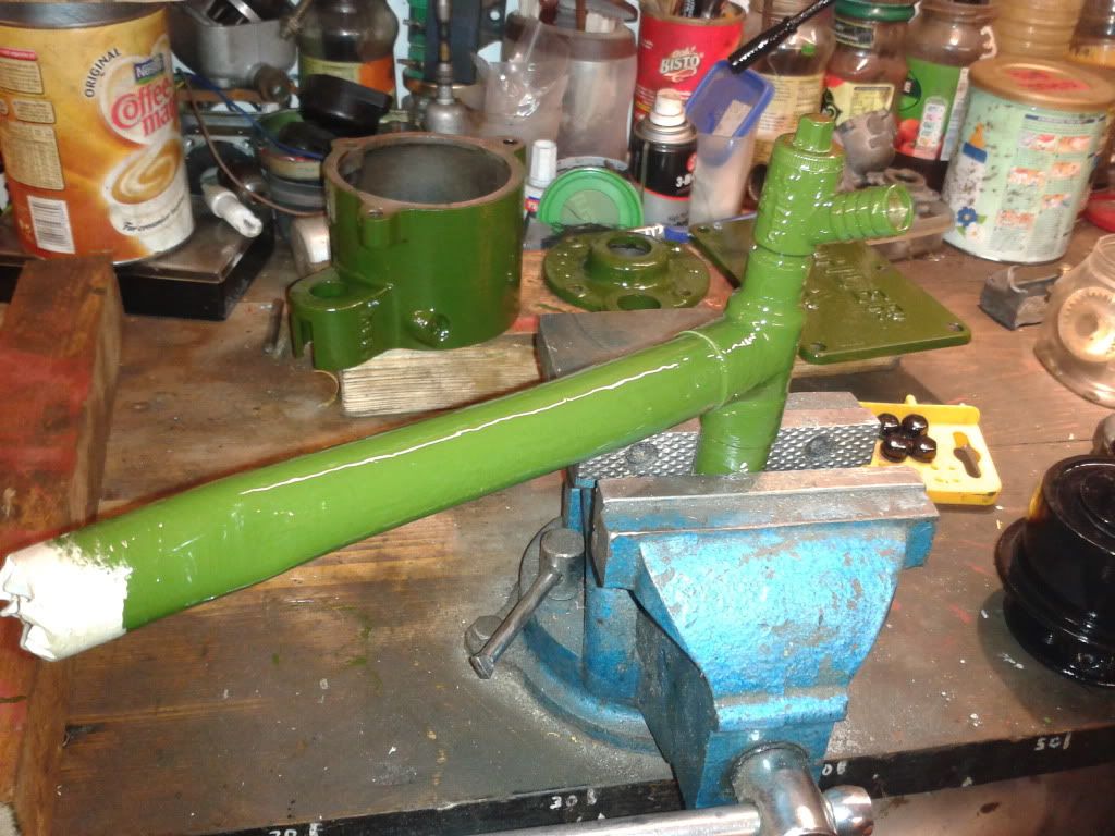

Been busy again this evening. I managed to prep & prime the main engine. But during my prep work I found the 2 core plugs which back onto the water jacket had rusted through (probably better that I find out now)....
So I pulled them out after checking the manual/parts list & finding out they were 1" cup type plugs & ordering 2 new ones from eBay.
Anyway, on with the priming....
I also gave the flywheel a coat of Kurust, as there was no paint on it. I will go over that with red oxide primer when it's dry....

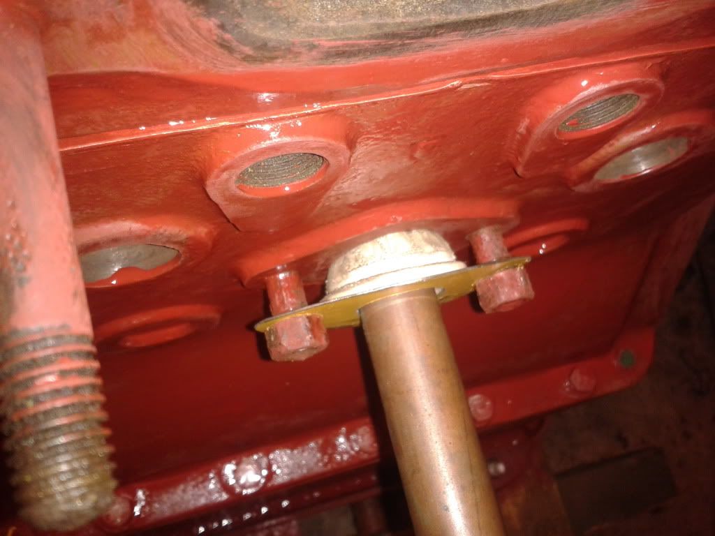

Now, here's one of those plumbing bungs I've hacked about....
I got some old plate steel & cut myself a flange shaped piece, then put it together how I want it to go....
I think, with plenty of the white silicone gasket stuff, & some decent plumbing work (IE: a good pipe run with no strain on the end joints) it should seal fine & work quite well. At least until I can get something more permanent made up.

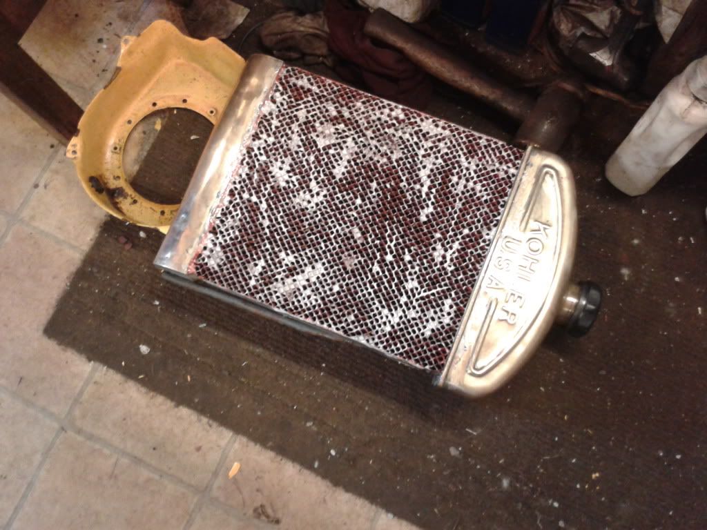

Yep, there's no water pump, it's just a simply thermo-syphon system at atmospheric pressure.
There is an overflow tube soldered into the radiator, the top of which sits inside the top tank, right at the highest point, just under the rad cap, it then goes to outside, just to the right of the rad (left side if you're looking at the fan) & vents near the flywheel. so there's no pressure in the system.
My plan B piece arrived today....
I was expecting the ribbed bits to be soft, but they are hard brittle plastic, as is the rest of the elbow. It is a good tight fit in the holes, but I think it's too tight & the material is too hard, it could probably crack on assembly & I doubt it would seal as well as the rubber bungs.
Still, I'll hang onto it, it was only a couple of quid & could come in handy for something else.
Also, in the post today, came my paint (that was quick, it was only dispatched yesterday afternoon). So I've put a 1st coat on the parts which already have 2 coats of primer. I gave them a quick rub down first but there are still primer brush strokes showing through in places. I'm not too bothered though, it'll look nice in fresh paint & I don't want to go too overboard with this one. Obviously it wants to look good, but not over-done.
I'm told the radiator tanks would have been painted originally. & I know shiny brass won't dissipate heat as well as a dark colour, but it's hardly likely to be worked hard & I don't think over heating will be an issue in the great British climate.
I want to re-paint the radiator core black though, I have some high temp spray black, but I think I should get rid of some of the red that's on there first. I have got some paint stripper, but not sure weather I should use it? It's the modern eco-friendly stuff that takes days to work. Maybe I should do it then get Ian to put his pressure washer through it to clear it out, so I can get as much air flow as possible once it's up & running.

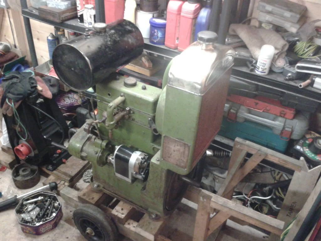

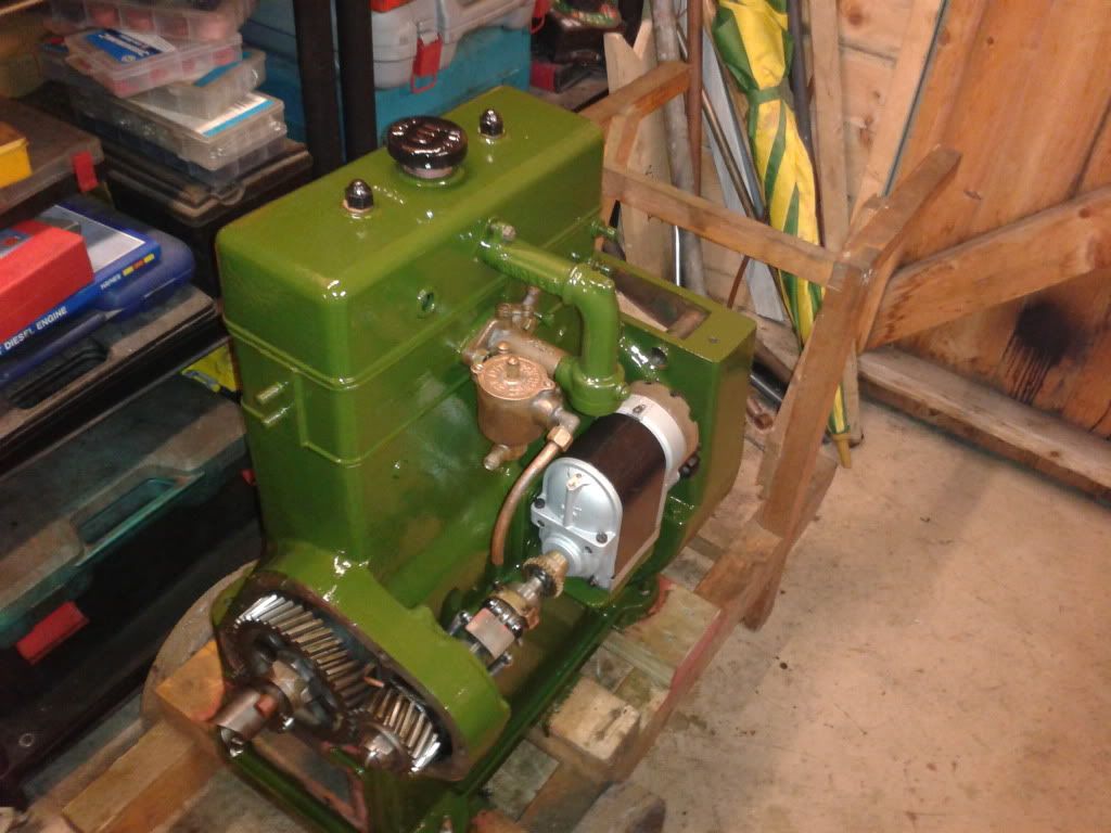

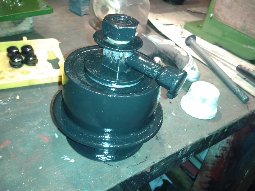

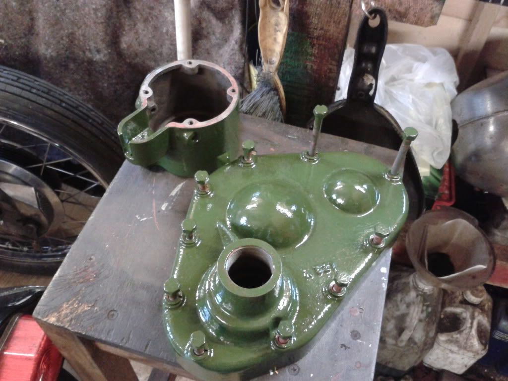

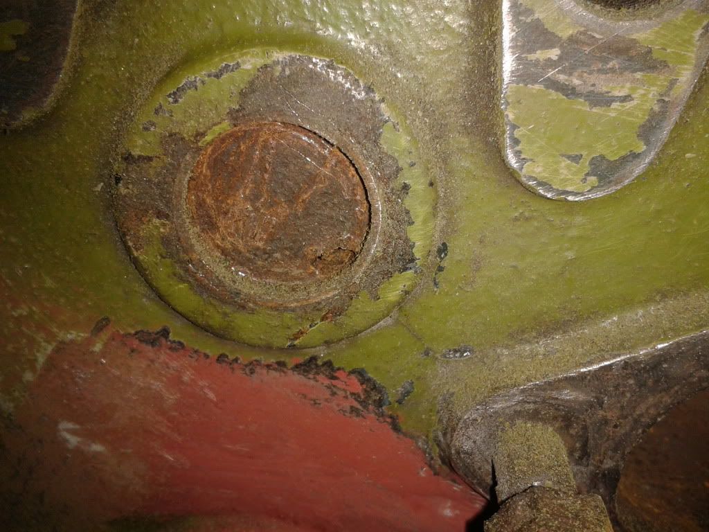

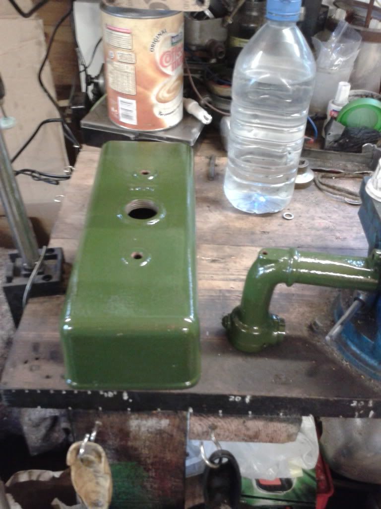

The paint arrived so I got on with it, painting some bits in the new green (which I think is a tad darker than I wanted, but I give up on paint colours!)....
& some parts were painted black....
I've been priming & painting the bolts as I go....
I know Andrew said not to paint the nuts & bolts, but I'm not quite sure what was meant by that. If it means not to pick them out in a different colour, then I agree (on the most part), but I don't like to see them not painted at all, especially when they've been painted before, as they have here. Anyway, it'll look good when it's done.

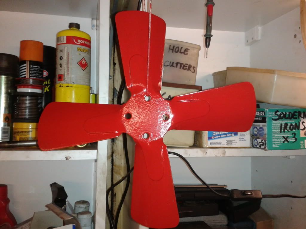

I also gave the fan a coat of red gloss, but that particular paint was very thick, due to the cold weather (the engine paint was really thin, even though it is cold at the moment). I thinned the black in a pan of boiled water before using it, I will do the same with the red for the fan on the 2nd coat, as it didn't go on well at all.
I also picked out the governor rods in black, as well as the parts you can see in the photo (oil cap & handle).

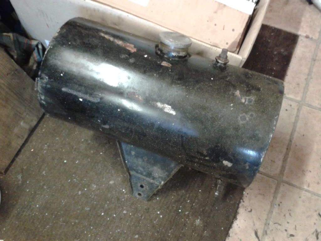

Now I just need to think about a fuel tank. I have this one....
But I don't like it much. It's bloody huge! & it doesn't look right bolted to the end of the cylinder head....
Also the bracket is very wobbly & would need something else making up to steady the tank. What I really want is a low tank & the vacuum fuel pump system for this engine, but I doubt I will get one of those in a hurry (I stupidly missed the last one on eBay, god knows when another will turn up). I could go for an electric fuel pump, but they are expensive to buy (well, they can be, as I would need a very low pressure type) then I would need to think about a battery to run the damn thing (I suppose a solar panel would keep it charged, they don't use much power).
I dunno. I can use that massive tank to get her running, maybe think about something else later on. Maybe if I'm going for a mock-up of a concrete base in an engine shed I should have a wall mounted tank & make up a back board for the exhibit???

Oh I expect this thing would've had an even bigger tank originally, although I believe gravity feed tanks were an option from the factory, I'm not sure they were ever mounted directly to the engine.
The tank I've got just doesn't look right IMO, & there's no way the bracket would stand up if it was full to the brim. Shocked
It's got a permanent filter inside the filler as well, which looks like it's been soldered in, so I can't have a look inside or clean it out properly. There is a plugged hole in the top though, directly above the outlet tap. So I managed to shine a torch in there & look inside. It looked very clean & shiny in there, but that was only one small part of a very big tank that I could actually see.

I've been doing a bit of plumbing work today, got my bottom pipe done & even got a coat of primer & paint on it....
I've also given all the newly painted green parts their 2nd & final top coat, as well as the black bits & the fan....
I also couldn't resist giving the engine it's first coat (although I probably should've waited another day)....
Then I thought I would carefully place the rocker box cover, carb & magneto, just to get a feel for whet they look like....
I've also painted the cooling fan hub black, which should look good against the green surround & red fan....
Now I'm playing about with the exhaust. I've discovered 35mm pipe will fit, & I can get fittings & clamps to fit that. I'm using 35mm copper at the moment, & will have to try & get it together without soldering, as I've had solder melt on engine exhausts before. I will be getting a tractor style flap for the top & will need to make up some sort of condensation trap for the bottom of the system.
Hopefully my new core plugs will turn up tomorrow, so I can get those fitted. I gave the radiator core a good coat of paint stripper yesterday....
This morning I gave it a gentle wire brushing & another coat of paint stripper. I've given it to Ian so he can wash it all off with his little pressure washer, hopefully that will bring the paint off without causing any damage, then I can give it a light spray with some VHT black.
Then I suppose I will piece it all back together & wait for the rest of the parts to arrive from Canada. They could be here next week, they could be here tomorrow! But they could also take another 2, 3 or 4 weeks. I'm sure I will find plenty to keep me occupied in the meantime.
