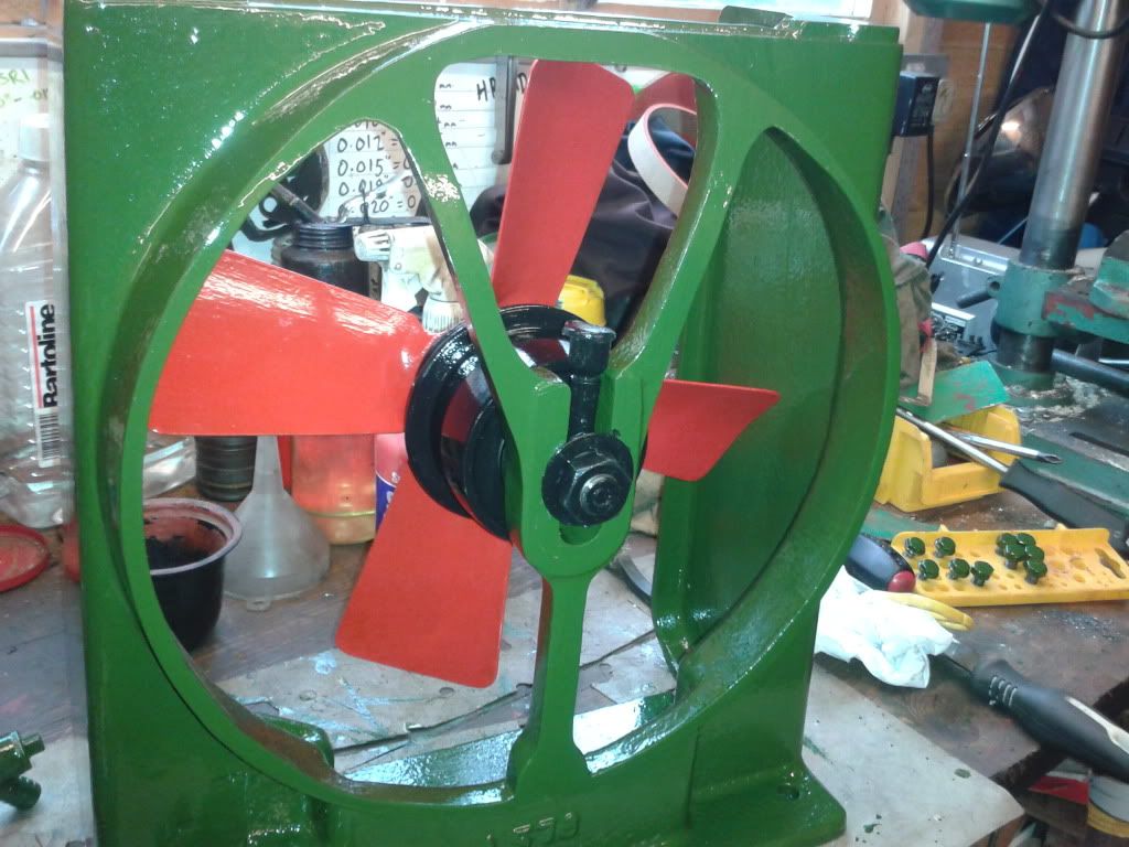

Well, I went out to the workshop today & my dad was already in there Rolling Eyes , seems his new carb for his Velocette arrived from Amal this morning (they took their time! BTW they're now reproducing many of their old carbs again, with modern materials & production techniques, but they are out of the price range of most stationary engine enthusiasts), so there wasn't much room in the workshop for me, but I did manage to get a couple of photos of the fan assembly in the rad surround (it will be mostly hidden when assembled, but I haven't got the rad to go in there, as it's round Ian's place for pressure washing)....
This side will be hidden by the rad....
This is as much as will be seen when it's assembled, picture it behind a black honeycombed rad with shiny brass tanks....
When he'd finished with his Velo I got on with giving the engine a 2nd coat of paint.
I fitted the new core plugs this afternoon as well (before painting). They were pretty loose in there, so I stuck them in with some of that Green Hermetite stuff. It's old stock, so I'm not sure if mine's gone off, it came out quite thin at first, so I whiped it off, gave the tube a good shake & had another go. It should be OK I suppose.

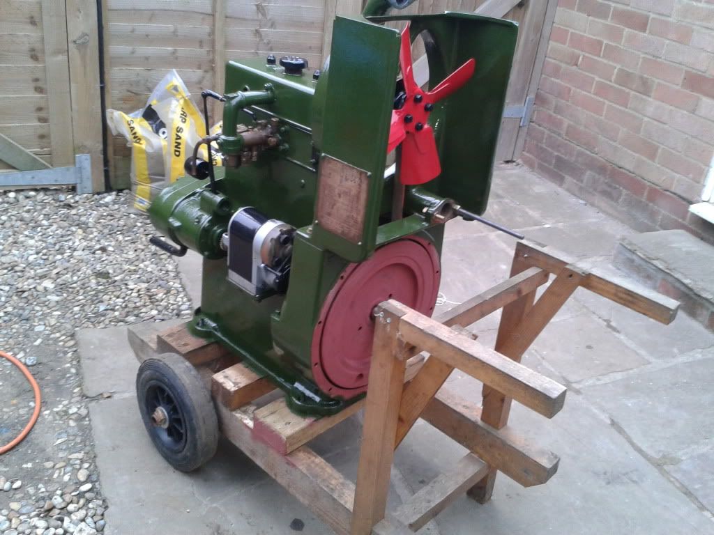

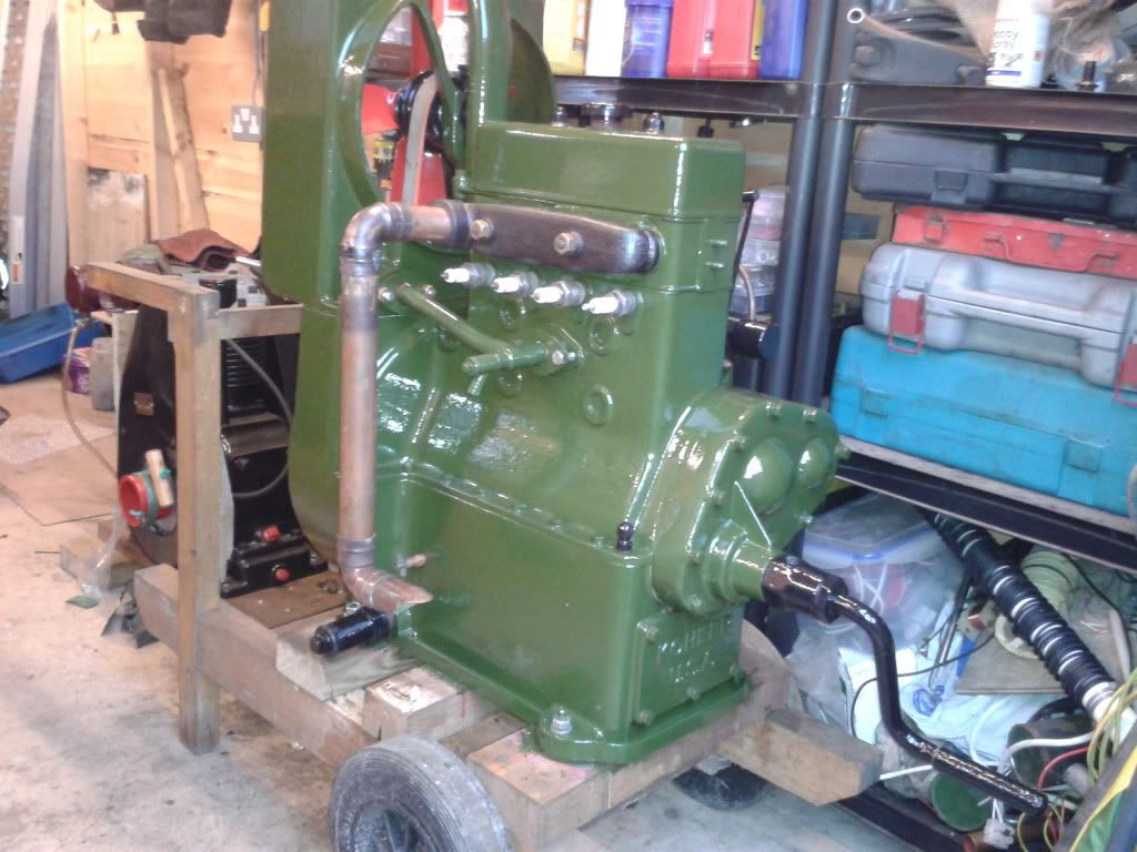

I thought I would piece it back together today, to let the paint harden whilst I wait for the last bits to arrive from Canada. Also, it takes up less room as a complete unit & I'm less likely to lose any bits if they're all attached to each other. I've also been playing about with a possible exhaust system (notice in the background the door now has a cat flap. That was my "other" job I had to do today Rolling Eyes )....
here's the bits of exhaust I've got to play with....
I had a play around with the blow lamp & sorted out the last bits of the system (the first elbow will be clamped, as it'll be too hot there for solder)....
As long as it all holds up, & isn't too loud, I see no reason why it shouldn't stay as a permanent system. It makes more sense than an up-swept tractor style pipe, as they really need a condensation trap, especially with a 4 cylinder engine as there's always a valve left open, for moisture to corrode.

Well, I didn't think an exhaust would be hot enough to melt solder, but I used some of this pipe & fittings on my little JAP model 3 & it actually blew molten solder out of the joints!
I'm guessing as this is water cooled, & probably an altogether slower & more relaxed engine, it probably won't be a problem. But the top elbow has had the hacksaw treatment to give it split ends (like an exhaust) some time ago (when I was messing about with that little JAP), so I've ordered some clamps for it. I haven't ordered the old fashioned U bolt type clamps, I've gone for these ones instead....
If it's too noisy I will have to get a box for it. I've been searching high & low on eBay for possible silencers, when it occurred to me that many smaller cars have (or had, I'm really talking about older cars here) a small silencer in the centre part of the exhaust (like small Renault 5s & 11s, Metros, Polos, that kind of thing). So I just put an eBay search in for "Exhaust centre box", sorted it by price & found the cheapest (I'm also trying to help Ian out here as he's looking for something for his Stuart Turner). I won't go ordering anything, as this one may well be fine without a silencer, but at least I now know where to go if I need one.

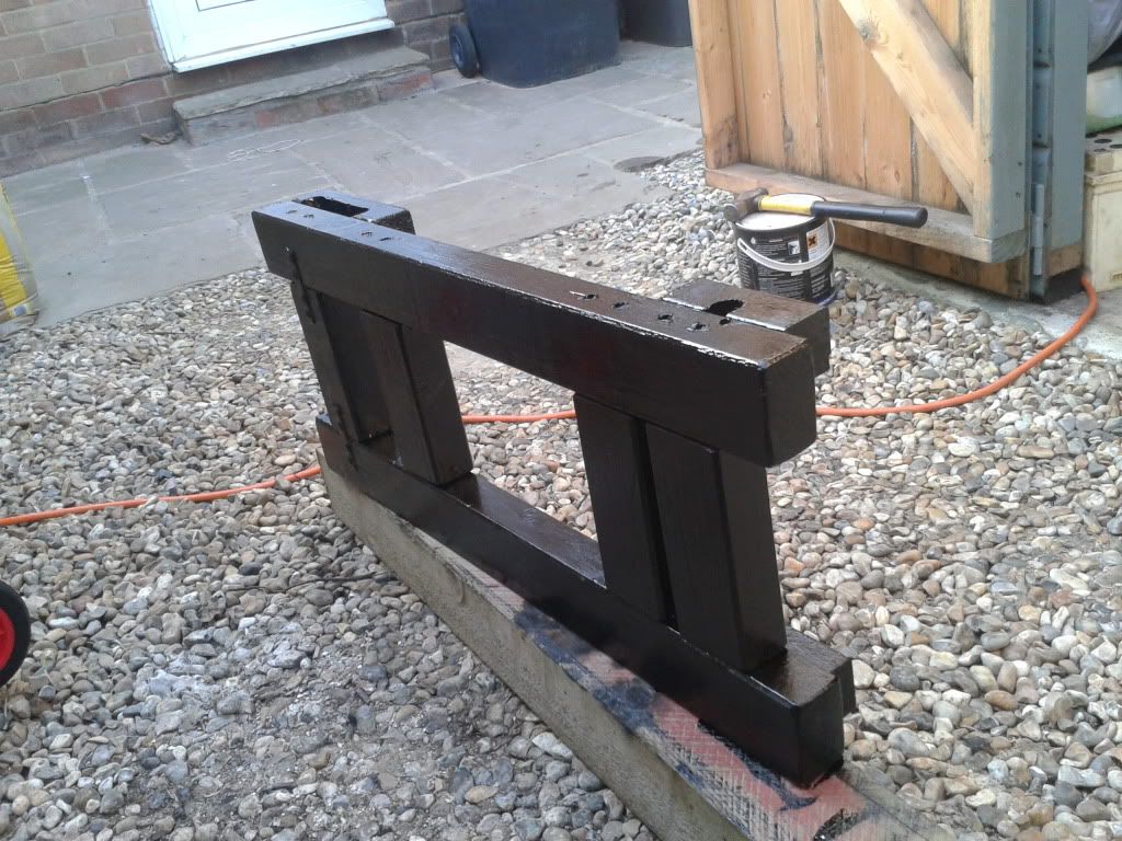

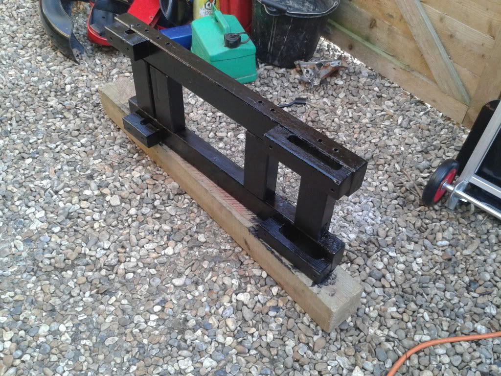

Well, I managed to knock together a trolley chassis today. Nothing very exciting really....
I decided to make my own axle clamps, out of wood (seen here with an old piece of 20mm conduit, NOT the axle I will be using as I don't have them yet)....
The front wheels need to steer, so the clamps will be a little different....
The axles will be 20mm diameter, so I will be using this as a steering pivot point....
It's all very basic, but should work. The conduit box will have the M20 threads removed from 2 of the holes (unless I go & buy a 25mm T box) so the 20mm axle will pass straight through. It will have a hole drilled through the base of it & a coach bolt will pass straight through it & the wood to act as the pivot. Hopefully there will be enough clearance to pass the axle through with the bolt in place, otherwise I will go for a countersunk machine screw. I'm hoping to drill the pivot hole through the wood slightly oversize & put a metal bush/spacer in there to add strength & avoid too much wear on the wood.
As the conduit box is a T I can get a piece of 20mm metal conduit, which will make up the steering handle. But it will probably have to be a steering handle only, not a pulling handle, I don't think it'll be up to that, but will have to wait & see how tough it all is.

I've got the trolley ready & given it another coat of Bituminous Black paint....

Well, the axles turned up today, so I've finished the trolley off, I just need to think up something in the way of a handle/steering device now. I've got a few ideas but they all involve spending money. Once again my lack of metal stock is holding me back, I may end up having to string a piece of rope round the steering axle, like a child's go-cart. It'll work (in one direction), but it won't look very good. I'll take some pics tomorrow & see if anyone else has any bright ideas.
I measured up & I think when it's all finished & mounted up it will clear the top of the boot-line on my brother's (or my dad's) car by about half an inch. Which is plenty. I can always take the rad cap off & make it a full inch if necessary Very Happy .
I also did the HT leads & brass terminals today. I used modern crimp terminals at the magneto end, but covered the modern blue plastic insulation up with some old-fashioned-looking, self amalgamating, rubber tape (I can't believe I lived so long without that stuff!)
I used cheapo plastic HT lead in the end, & found someone selling cheap brass plug terminals. I really hate lining Tim Green's pockets, Greens Sparkplugs have a bit of a monopoly on vintage ignition parts, & they really make the most of it with their prices. I love it when someone comes along with cheaper HT lead or brass terminals. If anyone has another source for braided black HT lead I would be very interested to know. I'm sure it doesn't have to cost over £5 a metre!
I've taken my little plumbing job apart on the bottom pipe. I wasn't happy with it, it appears I've either cut one, or both, of the pipes too short by about 3mm, or have not bent it to quite the right angle, or possibly both. It would have sealed with a load of silicone sealant, but that's not good enough for me. I've got plenty of 22mm copper pipe left, I've ordered a couple of 45deg obtuse elbows & am going to have another go when they arrive. I also found out what a "street elbow" was & ordered one of those too, just in case. (If you don't know what it is, it's on Wikipedia).
Ian bought the rad back yesterday & I fitted it back to the frame tonight. I had a go at stripping the last stubborn bits of paint with a tiny little screwdriver last night, but it was a tedious job. Eventually I plan to spray paint the core black, but I'm not going to paint it until I know it doesn't leak, because if it does it will need to be soldered, & as we all know; solder doesn't like sticking to paint.
I will get some more pics of all this stuff tomorrow. If the weather's OK I will wheel it outside & take some. But it won't be going on the new trolley until after I get the bits from Canada, as it needs to come apart to go from one trolley to the other (it's far too heavy to: lift on, mark holes, lift off, drill holes, lift back on again accurately over the bolts etc etc etc). Hopefully the bits will be here before I go crazy & we can all see it grow on it's new trolley.

I think the rad is still water tight. I left water in it over night & it was still in there the following morning, but it's a bit inconclusive as I've had mixed results in my various tests of it.
I put it all back on the engine, sealed up the flanges as best I could (with dry gaskets, as it will all have to come apart again) & I blew into the top of the rad. It seemed to hold the pressure from my lungs OK, but again this isn't a conclusive test.
I think the only way to be sure will be when it's all together. It is all brass & solder though, so can't rust. I've also got to think about the head gasket joint as well. I know I say not to do it, but I will have to seriously consider weather or not to add some kind of compound to the joint faces or the gasket. The trouble is I am re-using an old gasket, which also should never really be done on cylinder heads (in an ideal world, of course). But this isn't an ideal world, so I may be getting the Hermetite Green out again.
I may ask for a quote on having a new gasket made up. There's a company based in Thailand which gets good reports on SmokStak, & there's a few British companies as well. I bet it's not cheap though. Anyone know???
