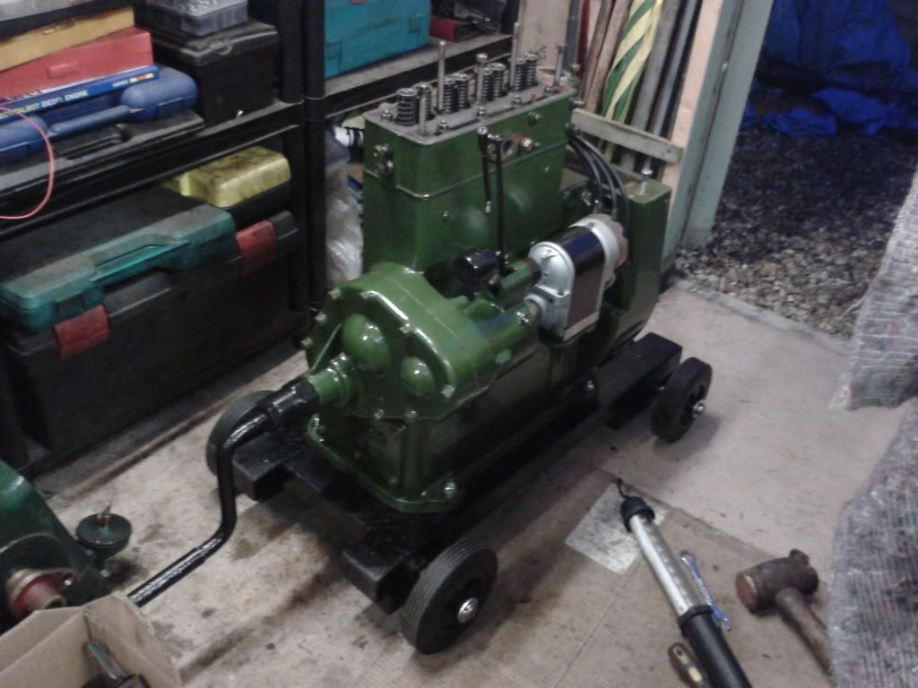

Post by nutgone on Thu Mar 21 2013, 15:15
Look what dropped on the mat this morning....
I had a couple of people contact me to ask if I had spotted it (which I hadn't) on eBay. I saw the bidding started at a fiver, but never spotted a buy it now price. I don't know if the seller added the buy it now later or if I just didn't spot it until later, but once I discovered it I thought I should snap it up (for a tenner).
It's basically the exact same book that I have on PDF format in my computer (which someone from America very kindly emailed to me), but the PDF isn't very good, much of the text has been touched up (quite badly) & many of the pictures are so grainy they are unrecognisable.
This book is in very good nick on the inside (not too bad on the outside either). The photos are lovely & clear....
Also, it's a complete maintenance manual, including complete strip-down instructions & a full parts catalogue....
The only trouble is this is from the later engine, which is of the same basic design, but has a few differences. The engine number from the engine which this book was supplied with, is still written on the front. If I've got it right this is from 1948, which was pretty much the last year they made these plants.
Still, a very useful book & goes really well in the collection, alongside the engine.

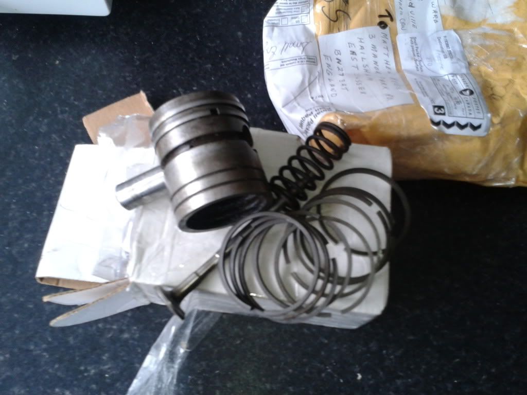

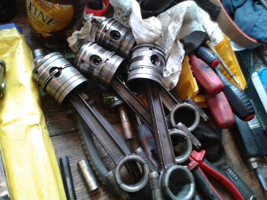

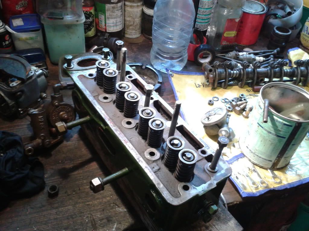

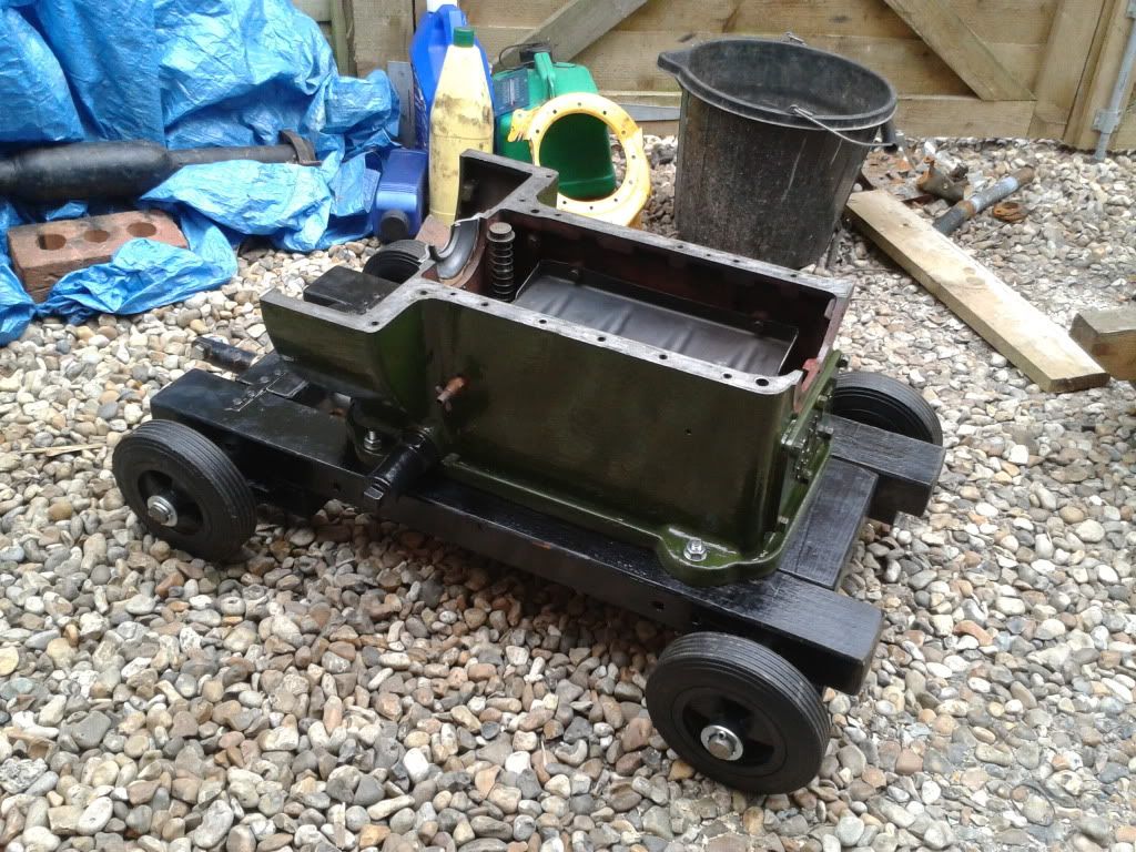

Look what finally arrived in the post this morning....
That's right, it's the long awaited bits from Canada!
I've been busy with it all afternoon/evening but have now had to come in after pulling a muscle in my arm (I was cranking the engine over, trying to get the rocker shaft filled with oil, I know it's getting up there, but it's very slow pumping when turning the engine by hand).
Anyway, I started by carefully dismantling the engine this afternoon, then I realised I never put a coat of red oxide primer on the underside of the sump! So I did that, I also did some other bits of painting, including the back side of the flywheel....
Then I put the final valve in the head, gave it a quick lap in & put the spring & collet on to complete the head....
I got all the pistons out & put the rings on which I got in the package. The replacement one is different, but will run just as well....
I started to get it built up on the new trolley, in the usual order, coating all gasket faces with wellseal as I went & applying all the new gaskets I had already cut....
So far I've got the head & rockers on, done the tappet clearances as best I can (they're supposed to be .006" hot, so I've done them to .008" cold & will re-do them once she's run up to temp). I've got everything but the bottom radiator pipe, exhaust manifold & fuel tank on. I will do that tomorrow, if I can move my arm by then.
If I hadn't injured myself I would've been attempting a fire-up in the morning. It's probably not such a bad thing to pace myself though.

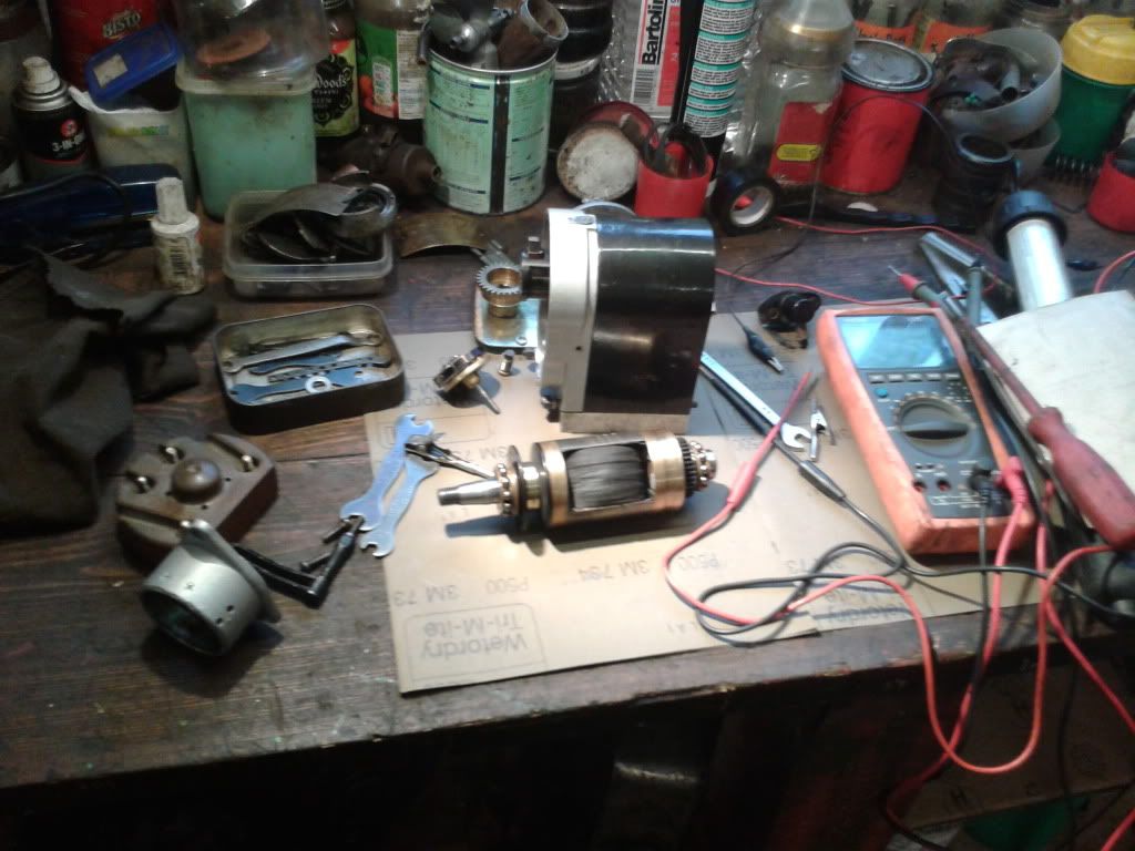

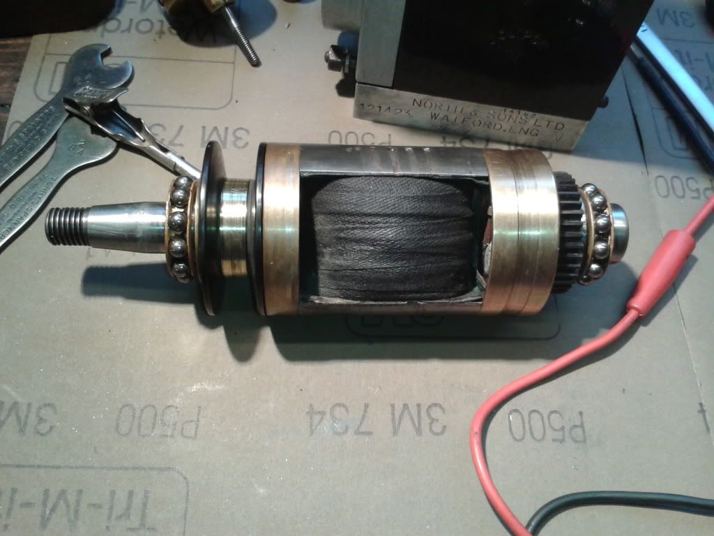

Post by nutgone on Fri Apr 05 2013, 19:02
Well, when I had it on the bench I was getting sparks at quite low speeds, but I've been playing about with it this afternoon, with my dad's assistance, & we think the problem is magneto based.
I even managed to rig up the electric drill to turn the engine over. I got it going as fast as the drill would go & still it wouldn't fire (it's a 1000watt drill & was pretty much up to it's limit with this job, I had to put it on the lower speed for the extra torque).
Anyway, I took the mag off & dismantled it for testing....
It seems I'm not getting very good readings through the coil....
This could end up being expensive. It's a moving coil magneto, so not easy (read: practically impossible) to convert to battery & coil system. Also it has a built in distributor, which would be just as impossible to convert.
Looking at it though, I may have had the distributor gear out by one tooth, but I was still getting sparks, just not very good ones.
So, until I'm in a position to re-wind my own coils, this one may have to go on a back burner. I will ask my local mag bloke if he could do just a coil re-wind & how much it will cost, but I may well just have to keep my eyes open on eBay.
It's bloody typical, when I first had this engine in my sights I had a feeling it might need a new mag. There's an eBay seller up near Stu who had a 4 cylinder Wico A which sold for about £15. I was going to buy it "just in case" I ended up getting this engine, but I decided not to as the bidding was going up on the engine.
Anything like that would do though, a Wico A or similar, best bet would be a rotating magnet type, as it's easier to convert them to coil/battery or my favourite "Energy Transfer" system.
If anyone knows of any old 4 cylinder mags going cheap, let me know. Because until I get either a replacement mag or some kind of distributor to fit in there, this engine ain't gona be running. Crying or Very sad
