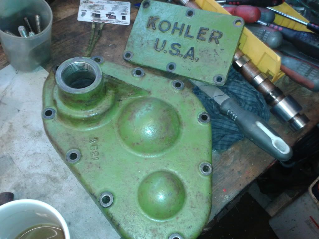

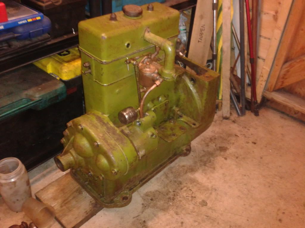

Anyway, today I've managed to date this engine (I think). These engines were built from 1923 right up until 1948. I believe mine is a 1928 model. My mistake, it's actually a 1929 model. & yes, the carb is solid bronze.
Which makes it my/our oldest engine (which was previously the Briggs & Stratton, at 1931).
Considering it's age, the cam shaft shows surprisingly little wear. As does much of the engine.

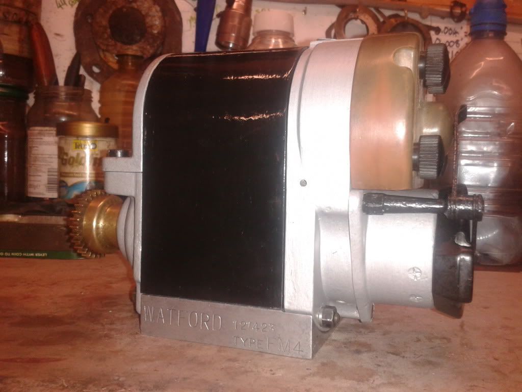

I've been looking onto this magneto. It's a Watford mag, made by North & Sons. It's a model FM4 & they were used on both the Austin Heavy 12 & the Vauxhall 30/90 cars. They are quite an expensive mag, & would no doubt cost me a lot of money if I needed any work done on it.
I've been looking into prices & it seems if the engine was no good I could easily make my money back on the magneto alone. I am tempted to bodge a Wico A type 4 cylinder mag on there & sell this one to fund the project, but I could never bring myself to do such a thing.
Although it seems doubtful that Kohler of America would fit a British car magneto on their engines, this one seems made to measure. there are no alterations present on either the mag or the mounting bracket, so either someone got very lucky & this one just happened to fit, or they were put on from new. I just can't work it out, there isn't even any shims, or even slotted holes, it just goes on & fits.

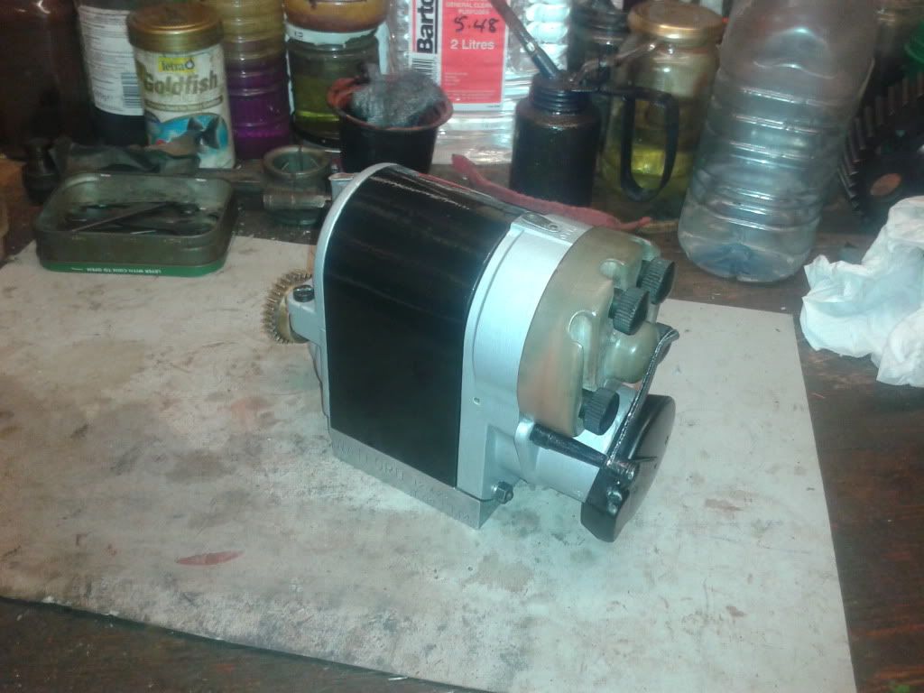

Post by nutgone on Wed Feb 13 2013, 19:59
Got that mag finished this evening....

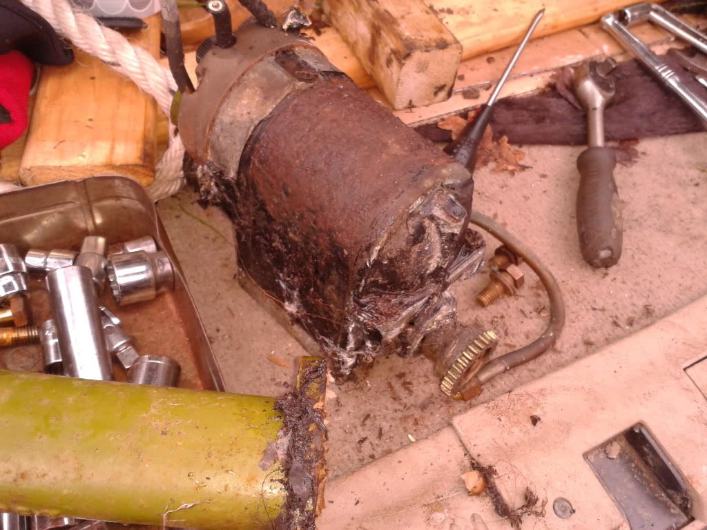

Here's a quick reminder of what it looked like when it came off....
Now it's done....
I tested it by wiring up 4 plugs & putting the whole lot on an aluminium sheet. I wound it over with a cordless drill & it works really well. I'm getting good sparks even at really low (cranking) speeds.
I think I've been really lucky with this one.

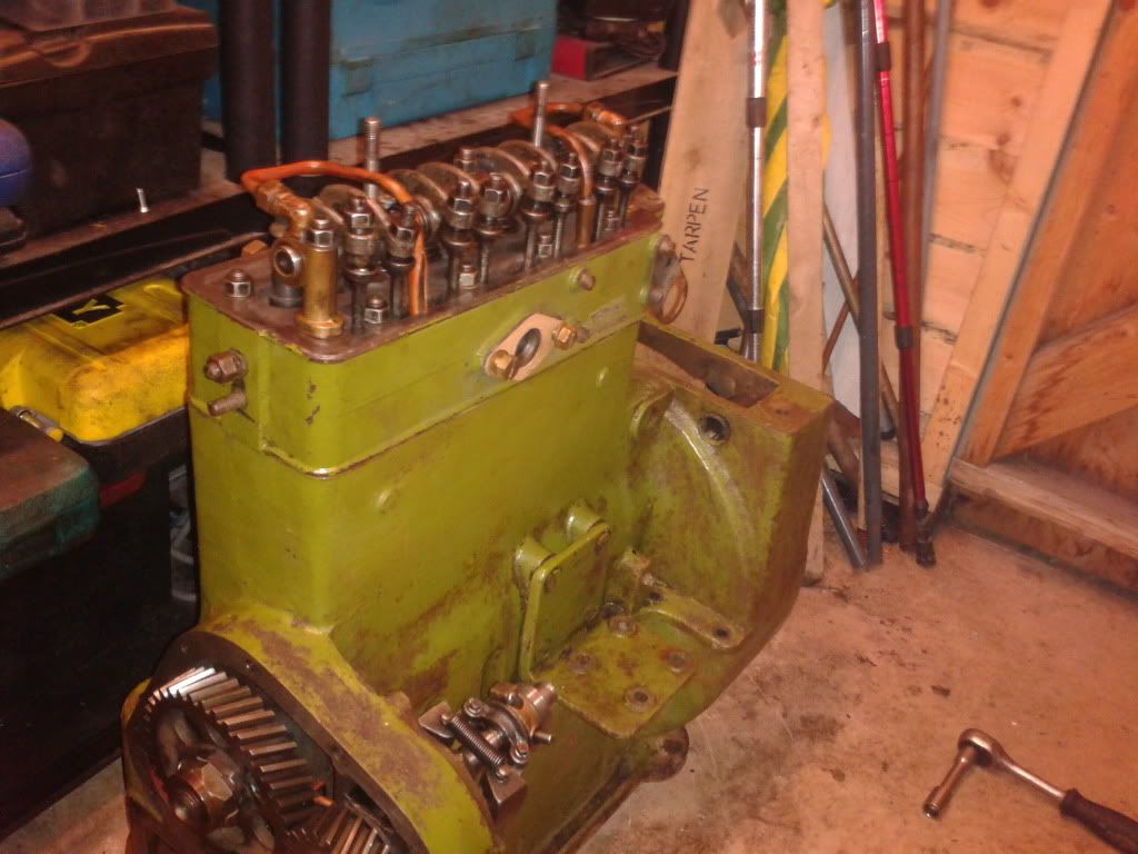

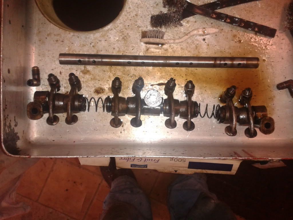

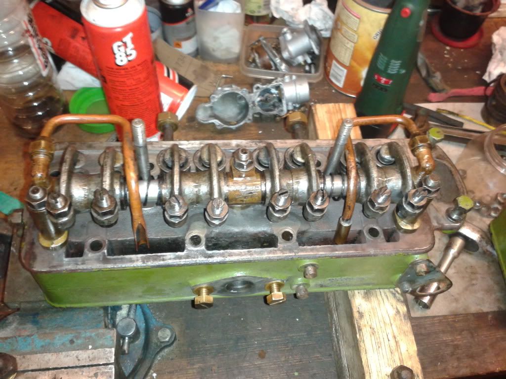

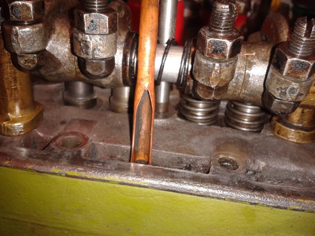

I put the springs back on (I found out that one is slightly different, it's heavier, so I may look for a replacement, but it will work if not). Then I set about cleaning up the rocker assembly. I managed to get it all off the hollow shaft & put it all carefully in order (I also took plenty of pics, just in case I dropped the tray or something)....

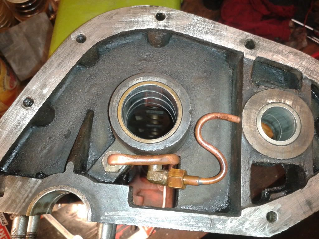

I did what I could to clean out the hollow shaft, then painstakingly cleaned up each part & put it back on in order. Then I dug out the oil pipes, cleaned them up & put it back on the head....

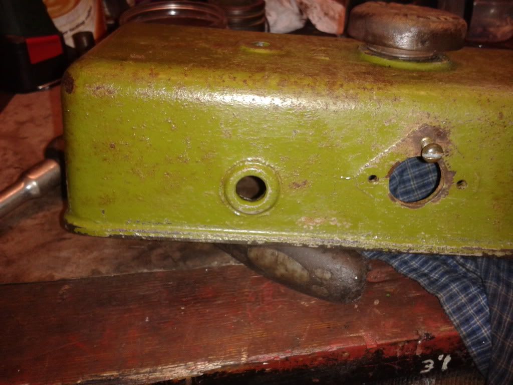

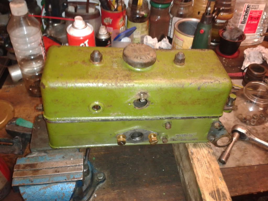

I even cleaned up the rocker box cover & put that back on....
The hollow rocker shaft is the highest point in the pressurised oil line & represents the end of the line. The oil feeds in one end, then out the other end is this pipe....
This feeds the return oil down to the tray which the big ends dip into (the dip & splash part of the system). The reason the pipe is split is so that the operator can check for oil flow through this hole in the rocker box cover....
Basic but clever Very Happy .

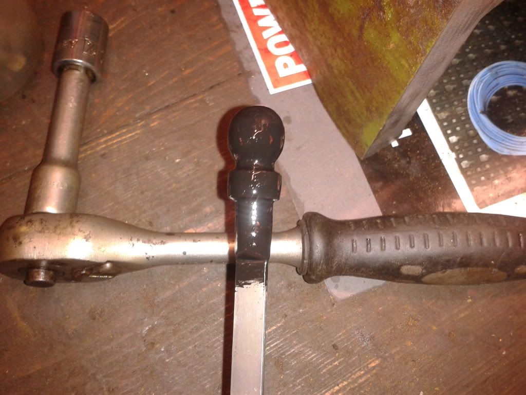

Then I had another little play around with a little piece of the engine I have neglected to mention until now, the oil dipstick. When I dismantled the engine I never figured it would have a dipstick, & I never worked out what the little bobble was that stuck out along the row of rusted off sump bolt heads, until it was too late. I had tried to remove this "bobble" with some kind of wrench & it had fallen apart, it was only then I realised I had destroyed the dipstick handle!
So I set about modelling a new one from metal putty & the left over parts of the old one. I've been working on it, on & off, for a few days now, in between other jobs, & I finally got round to giving it a coat of paint last night....
Not too sure how it looks against the original, but it fits nicely & should work fine.

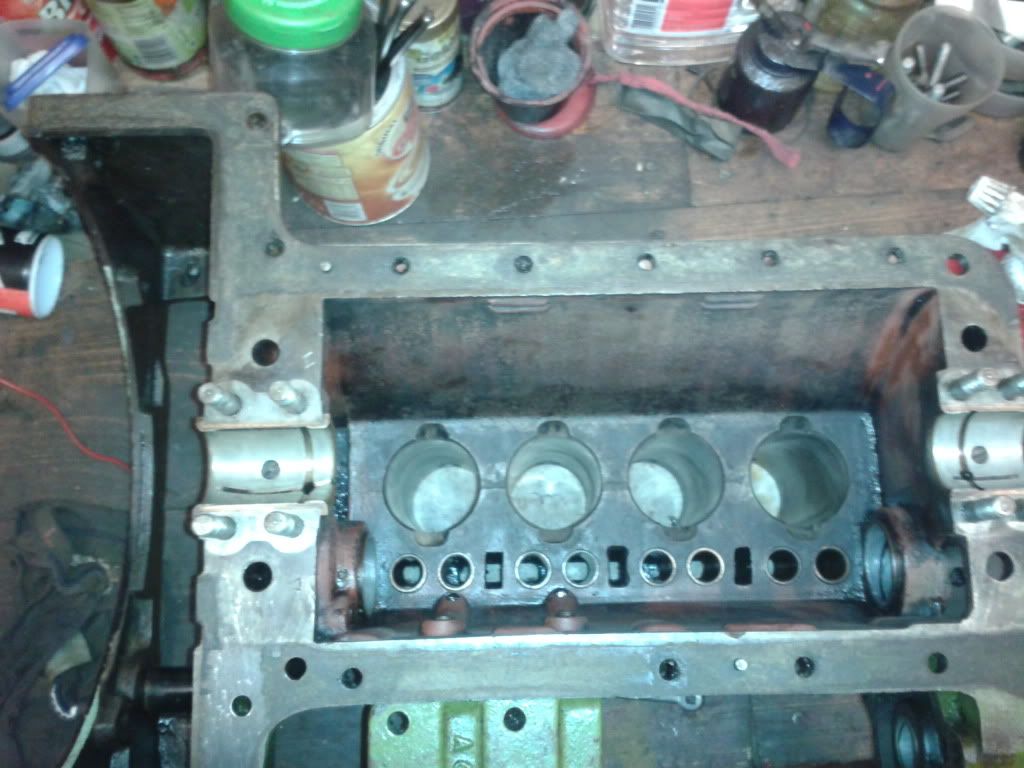

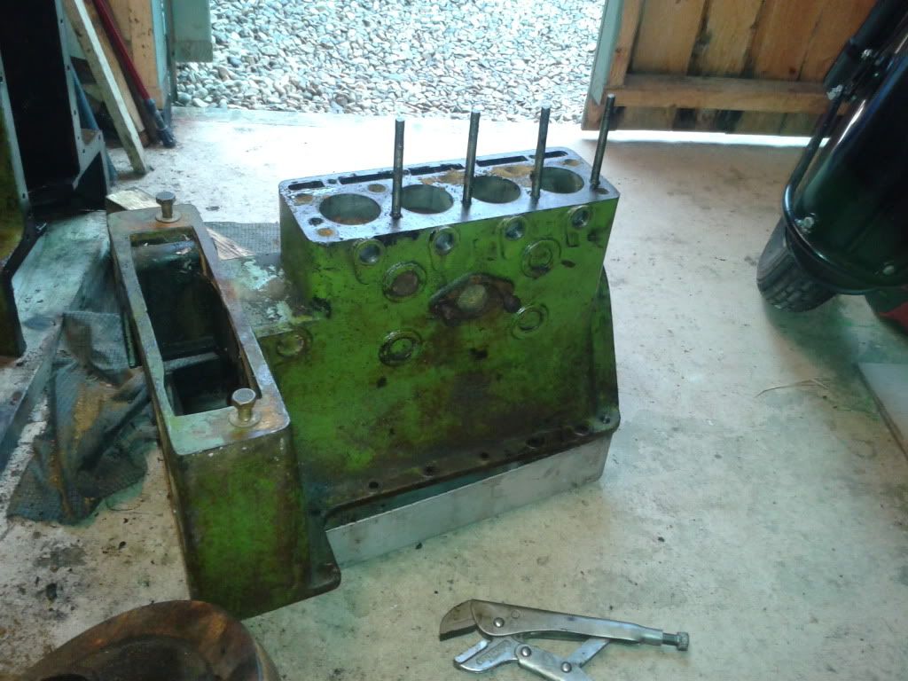

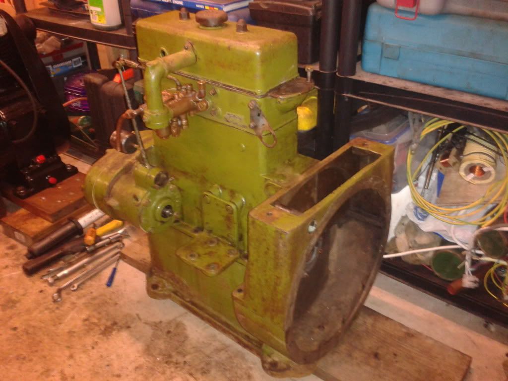

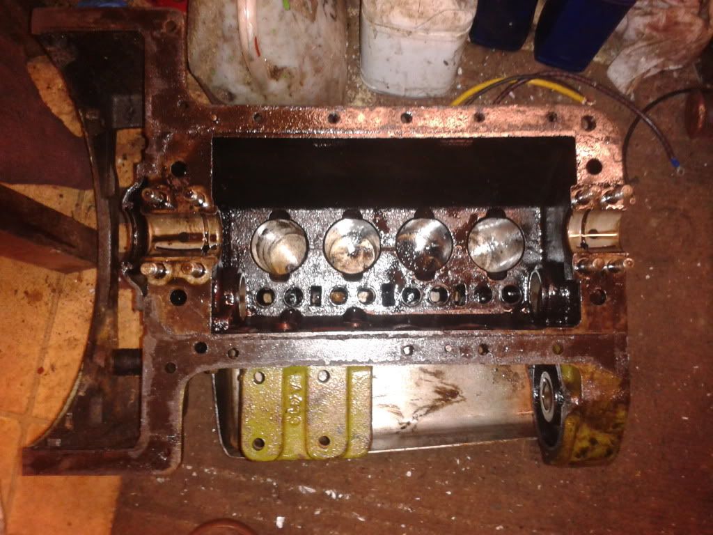

But all I was doing was putting off the inevitable job of cleaning the crank case, so I set to that. First of all I needed to find a way to balance the case upside down, preferably in a tray to catch all the cleaning fluids. I don't like balancing the crank case on the head studs (although I have done it), so I had to remove the studs....
I would like to tell you it was really difficult, but they all came out relatively easily. None of them could be turned by hand, but they all turned with the mole grips & all 9 of them came out.
So I turned it upside down in one of my big industrial oven trays & got on with the job in hand. First I took some pictures of the gaskets, for when I make the replacements. All the gaskets on this engine must have been put on with Araldite or super glue or something, every one has stuck firmly to the surface & has required scraping, then wire brushing, then sanding off with the Dremmel (normal sanding just will not remove these gaskets), they've all been real hard work, but I have been left with a lovely clean surface afterwards. Anyway, the gaskets were removed after cleaning, first I had to clean....
Before....
After....

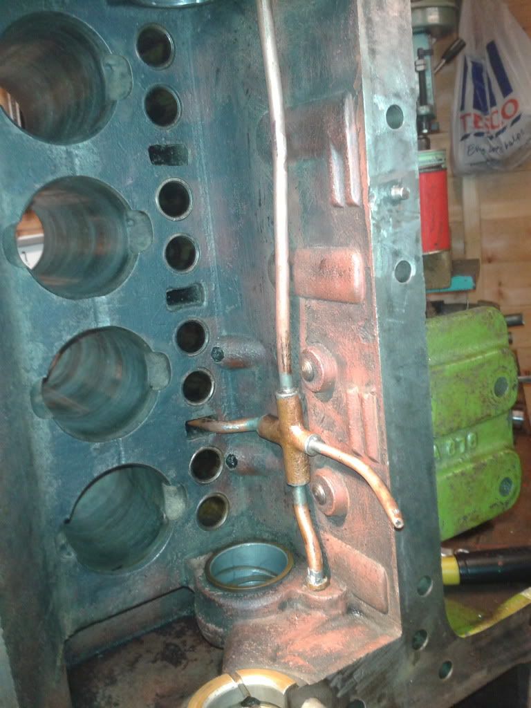

It took me all evening, but I did it. I then replaced the oil feed pipes....
& I can tell you, these pipe unions were not easy to do....

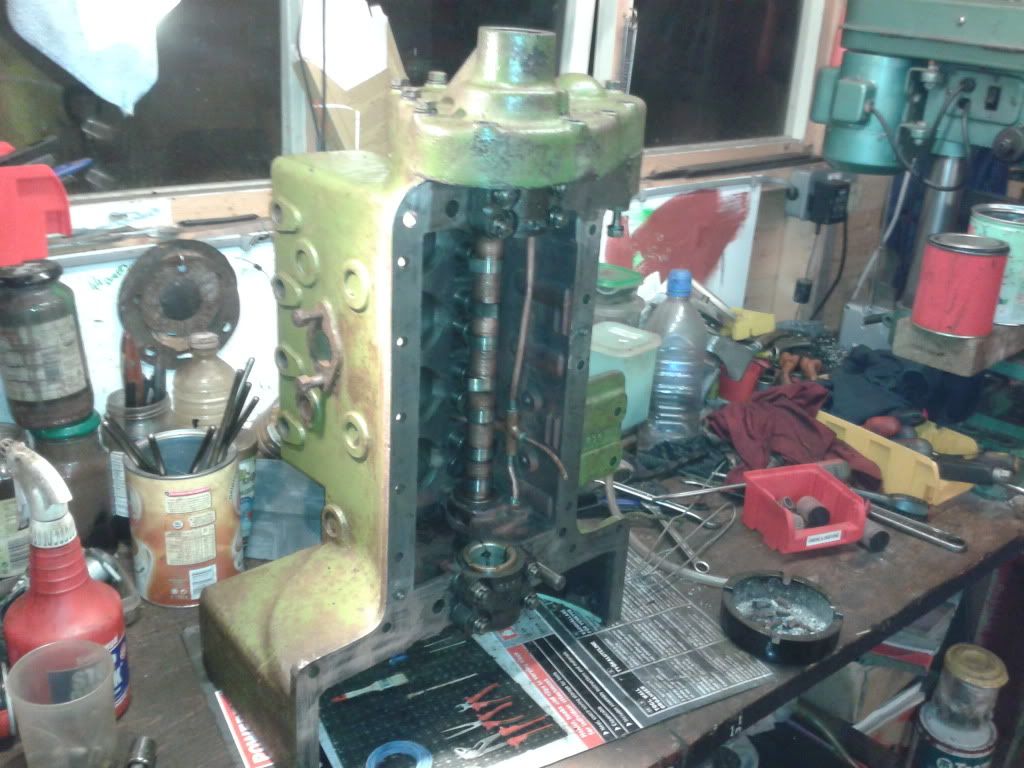

I've also replaced the tappets & the cam shaft. I noticed a little bit of corrosion on the cam shaft, where the valve had been stuck open all that time....
But there's little I can do, I expect it'll be fine & I've certainly seen & used much worse on other engines.
So, here we are, one completely clean (well, as best as I could do) crank case, complete with oil feed lines & cam shaft....

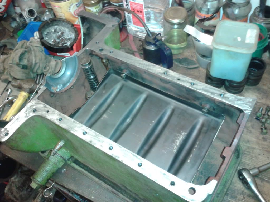

Now, where did I get to? I think I had just finished cleaning the crank case. So yesterday I started by putting the governor back onto the crank case, which wasn't easy as the gear is a very tight fit on the shaft, but it went on without too much hassle.
Then I thought I should finally finish off cleaning the sump, which was almost done, but just needed the final treatment, which it got. Then I put it on the bench & decided to re-fit the oil pump & oil tray (the oil tray fitting is not a job I wish to do again, but I may have to if the height isn't right for the big end dippers)....
I also took off the bottom half of the oil retainer (strictly speaking it's not an oil seal). This has been broken at some point in the past & badly repaired. In fact, some complete idiot has had their hands on this engine in the past, as the top half of this split oil retainer was fitted to the bottom part of the engine, I know this as it has some drain holes drilled in it. Also, the big end dippers were fitted round the wrong way, which could have been catastrophic. I just hope the big ends have survived OK. My guess is this engine didn't see much service after this botched monkey rebuild. I have used some JB weld to set the 2 broken pieces together & bolted them into place. I will make up the hole that's left after this sets with some metal putty. the part is under no stress, so it should be fine (famous last words, i expect like all metal glue repairs it will need doing about 2 or 3 times to get it right, but i have little choice with this, as it's made from a poor grade alloy of some sort). I did have a pic, but it seems to be stuck in my phone (having photobucket troubles as well, it seems).
Then I put the sump back on the plank of wood I have on the floor (after a good sweep up). I thought I would place the crank case on top, just to see what it looks like....
Hmm, very nice, I thought. I wonder if I should clean up the head gasket & maybe just.....
Ah, yes. That's better. Now, earlier I cut myself a few gaskets....
I thought the best & safest place to store these would be..... You've guessed it, on the engine, along with those nice clean castings. So I pulled the rockers off, put the pushrods in & set the tappets by hand, just so I could turn the cam shaft & check the valves weren't sticking (of course) then set about piecing it all back together, finger tight (just playing about really)....
Obviously there's no crank shaft in there, but it just goes somewhere to showing me where all my hard work's been going these last 2 weeks (yes, it seems I've now had this engine a whole 2 weeks!)

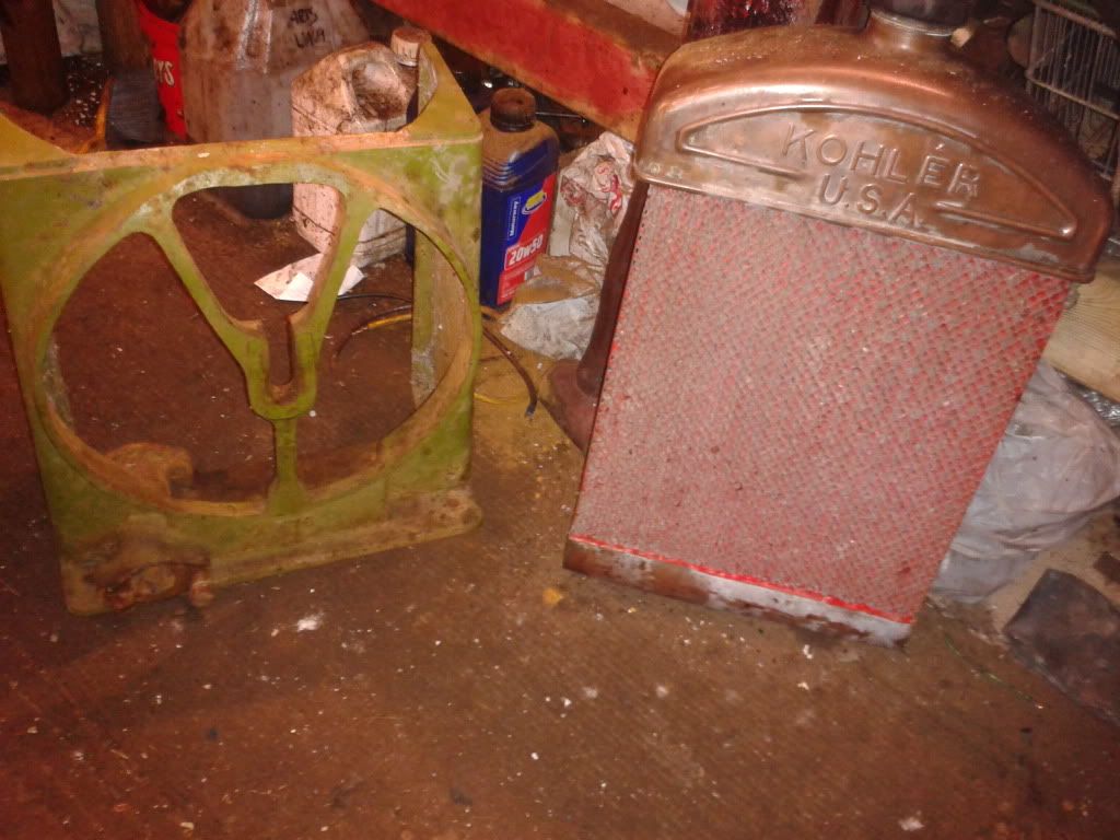

& these bits to finish off as well (the rad has a sheered off bolt in one of the top flange holes)....
I've still got the fan blades to clean up as well, then I've got some pretty big gaskets left to cut & a whole load of painting prep work & priming to do, so I should be busy.

Post by nutgone on Tue Feb 19 2013, 14:00
That's quite inspiring actually Stu, & you're right, I would like to see this engine at a rally too. Maybe I should enter it for one or two this season?
In all honesty I didn't think it would be ready this season, I obviously don't know myself very well, do I? Rolling Eyes
The weather is fine here today, so I think I will see what I can do about making up a trolley for this one. I have enough bits to make something simple for now, & can elaborate on it later on.
Last night I put the crank shaft back in to check the fit of the main bearings. If anything they seem a bit tight. I also bolted on each of the con rods, 2 of them are a bit tight, one is a tiny bit too loose, but pretty much perfect, the other one is a little too tight for my liking, I will probably play around with them after the sun goes down.
I also found what looks like a crack in the side of the block. It's not in the water jacket & doesn't look structural, so I'm going to investigate that as well.
Then I've just got the last few bits to clean, but that includes the 3 good pistons, which have very dirty ring grooves, so my work's cut out for me there.
I need to get my entry forms filled in for the early rallies this year as well, but I'm not sure what I'm going enter. Need to get together with Ian & make our minds up. The only complete & show-able engines are the Scott & the Tarpen (with a little work). Part finished, but running, we have the Homelite, the Briggs & Stratton & possibly the Stuart Turner P5XC.
We need to get realistic about what we can have ready by the end of May.
