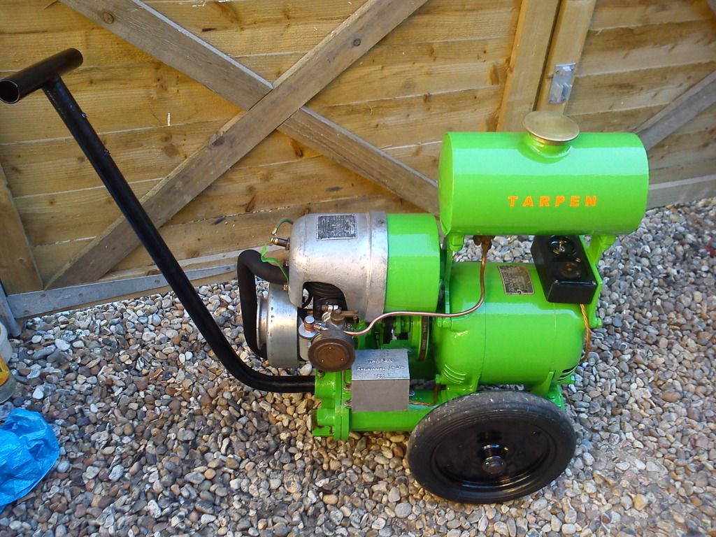

In the flesh I would say this engine (paintwork wise) would be ready to rally. OK it would look a little tatty to the untrained eye but the enthusiasts would love it. Maybe enter it into the later rallies of the season.
So far I think the Scott, Tarpen and Briggs are our engines for the early part of the season (possibly the Homelite). My Stuart Turner is proving a bit of a challenge when it comes to sourcing bits and getting it all together but it is starting to take shape. Maybe middle of the season is when I should plan to introduce that one to the rally scene.
That's my two pennies worth anyway.

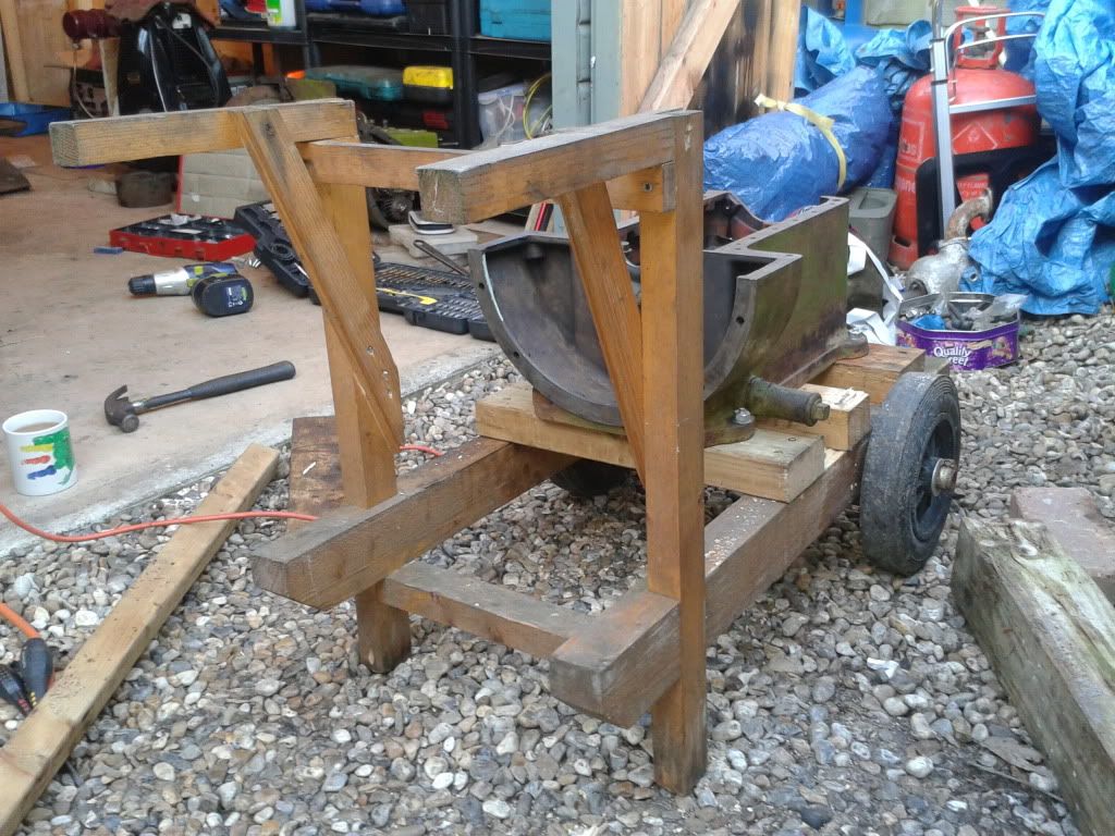

Today the sun was shining, so I decided it was time to get outside & start to build a trolley for this engine to go on. It's only temporary, so I can move it about once it's built (as it's just too heavy to be left on just wood, I need to be able to move it). Fortunately I had a trolley outside, it's one I got my Stuart Turner P6M + gearbox on. With a few alterations & additions it was made suitable....
It'll do for now anyway.

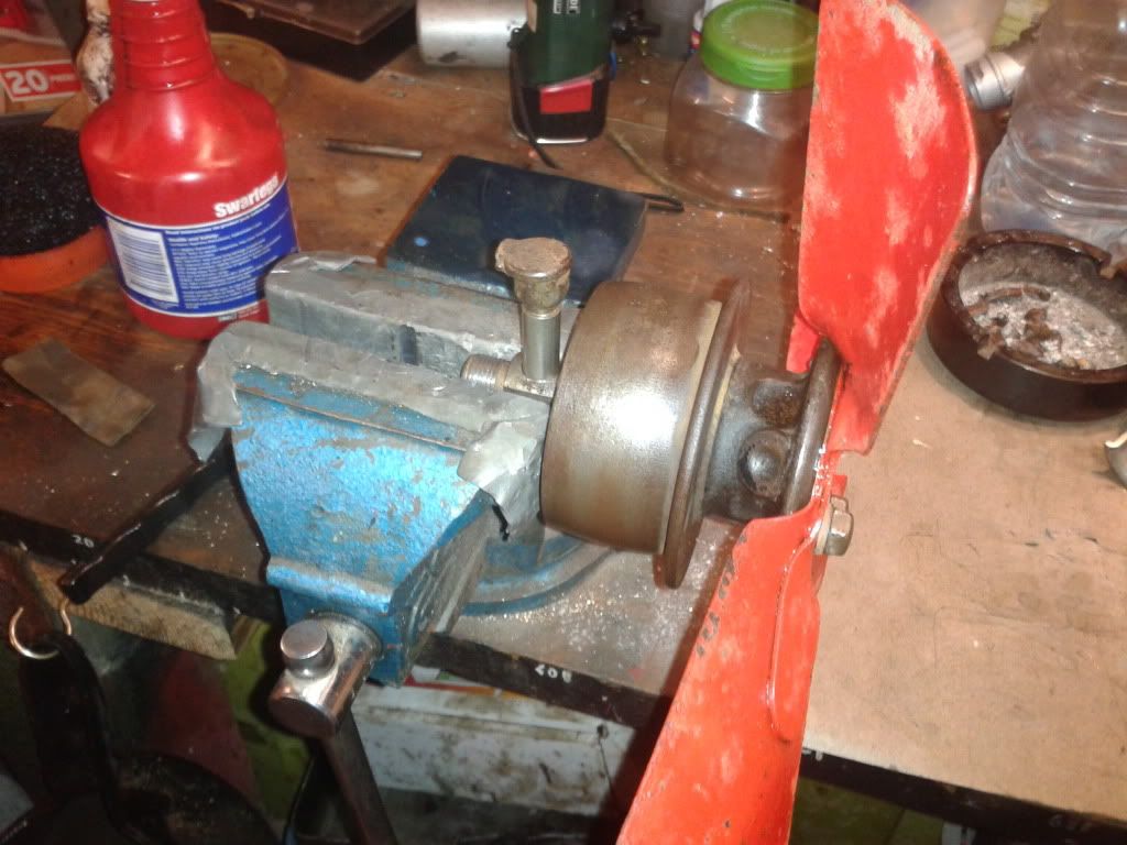

OK, so a bit more of an update. Yesterday I started off polishing the radiator & cleaning up the connections. It seems that the rad tanks have, at some point, been very lightly copper plated. I'm pretty sure this can be achieved with something as simple as brushing on a solution of water & copper sulphate crystals, weather this is what's been done I don't know, but the thin layer of copper came off with some abrasive polishing to reveal brass tanks. I can only assume the copper was used to hide any solder, giving a nice uniform finish. Here it is, with nice brass tanks....
The wet looking patch is some parts wash which went onto the core when I was freeing off the broken stud in the top flange.
After that I thought I would finish off the last of the parts washing. This involved the fan assembly, the last few bolts & the exhaust manifold. The fan bearing assembly was already disassembled, so I laid it out in order & took some pics....

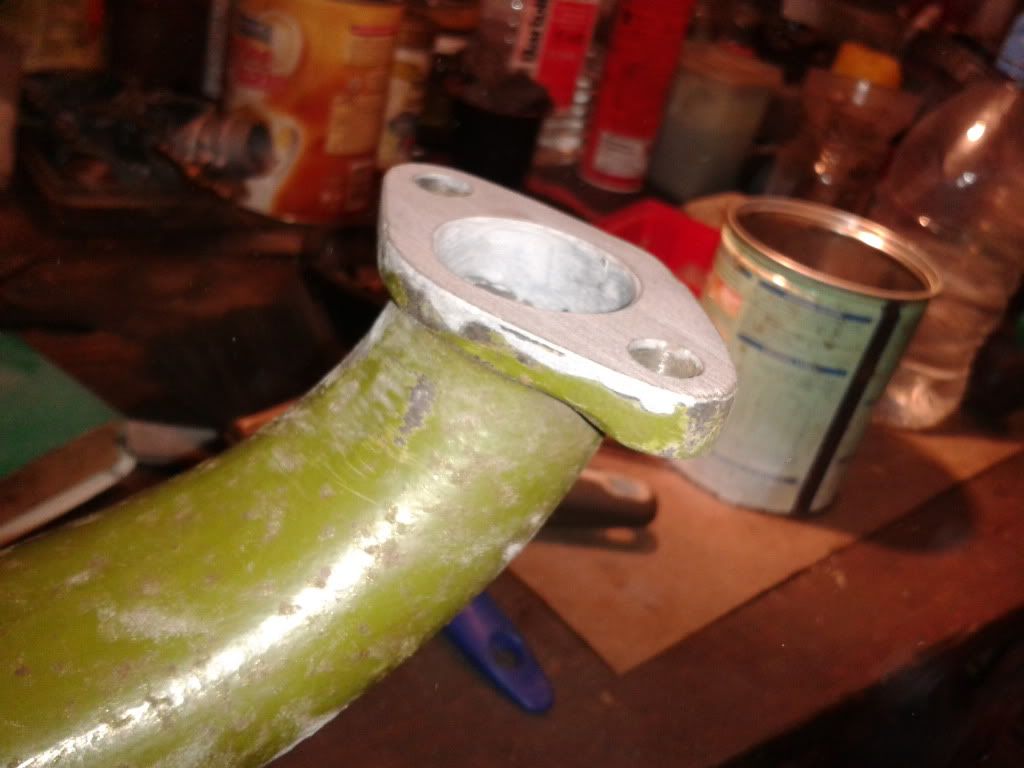

The bottom connection is a bit strange on this, originally I thought there were 2 bolts missing. For some strange reason the water runs through a small section in the cast iron rad surround. This has one threaded stud & one drilled clearance hole where the engine pipe connects, then both flange holes on the rad are threaded. So either the engine pipe connects with the one threaded stud & a nut & bolt, which is unlikely as the back of the clearance hole isn't flat enough to take the head of a bolt & it would then be practically impossible to get a bolt in to that side of the rad connection. So it must need a big long through bolt, which is missing, but I have a coach bolt which will do for now, & if I can't find anything else, with some simple grinding, it will do as a more permanent fixing. Here's some pics to try & explain what I'm on about....
Here's where the engine bottom pipe connects to the rad surround (you can see the coach bolt going through, with a spacer on the end to make sure it will eventually be long enough)....
Here's an attempted shot of where the rad surround continues inwards to another flange, which connects to the rad....
So, quite strange, & not the most sensible engineering solution. Why make 2 joints, where there only needs to be one???
I still have to make up something for the bottom pipe. It has a flange on each end & turns a sharp corner where it comes off the engine block. What I want to find is a pair of flanges to fit, with stubs off them which I can connect some car type water hose to. But where can I find such flanges? I've searched all over eBay & come up with nothing, except possibly exhaust flanges, which would need hose stubs welding on. The flanges are all the same size, all the usual 2 bolt fixings (like the ones you see on the rad & rad surround). If anyone has any ideas I would love to hear them.

Now, where am I going to get 2 flanges from??? They need to be 2 bolt fixing with a hole diameter of at least one inch (a bit like some single cylinder exhaust flanges).
Any ideas??? (I will get some pics & measurements tonight).

I've ordered some parts to make up a temporary bottom pipe connection. I'm going to try with some household plumbing bits & some pond filter system parts, see if I can lash something up until I can make or find the correct flanges & pipe. Here's a couple of pics of what I'm up against, showing the connection on the block & the bottom rad connection....
The holes are 1+1/4", which is just between 31 & 32mm. I have found a waste pipe reducer bung made from a kind of rubber, which should push in there & take a piece of 22mm copper pipe....
If necessary I could make up a flange shaped piece of metal to hold the bung in place. If that doesn't work there's these 32mm pond fittings....
They're available straight as well. I just ordered one elbow to try it out. I'm not too sure how the pond fittings will take the heat, but the waste pipe fittings should take it fine (as they are designed to take hot & cold water).
Anyway, it should get it running for me, whatever I end up using.
