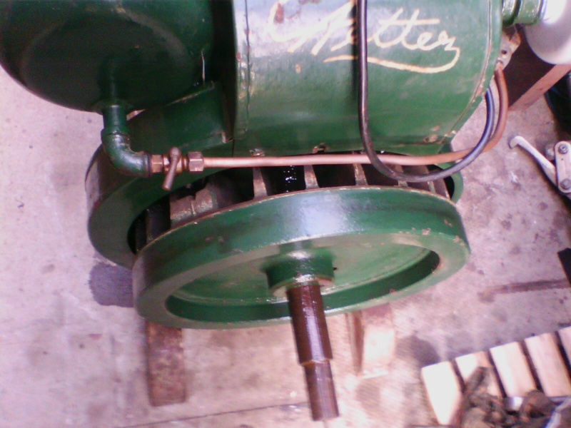

Post by Andrew1971 on Tue Feb 19 2013, 10:37
Hi All
With the flywheel of now. I am not sure what to do !!
Do i keep it as an oil rag resto or Do i do a full strip clean, repaint resto.
This is the one with the extended shaft.
I would like to know what you would do with it if it was your's Smile
Many Thanks
Andrew
Andrew1971
Join date : 2013-01-30
Re: Yet another Petter A1 !!
Post by blackvanman on Tue Feb 19 2013, 10:49
Andrew1971 wrote:Hi All
Many Thanks
Andrew
Personally, and the choice is of course fully yours, I would leave it as is with that much paint on it, whack the flywheel back on, little tune up/tinker and done Smile
Post by stationary stu on Tue Feb 19 2013, 13:03
The paint work looks ok in the pictures so maybe just a tinker to set it up and make a sled or trolley for it. See if you can sort the other Petter and paint that one see how you go.

Post by Andrew1971 on Tue Feb 19 2013, 15:32
Hi All
@Nutgone iam going to go for your idea leave as is .Clean + tinker Smile petter 2 extended shaft one Smile
@Stationary Stu yep i will do the other petter strip clean, rebuild + repaint it is older than the other petter.
Got some gasket's to make bit of playing a new bearing for the extended shaft + see how it all goes. no2
