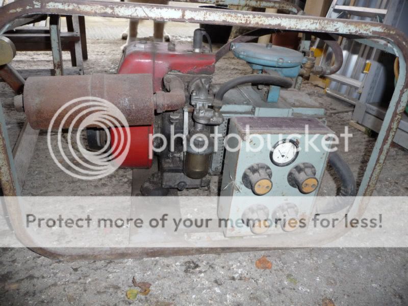

Hi All
This is the first test of petter a1 running on gas here's the link
https://youtu.be/aBWiAsjZYAo
The donor solex carb was buggered so used the top half drilled a hole where the screw with spring was just big enough to poke a bit off copper pipe (brake pipe) through. A length of rubber pipe i had spare + a crappy blow torch used + that's it. I was suprised it actually worked Very Happy Very Happy And now making it better and permanent. I will update the more i do.
Many Thank's
Andrew

Andrew1971 wrote:Hi All
Many Thank's
Andrew
great Smile
although it won't take long for that butane cartridge to freeze Very Happy
Did I hear at the end "Flywheels moving again!"? Smile

Post by Andrew1971 on Fri Mar 15 2013, 14:17
Hi All
Here's some pic's of what's left of the carb all i needed was the top part with the butterfly valve. lurl=http://www.servimg.com/image_preview.php?i=12&u=18093342][/url] That's where that brass screw the one with a tapered end went in.
Drilled a hole all the way through and that's came out.
That's where the gas pipe goes it some copper brake pipe. it need's to be fixed and made gas tight.
Hope that help's with how i have done it
Many Thanks
Andrew
