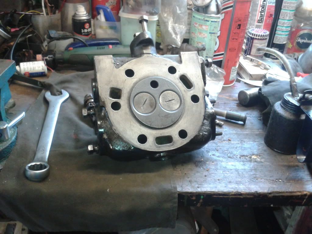

Someone's looking for a new set of rings. They might be good enough to get it running, but they really want replacing. & it's an oversize piston (+.020").
The valves have been pretty over-ground in the past too. There's a fair old lip there clearly showing pocketing. Diesels tend to have slightly more pocketed valves than petrol engines anyway, but these are a bit too far. They should still work, but won't take a lot more grinding.
Will edit this post with a close-up pic shortly, to show what I'm on about.
Apart from that she's a good engine. New set of rings & maybe a proper honing tool passed down the barrel, she should be pretty reliable. It's the usual story though, been a bit butchered in the past, but I've seen a lot worse. the important bits are largely undamaged.
EDIT:
As you can see from this picture of the finished head, the valves sit quite low down in the seats on this engine, as they do on a lot of diesels & older engine designs....
But, if you take a closer look at the actual contact area where the valve seats in the head, there is now a lip, which will protrude slightly over the head of the valve....
It can be seen better even closer up....
Note this pic is of the exhaust valve seat, on the right, after grinding, but the inlet valve seat can also be seen, on the left, before grinding. There is also a lip on this, pretty much as bad. You can see where it starts & how it only protrudes around a certain part of the seat. But it is clearly there.
This "pocketing" tends to happen more on one side, & will cause the valve to seat much slower than it should, & possibly catch on the lip, which will cause it to seat violently, possibly causing more damage.
As the lip is there & the valve has to get over it this will cause quite quick wear on the valve guide as well as there is lateral movement in the valve stem as the valve gets over the lip.
But the main running problem is the loss of compression as the valve seats slower, causing difficult starting & bad running with a loss of power.
It's easier done than people think as well, especially on engines, like this, with valves which sit very low in their seats with such a large contact area (the dull grey band you see is the contact area, this is quite large on this engine, the Kohler has a contact area of between 1/32" & 1/16", very very small, but easily enough to seal in the compression, but that's a different design, with valve that protrude from the head, diesels can't often do this as the piston would hit the valves). A wide band is not necessarily a good thing, as the wider the band, the larger the contact area, the longer the valve will take to seat & the easier it is for the valve to pocket with wear & over grinding. & as many old engine designs have low seating valves, many of these older designs are particularly susceptible to this kind of damage.
So worth taking care when removing metal.
Hopefully this one will still run OK, but it will require seats machining at some point in the future. As it will only run at rallies it could well go on for years. just as long as no one gets hold of it & decides to take a cordless drill & coarse paste to the valves.

Yes, Nutgone and I were giving this engine a good top end clean today. I haven't even had time to offload her from the car yet (got to do that before I can go to work tomorrow ).
Like he says, the rings are a bit sloppy in the grooves and the end gaps are ridiculous! Almost like they've put the standard rings in the +.020" bore
Apart from that and the glazing everything seemed OK so I can't see a reason why this engine shouldn't start now, we even managed to clear the primer tube. I would like to polish the air cell but I haven't got a spanner or socket big enough to get it off
Some pictures for you all:
The block after the top end was removed this morning:
The head dismantled and cleaned:
The bore, part way through de-glazing. I need a bigger hone as this had to be done by hand!
A couple of the injector nozzle before cleaning, no serious deposits but it got a soft brass brush over it and came up well:
Head rebuilt, valves lapped in:
Now I just need to put it all back together and bleed it in again, waiting for a rainy day this week or failing that it'll have to be the weekend.

I had the day off today so I set to work putting this all back together. It went pretty well until it came to trying to start it.
I got her to fire a few times but she won't catch on, then I ran out of energy.
I do worry about those piston rings and wonder if it could be possible that they are causing the problem, there does sound like a bit of hissing under compression and the gaps were massive. what does everyone else think, can sloppy rings cause this much starting trouble in a diesel? It feels like there is plenty of compression, but is it enough?

The thing with piston ring end gaps is, under normal circumstances they mean very little. It's even been proved that staggering them has practically no effect on overall compression, it's just something we do (I'm referencing in part something Andy said on another thread & stuff I've learnt recently by researching piston rings & reading information published by piston ring manufacturers), & when you think about it, it all makes sense, I mean normally it's a tiny little gap, & the compression doesn't have very long to get through this gap.
But your ring gaps aren't normal, they are excessive (& I'm being polite when I say that). Also, as the gap gets bigger it has a bigger effect on the compression loss.
From memory I think the grooves in your piston were OK, so there shouldn't be too much loss that way, which is probably why you still feel you have good compression, I just don't think it's quite good enough to start this engine.
Perhaps best to get asking for some accurate ring sizes, get in touch with a ring seller/manufacturer & see if they can cross reference them with anything in stock (unless you can get a reliable cross reference from someone on one of the forums).

Ian a diesel has to have good compression to run but I've had cars in the past with very low compression but you can still normally get them to start, in fact I've never had an engine not start because of compression. (they'll start somehow) I've had vans that had to be tow started to get them turning fast enough but once running you'd never think there was a problem. Also if the heater plugs on the older Mercs didn't work then no way would they start even towing them yet give it a sniff of easy start while it's turning over and shes away. The strangest thing is once warm they will stop and start great all day, so that bit of heat must give it expansion to create more compression (but not sure if that's the correct answer).
Ian have you not got another engine you could belt it to and see if it will start like that, it could bring other problems to the top, it might be timing is a touch out etc.

Could belt it up to the Scott, but we'd need to get some flat belting. Also, not sure there's anywhere to put a belt on the Coventry Victor???
Re: Coventry Victor Diesel
Belting to another engine could prove tricky at the moment, I might try some flame gulping first, see if that does the trick.

Ian turn it over as fast as you can and give it a sniff of easy start, could be the easiest way to see if it's going to run or not, then that should answer some of your questions. There's a few ring suppliers in the Suppliers section on the forum or Turner and Cox are not that far from you.
