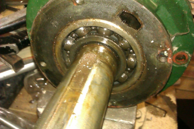

Running Ed's D type at Westlands on Saturday, I was looking at her and thinking, that flywheel's not running true, I shut her down as Ed was busy running the food stall, and had a look, sure enough there was around 50 Thou of play on the crank main bearing, "oh pooh, no more running for you today"
So today as Ed has no workshop as yet and won't time to do anything with me on it for a while, and it would be a shame if he couldn't run her next week, I picked her up in the van and brought her here for a transplant.
The crazy thing is it only took me 1hr 15m to do the following including unloading, mind you, 30min of that was getting the gib key out lol.
The offending little beggar
Going to take the bearing to my local supplier tomorrow in the hope they may have one on the shelf at a sensible price Smile
Then with any luck she can go back together again ready for next weekend Smile

Have the bearing in my hand now, have got an up rated sealed bearing for two reasons, one its what they had in stock, two, looking at the build design of the D being splash lube, there is only a hole below and to the side of the bearing and the other bearing was dripping in oil where as the outer (this one) had very little oil present, with the sealed bearing this will never be an issue, you could argue its gone 60yrs like this but hey ho lol.

new bearing seated
Crank shaft back in and bearing carrier re-fitted to the block
Won't bother with pics of the flywheel back on etc as they are already covered above, all in all it could have been a lot worse, play has been completely overcome as would be expected with a new bearing having just been fitted Smile. Just need to get the wheels/handles back on the trolley and load it back on the van on Sat morning Smile
