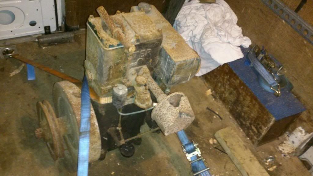

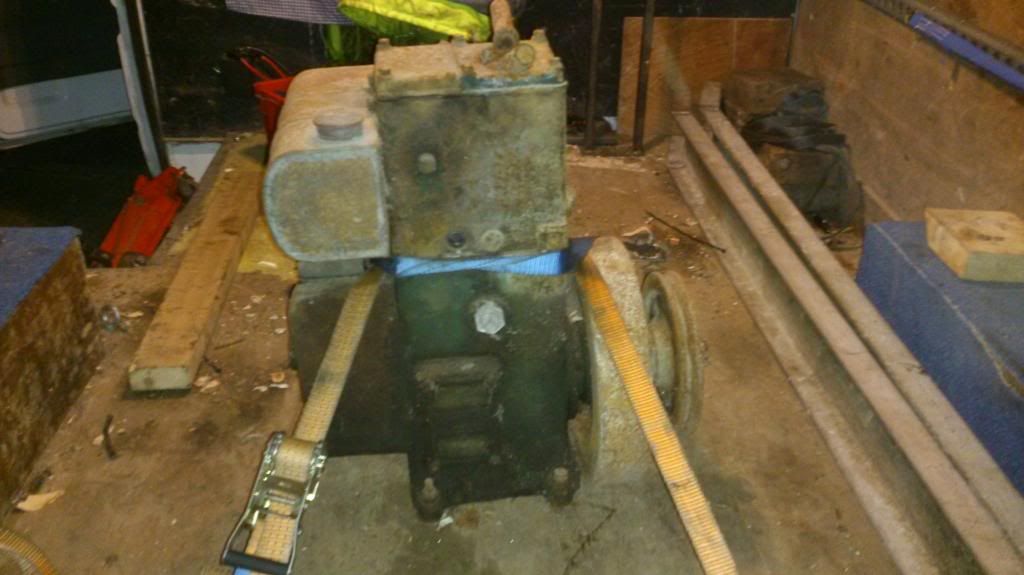

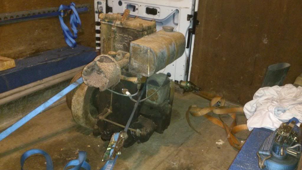

My mum put me onto this one .
The farmer my mum works for as a cook / carer for who are in there 90's the wife has a cousin who has shares in a big dairy farm . My mum was saying about i collect old dairy equipment have you got any bits hanging around ? He had an old engine that was his dads , he gave my mum his number .
So i phoned up and had a chat with him , nice enough but very straight laced chap , called in today and i expected was a lister D as Lister wroughton plant was 100 yards up the road . Well it was indeed a d type . Complete and was last run around ten years ago before his dad died . It had alot of sentimental value to him but he said i might as well have it as it will just sit in his shed doing nothing , so rather someone take it and enjoy it . So i shook his hand and handed him £30 ! Loaded it in the van and there it is .
Some pictures
Dont come more untouched than that ... I think the plan will be to go over to dads on monday and he will give me a hand getting it on some skids . then i can get it out of the van . and get it sat somewhere if i have room or on the patio and give a libral coating of diesel .

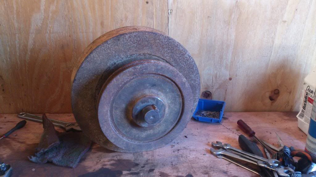

Oh and the crank and flywheel assembelly . ~Got the 2 grub screws out of the v pulley , but now i have to get the rest of it off ... Do i give it a soak for a while and try pressing the crank out of the v pulley 1st ?
Or get some heat and a puller on it ? Or make up a slide hammer to see if i can get the key out 1st ??
Not sure which best way to go ...
