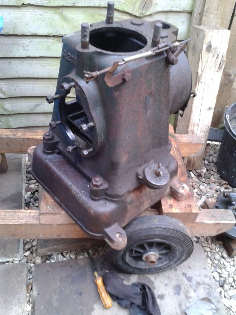

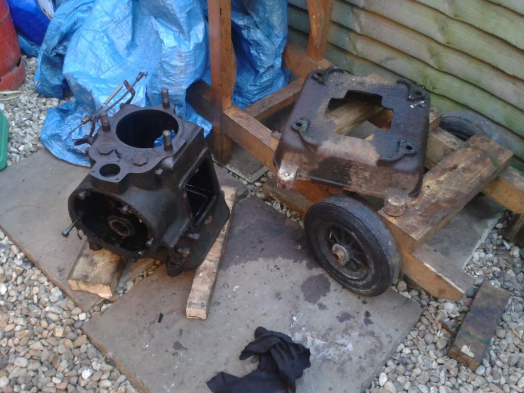

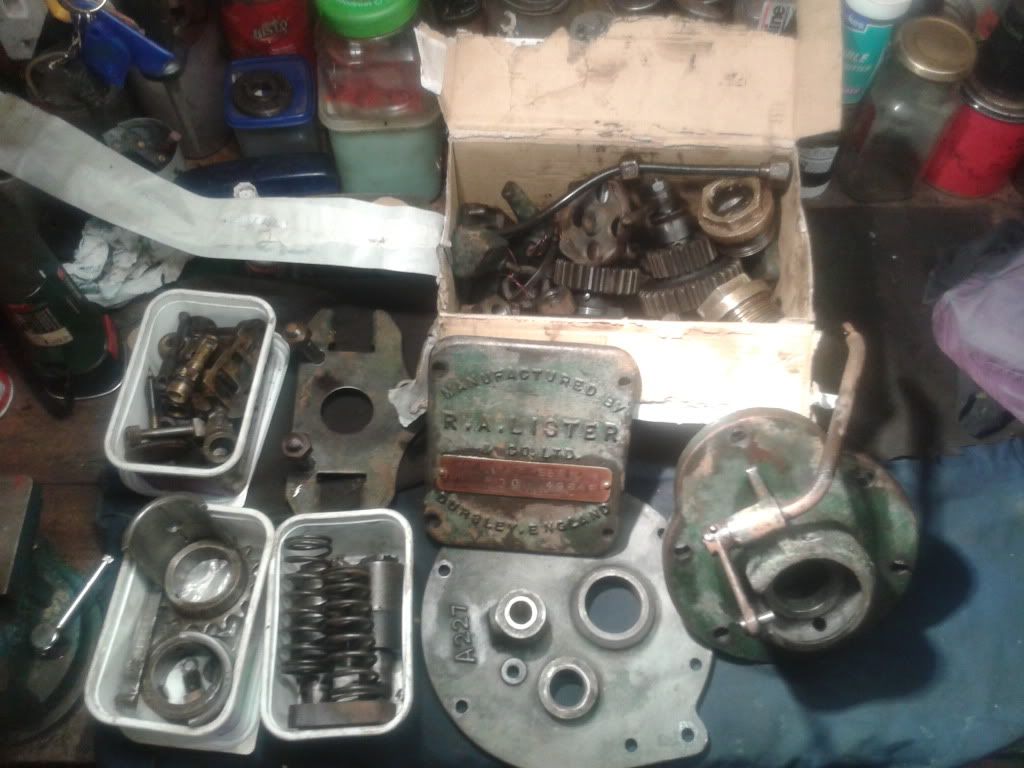

Right, so despite all the work I've been doing on the Ruston 6PB this weekend, there's also been quite a lot of progress made on this one too.

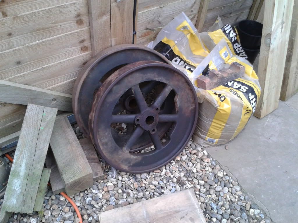

Saturday I had a couple of visitors over who had a go at the stubborn flywheel for me (flywheel number 2 as it turns out). Well within a short time they had the gib key out for me & were then looking into the removal of the magneto drive sprocket. I made myself useful & went off to make a pot of coffee. By the time we'd drunk our coffee & eaten a few biscuits we had the sprocket off as well. The rest of the afternoon was spent sitting in the sunshine, playing with the cats & chatting about engine related stuff....
Later that day I decided to carry on with the Lister a bit & I managed to get both crank case side plates off, along with the timing gears. I was very surprised to find just one cam on the cam shaft (no one told me about that either), & that there are 2 followers, each profiled differently to give the right characteristics. I've got a sneaking suspicion that the Lister D also has a similar arrangement, but I haven't confirmed this yet (keen Lister enthusiasts will notice a missing nut on the end of the fuel pump lever shaft, despite this not being present the shaft & key are still in good shape)....

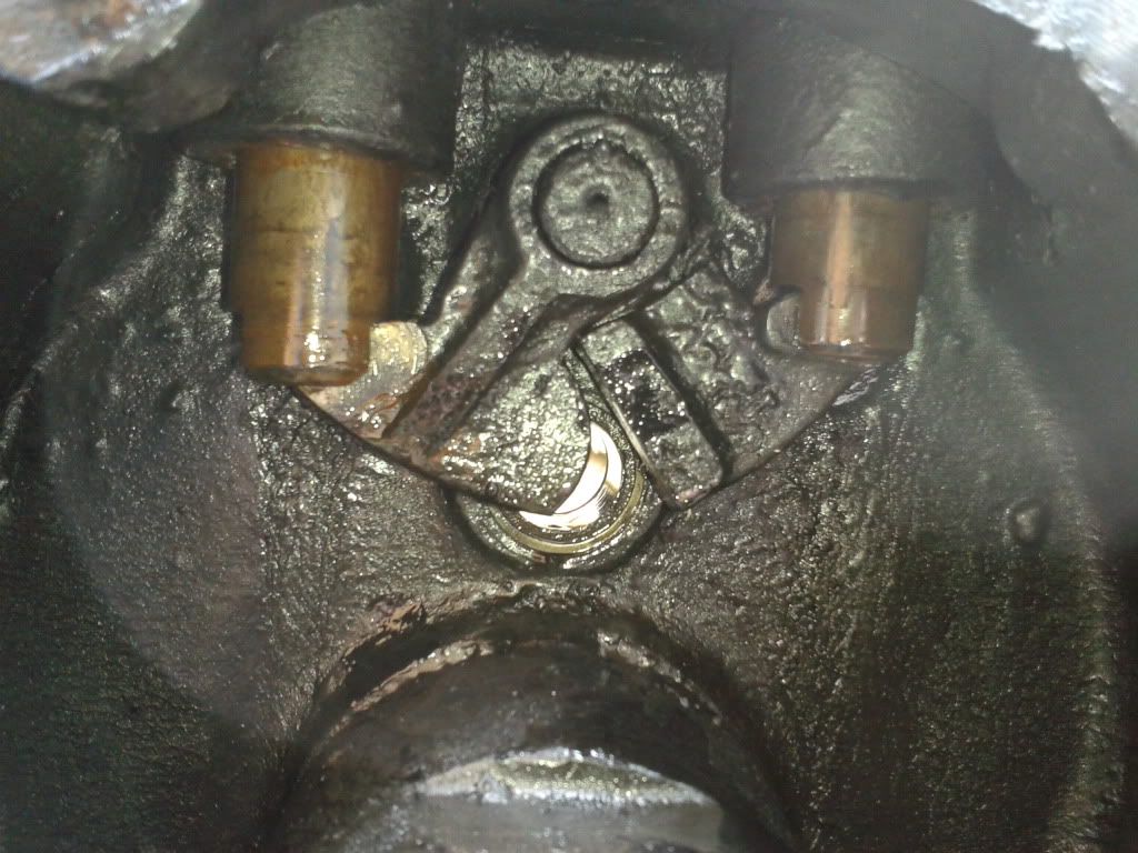

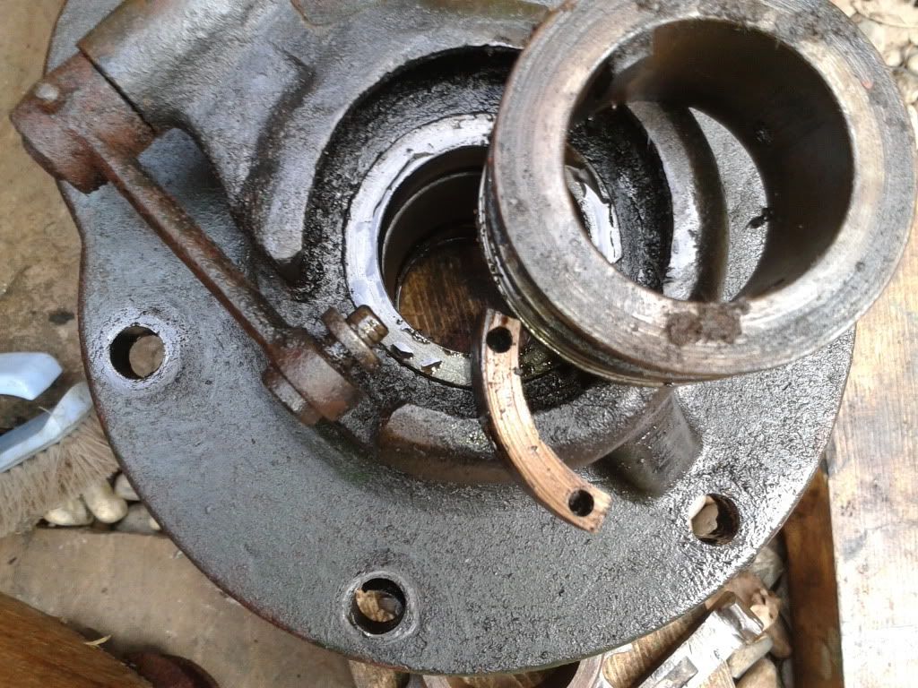

I also removed the governor sliding collar & took some pictures to aid with reassembly....

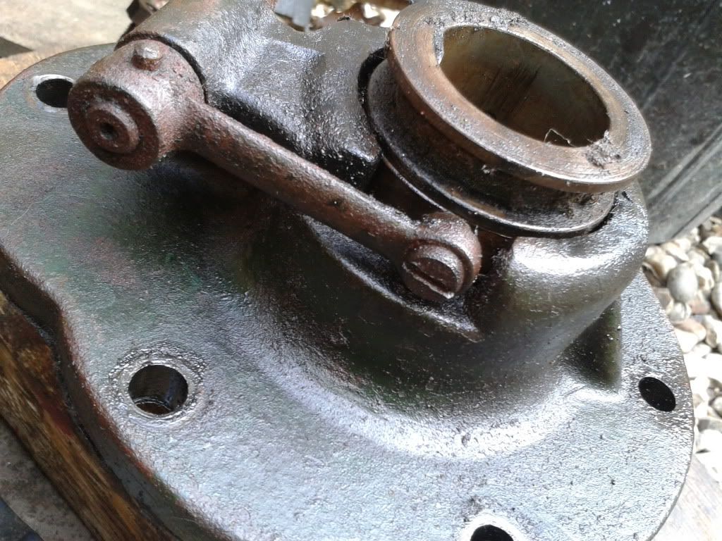

So I had an empty case, except for the crank shaft, but I still had an obstacle in my way, namely the camshaft drive cog, which was still stuck on the crank shaft....
I left this for another day, but as it turned out I got all the reassembly & priming of the little Ruston Hornsby done in reasonable time this afternoon, so that "other day" was today (Sunday).

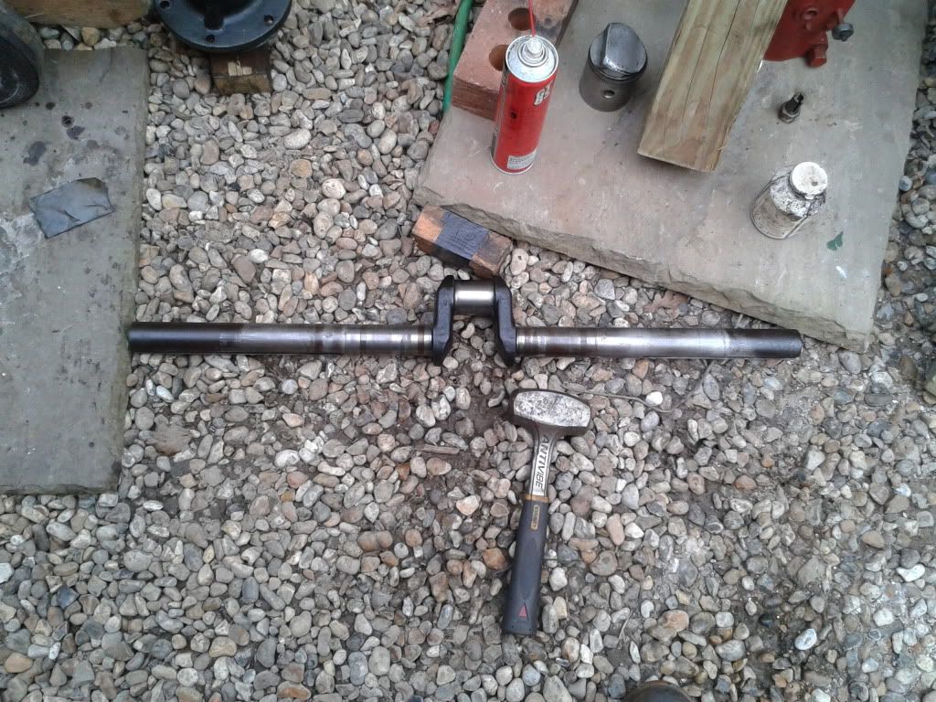

I assumed this cog was a sliding fit with a small woodruff key, much like the magneto drive sprocket. I did have ideas of hitting the end of the shaft to drive it through the main bearing, leaving the gear behind, but I didn't want to damage the bearing with the woodruff key, so I managed to get it moving with a pair of tyre levers & eventually got it off. It has a very small woodruff key, like the magneto drive sprocket. They seem very small for such a large engine, but I'm told these very early models had these small keys on them (I'll have to get a pic of that).
Then it was time to remove the crank shaft. I thought something else must be holding it on, as it really didn't want to budge. But after some dressing with a bit of wet & dry paper & plenty of GT85 (& some gentle persuasion) I managed to get it out to reveal a nice empty crank case....
Then I went in & had dinner, after which I came back out & decided it was time to reduce the weight of this lump even further, so I removed the crank case from the cast iron base....
It was beginning to get dark by then, so I drained the oil & put it to bed. Then I went inside the workshop & had a play with the barrel. I had been lent a set of valve seat cutters, so I used them to clean up the valve seats a bit, then I got bored, I was looking in the water jacket & thought to myself "I wonder what my chances are of removing that threaded plug....
Well, with a half inch spanner & a couple of taps of the wrist, I couldn't believe it, it came straight out....
I never thought this engine would come apart so easy!
Next I've got a mountain of parts to clean, & that crank case to clean out as well (not really looking forward to that one, but it's got to be done. I will pick a day & just attack it, get stuck in, then it's done).
The next big job is the piston. The gudgeon pin is still pretty tight in the little end, I don't think I should try & remove it just yet as I think it would risk damage to the piston (so did my visitors on Saturday). It's soaking in easing oil solution & slowly freeing off. I will see about making up a removal tool for it. If it needs to soak for another fortnight then so be it, I'm not going to rush it, I've got plenty else to be getting on with, but the Ruston's coming to a standstill for a couple of days after tomorrow, so I will get busy washing those parts, as & when I can.

Right, I've got a little pic of the crank shaft to show those small keyways for the mag sprocket & timing gear....

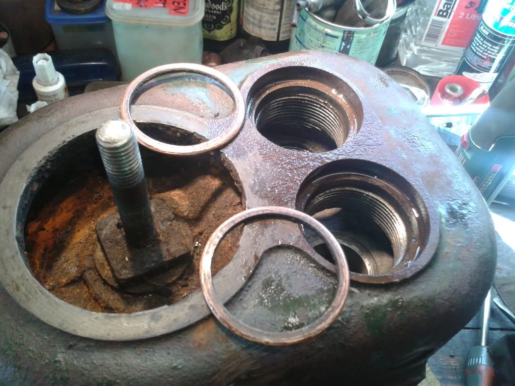

Today I found the long lost copper/asbestos ring gaskets for the valve plugs in the head. I managed to get them both out without damaging them....

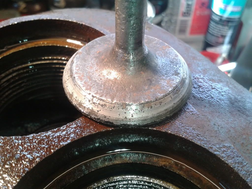

I've been playing with a valve seat cutter which was lent to me, but I'm not too sure about these seats, so I took some photos of them (I think I may have had a go with a valve & some grinding paste on one of them before this pic was taken, but I can't remember)....

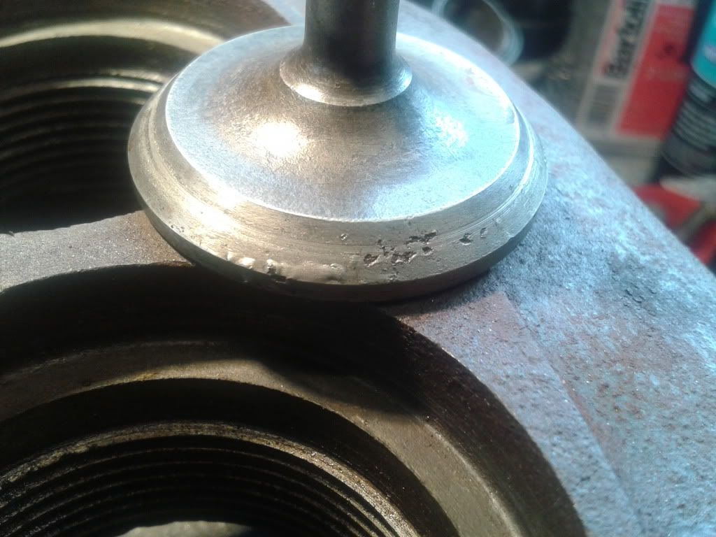

Now, the exhaust valve is brand new, doesn't even appear to have been fired, but the inlet valve is a different story. I've had a go with some valve grinding paste, both coarse & fine, as it was badly pitted (& it's a big valve), but I still think it may want a little skim on a lathe....

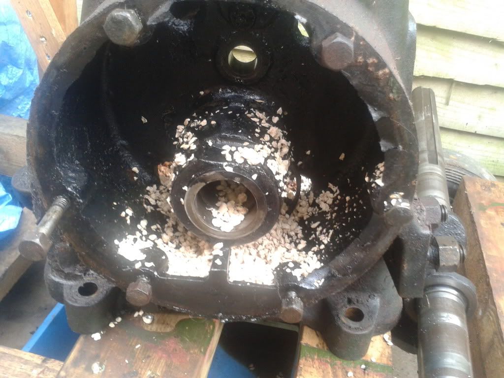

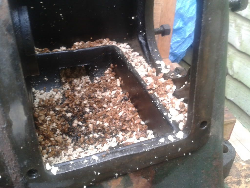

I've emptied what oil I can from the sump & thrown in some absorbent granules to soak up the worst of what's left in the various oil troughs & traps. Now I just need to build up some enthusiasm to get on with the mass clean-up.

I had another go with the valve seat cutter & put a bit more effort in to it this time & I'm quite pleased with the results (it seems the surface of the seats has work hardened slightly, but once I was through that the cutter really started to bite, so I eased off a bit, as you only really need to scratch the surface with these)....
I've also had a look at the new(er) valve & there appears to be a little damage, so I think I will have both valves re-faced on a lathe....
The rest of it is very good, but that particular area really needs some treatment.
I've also thrown some special, wood-based, absorbent granules in the crank case to absorb the old oil, so now I can just scoop it all out & throw it in the bin....
Yes I know it looks like cat litter, that's probably because it is, but it's no ordinary cat litter, it's some special stuff my mum bought a load of, only to find our cats didn't like it. It's not like the other wood based one which is compressed pellets of dust, this is much more like the oil granules you get in garages. In any case, the whole thing's going to be cleaned out, so any & all traces will be removed during cleaning.
Also, I can confirm this stuff was straight out of the bag, no little cat presents in it for me Very Happy .

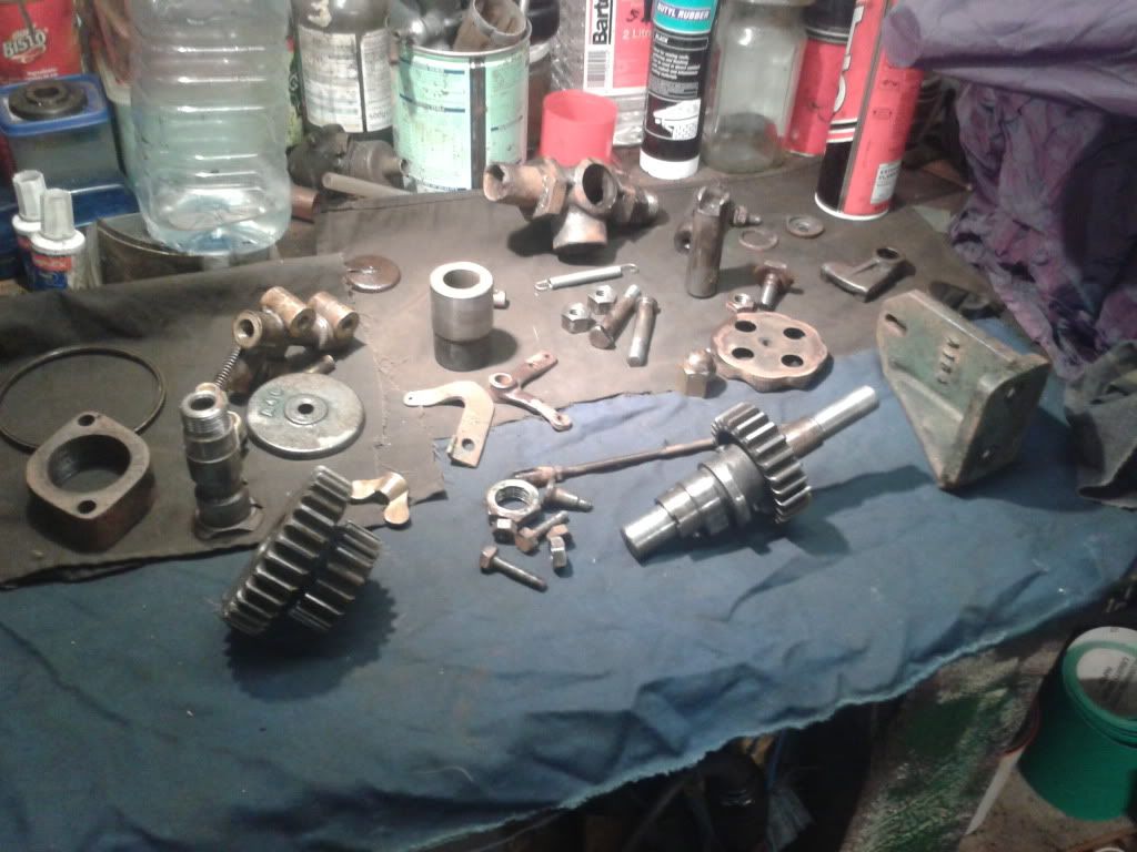

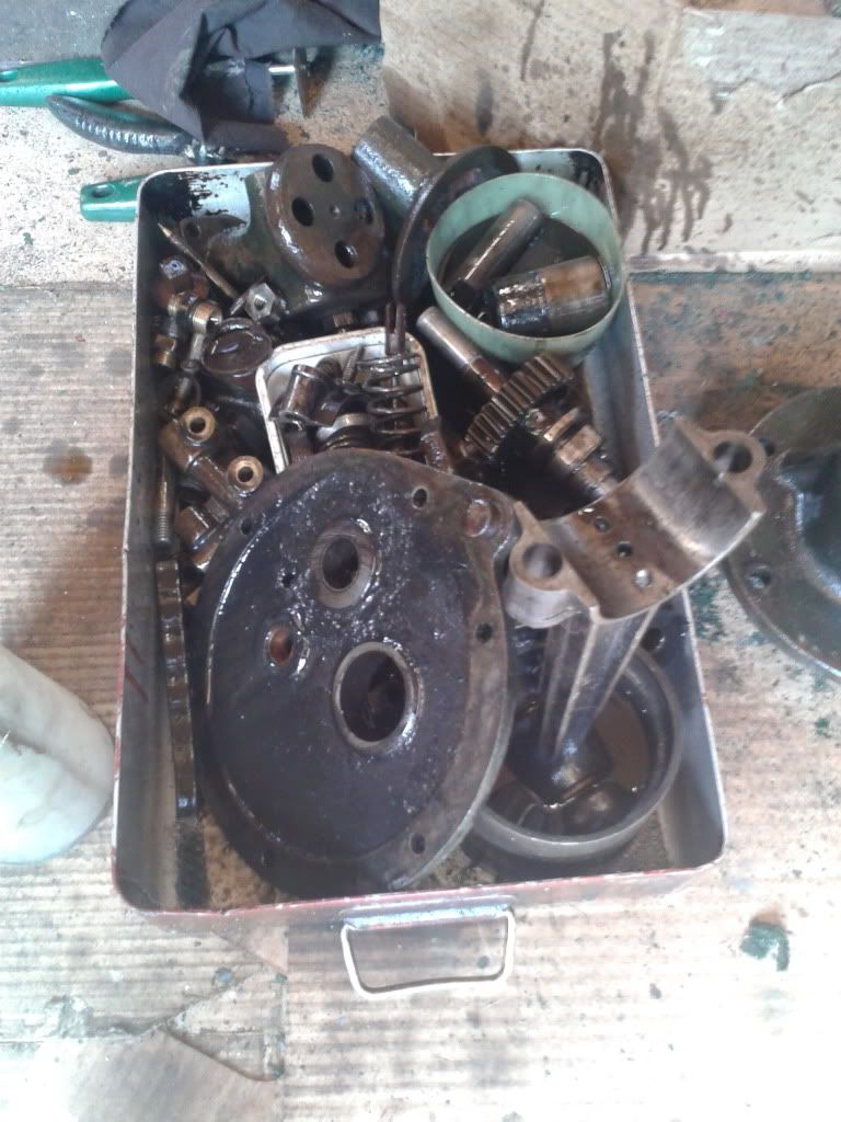

I've been doing a little bit more tonight. I was in the workshop (nothing on TV as usual) wondering what to do when I saw the big tray of bits to be washed, so I thought I'd better get cracking.
First lot through the parts wash (it's all been rinsed with brake & clutch cleaner, which dries off all traces of oil, which is why everything looks a bit rusty. For some of these bits this will be enough, but for most this is just the beginning)....
I did a load more after that, now most of the really small stuff is done (see, didn't hurt. One evening out there, by 10:15pm it was done), but there's still the crank case & the various plates to clean, & I'm sure there's a few more small bits in a box, but I chose to ignore that for tonight Very Happy .

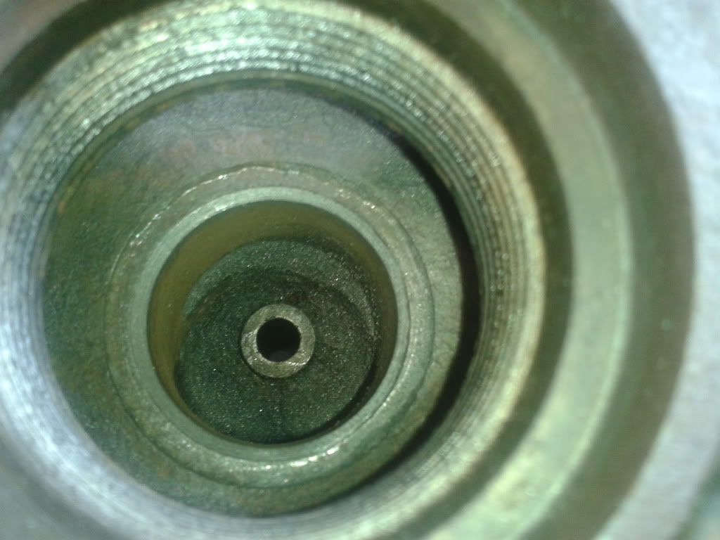

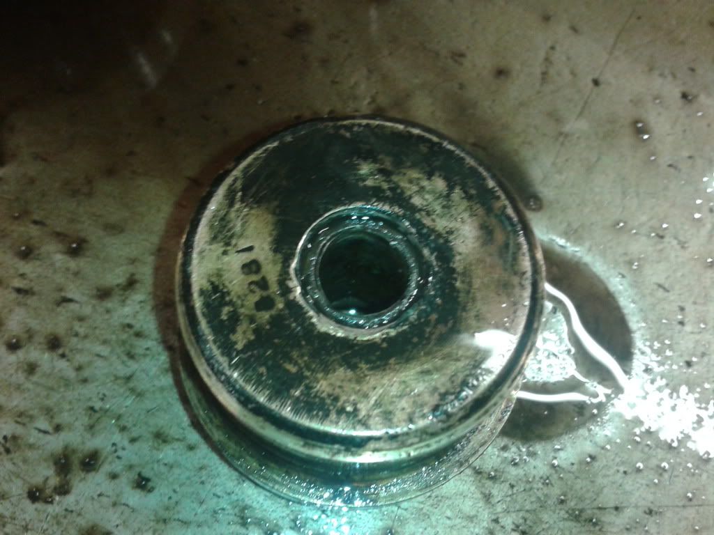

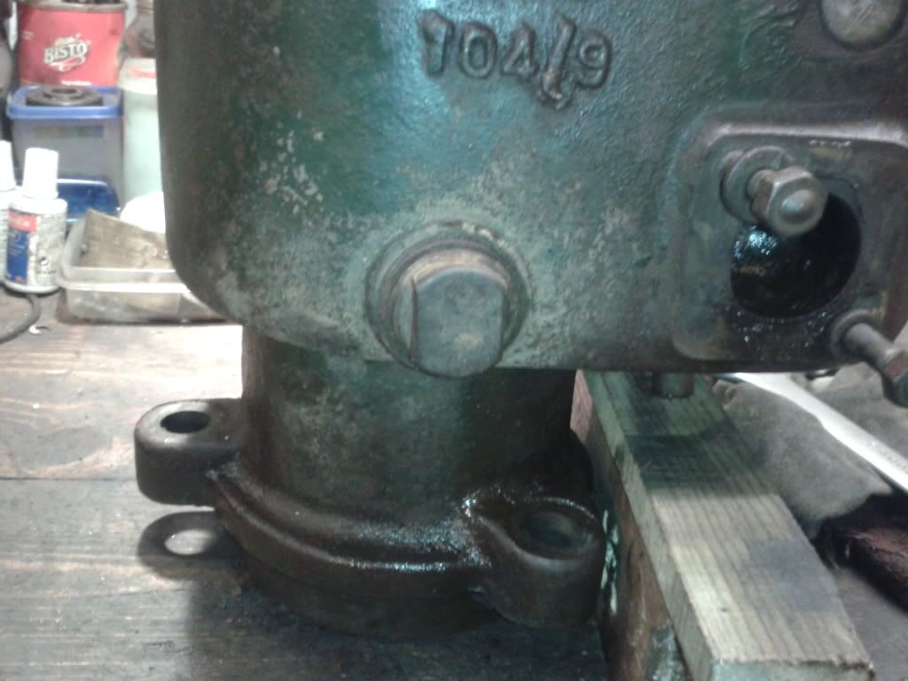

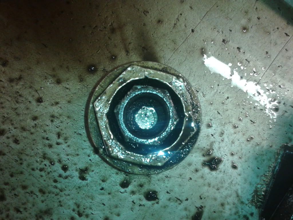

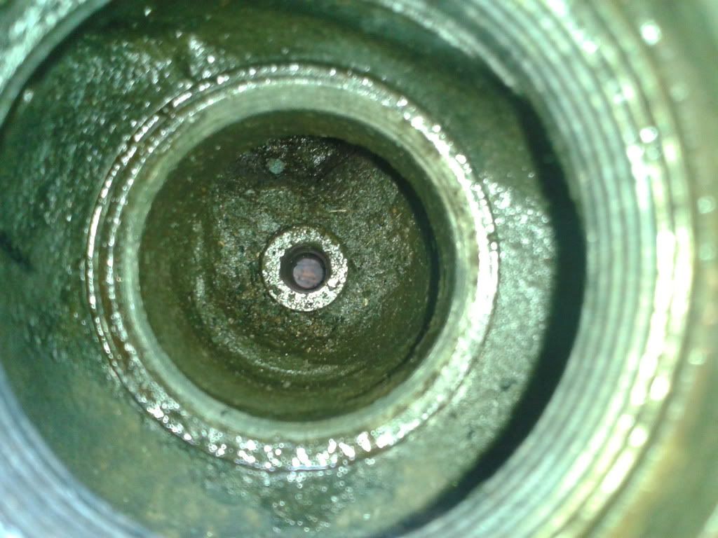

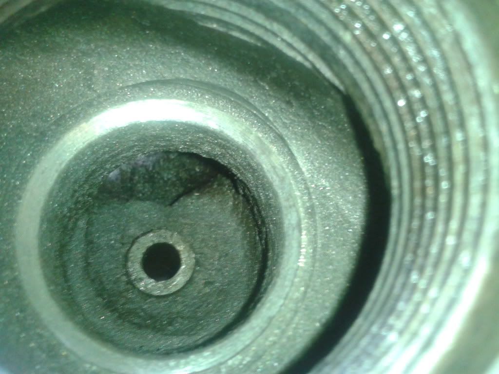

Now I've got another little problem (not bad going really, it's just this & the piston I'm stuck on, & the piston is looking better). One of the valve plugs, from the head, contains the spark plug. The problem I've got is there is part of the spark plug still in there & it won't come out. It's the bottom half of an old detachable plug, & it's really well in there. Here's some pics (it did have 3 earth electrodes, but I've since drilled through those with my biggest drill bit, which is a 13mm, I think)....
Top....
Bottom....
It's not the easiest thing to get a socket on & my sockets are just too thick walled to slip down in there (I have 2 though, so might grind one down a bit on the bench grinder), but I have had a socket on there, with a long bar (about 3' long I think, it's a big bar anyway), but I couldn't get it to budge.
Like I said, I passed a 13mm drill down through it, but I'm not sure what I was hoping to achieve. I would like to drill it so the wall of the threaded part goes really thin, then perhaps go from there, but my drills run out at 13mm. Maybe I should order a bigger one, I dunno, I don't want to damage the threads & drilling is really a last resort with these things I reckon. I suppose if it did become damaged I could bore it out & make up a threaded sleeve to go in there, but I'd rather it didn't come to that. Not sure I can get a hacksaw blade in there either, maybe a junior hacksaw blade, but they're pretty useless, & again I'd need to be careful not to damage the threads.
For now I've got it soaking in my easing solution after cleaning out as much crud as I could, to give it half a chance.
Any ideas???

get the welder out and weld a bit of bar on, the heat will help loosen it and the bar gives you something to grip.

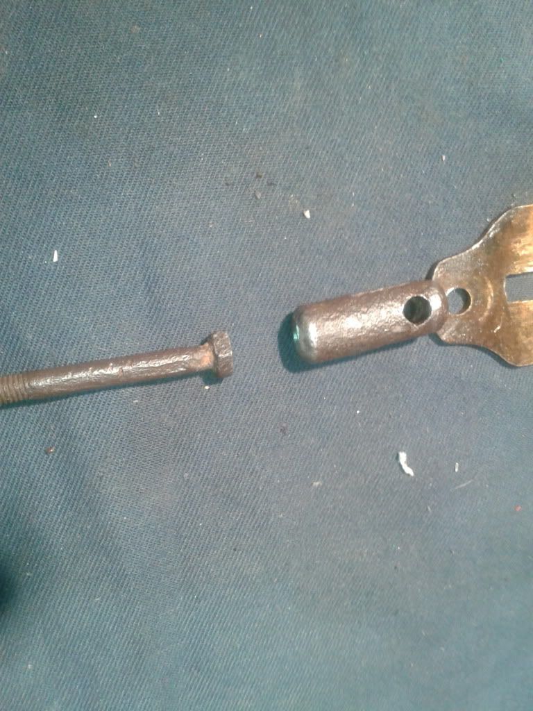

I've also done a bit more parts washing & managed to snap the end off one of the throttle control rods ( Embarassed Mad ), but I should be able to repair that & still keep some form of adjustment on it.

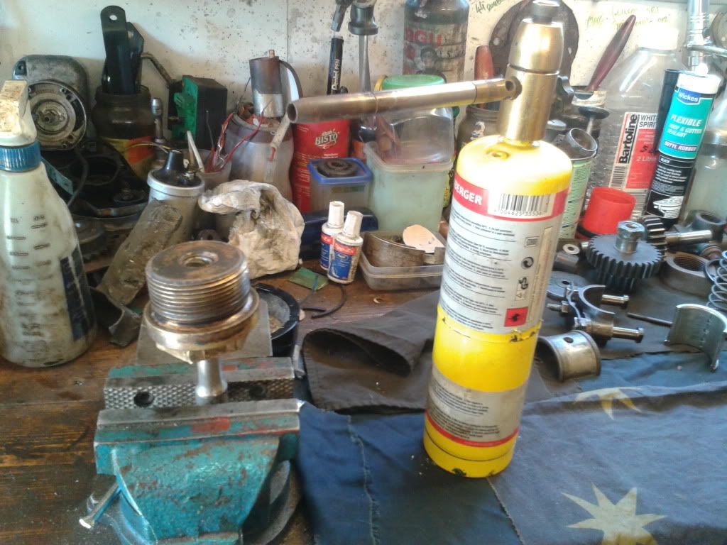

Right, so to remove the spark plug I started off by cleaning up the valve cap as best I could, then put it on a piece of bar, which was stuck in the vice. This was so I could heat it up with the blow lamp....
Then I found myself a 9/16 Whitworth socket & shaved off a bit from the outer wall on the bench grinder, so it would slip down beside the remains of the spark plug....
After heating the brass plug (I could see some of the left over easing oil bubbling up through the threads) & letting it cool slightly I applied some more easing oil (whilst it was still hot, but not so hot as to ignite the easing oil) to get it down in there, then I secured the brass plug in the vice (handling it carefully, as it was still hot) & I took my long 1/2" drive bar to it....
I had to secure the nut flats of the plug in the vice sideways, with the left over spark plug facing into the jaws. I got the socket on there & gave it a few tugs from the end of the bar (for best leverage). It started to move, but looking at the other end I couldn't see corresponding movement, so it was obviously twisting in there, although it was moving a little. This was where I realised it was a mistake to pass the 13mm drill through there yesterday, as I had undoubtedly weakened it.
I carried on with jerky movements (always better than a long straight pull on something) & sure enough it started to move. Eventually it came out....
I'm glad it was a long bodied plug, if it had been the usual 8COM I doubt I would've got the socket down in there.
Now I just need to get a thread chaser to clean it up a bit. It might be fine, but I prefer my spark plugs to go in & out easily, with no stiff spots. That way you know they're in without having to over-tighten them.

I have some throttle rod spares in my box o bits nutts .
Cheers Matt, I will post up a pic of what I've broken. I started to drill down into it with the idea of joining the 2 bits with some M3.5 screw stud, I was doing really well until I snapped a 2mm drill bit in there! Obviously it won't just tap out & is broken well below the surface, so it will probably need to be welded, unless I can find suitable replacement.
I'll take some pics tonight.

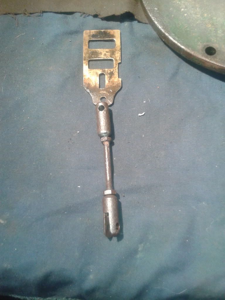

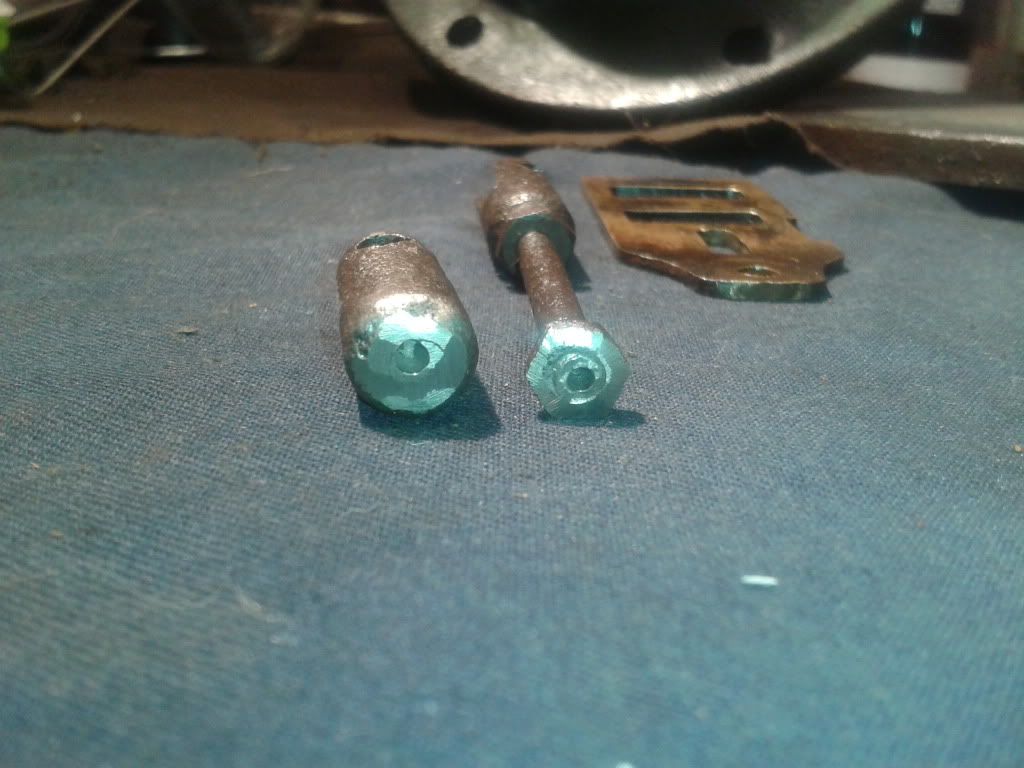

Re: Nutgone goes all Lister! (Lister A tank cooled project).
Post by nutgone on Tue Apr 23 2013, 21:43
Here's some details on the bit I've broken (don't know why I messed with it really, but it went so easy I couldn't believe it! Embarassed ).
It appears to be the shortest of the throttle control rods. It's the final rod in the linkage, which connects to the throttle slide plate. Trouble is not only would I need the rod, I would also need the end which connects to the throttle slide (it's just the same as all the other rod ends, so nothing special, but the one I have has got part of a 2mm drill stuck inside it)!
Here's a pic of the rod, laid out with the end pieces & the throttle slide....
Here's the bit that's broken....
& here's the ends. You can see where I've started to drill, originally just in the rod end piece to try & get the piece of rod out with an easy-out, but then in both halves to try & cut a 3.5mm thread & join them together as I realised the broken piece of rod was not going to come out. But the drill snapped off in there, so then I cleaned them both up ready for welding....
The thread on the other end is still fine, so if I did have to weld it there would still be plenty of scope for throttle adjustment in the future. So if it can't be replaced, it's not the end of the world.
Also I've been busy again tonight cleaning up more of the small bits & bobs, & some of the not so small pieces....
Apart from a few nuts & bolts left in the crank case that's about all the small bits done. I've got the mag chain soaking, but I think it will need a new one. Also the piston is still soaking, but it's slowly easing off a bit, & I've still got to clean out the carb.
Talking of the carb, I've had one go at it & managed to remove the pipe unions, but are there any special tricks to getting inside & giving it a really good clean??? I'm thinking about making up one of those electrolysis tanks to remove rust but not attack the metal, I can't see any other way of getting right in there to clean & de-rust it. I suppose it'll still work & most people just do their best. Maybe I'm being a bit too picky???

I think i can help you out there with the slide rod il have a dig around in sheds ... Those rods are allways a nightmare 1 of the joints snapped off on the D type ... there so delicate its easy to snap them ... at least they can be made or obtained easy enough .
Post by blackvanman on Tue Apr 23 2013, 22:29
well done mate that's almost what I was going to do, but I was going to mig a bit of flat bar onto the spark plug to hold in the vice, then fully warm the brass plug and unscrew it. Smile
