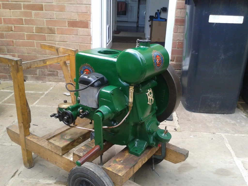

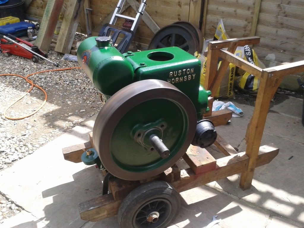

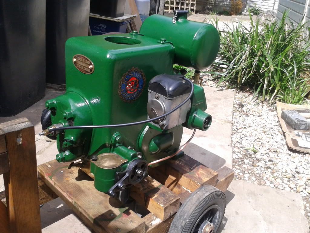

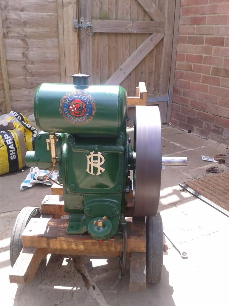

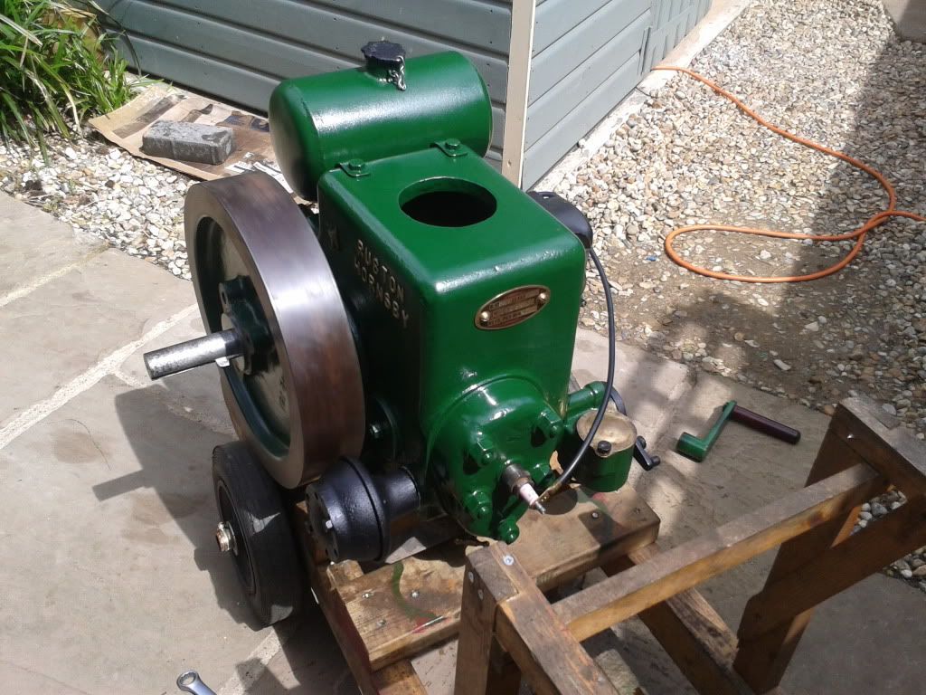

Here's a few pics taken today, I will say a little more tomorrow as it's a little late to be typing an essay here now....
Enjoy .
Enjoy .

Very very nice Matt If Brian doesn't like that I'll give him a kick!
Thanks again mate for doing it, that really got me out of a hole.

Well done Nuts another cracking job mate. Only thing I'd do if it was mine is give it a few coats of clear lacquer to get some depth and a good shine.
Nice job, well done Nuts,
Re: Ruston Hornsby 6PB
It's got 3 coats of lacquer on it, sprayed on though. It needs to harden for 2 weeks then it can be polished.
Oh..... I thought it would have a little better shine in the sun light, maybe once everything has hardened off it should shine ok.
It's got that kind of orange peel finish you get with spray finishes sometimes, seems to show up worse on camera. But once the lacquer has completely hardened off it can be polished. It only seems to have done it on the tank though, maybe because it's not a flat surface? I don't know.

I still wasn't quite happy with the finish on the tank, but after 2 weeks it can be polished, so will look better in time. Trouble is, as it was for someone else, I was being ULTRApicky!
The lettering was all picked out in gold, & it's only the 2nd engine I've painted lettering on, so I wasn't sure how it would go, but I was actually quite pleased with that bit. I'm going to pick out the lettering on the Stuart Turner now as well, but I will do that in black I think. (might do a poll of different colours on the thread, let you lot decide).

Since its return, the 6PB has had a little titivation not that there was anything wrong with Nuts work but a few bits that needed finishing off. The drain tap given to Matt wasn't really suitable, so some pipe work was added and a better taper type tap fitted. The fuel pipe rather snaked its way between the tank and the carb so that was realigned and the nasty bit of araldite removed to reveal, as suspected, a broken solder joint. This was repaired and the whole lot refitted. I wasn't happy with the globs of oil appearing on the inside of the flywheel, so it was removed and the new felt seal inspected. This wasn't thick enough so wasn't compressing and making a seal. Fortunately I had some felt strip and this was cut and fitted and the flywheel temporarily refitted further out on the shaft. Now the inside edge has received a real beating with a hammer and this had left little high spots on the corner of the rim. I could do nothing with the hammer marks but ran the angle grinder with a sanding pad to remove the high spots with the engine running, finishing off with emery paper. Flywheel refitted, pulley fitted and it was just a case of going round with the small paint brush touching in any chips or added bits. Finally it had a good run for about 1/2 hour.
