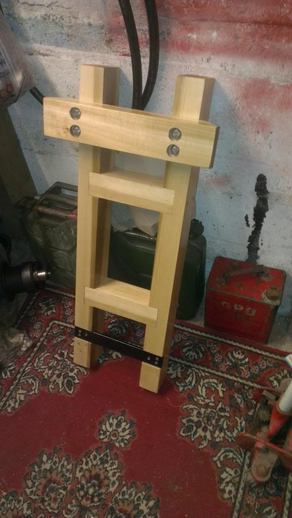

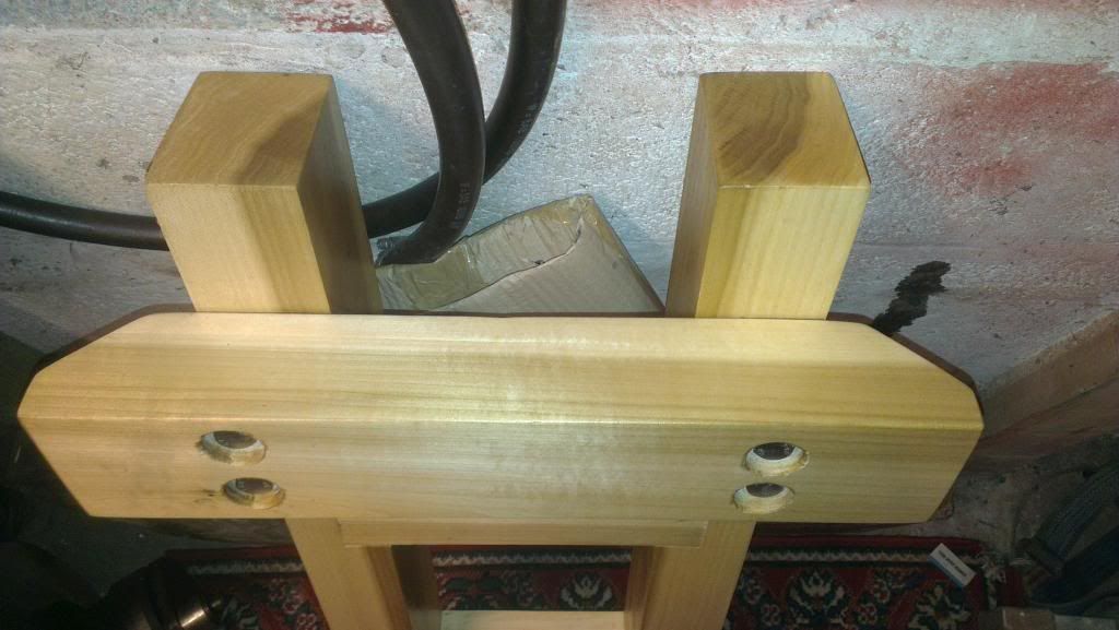

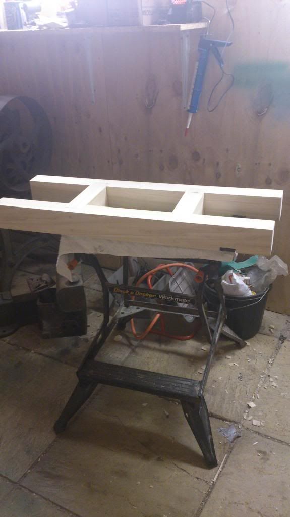

after a while i have got so fed up with the trolley i made for it when restored it i have decided to make one thats better to steer like a american style where axle turns under the frame .
So have made a start from some 3 x 4 tulipwood
a few pictures

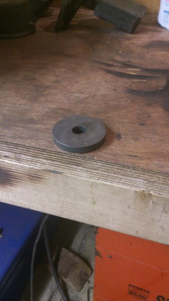

The steel disc will be welded to the turning axle for a turntable which will be greased and nice and thick so no fear of anything bending .
Sanded it down today , just need to get some danish oil and give it a few good coats with it .

lovely wood youve choose there matt
hows the dusting going Wink
love the joinery too mate showing me up Crying or Very sad

Post by matt86 on Fri Apr 26 2013, 07:18
Cheers kev
Its just practice as my dad is a chippie well a self taught one so does it alot for his job , so he taught me alot of times its just practice . Much easier doing joints in hardwood than softwood .
dusting yeah it everywhere over the D bits ... Rolling Eyes

Post by stationary stu on Fri Apr 26 2013, 11:24
Nice lump of tree Matt should look good with the Danish oil covering it. So don't forget to take a few pics once you've oiled it up.

Post by matt86 on Fri Apr 26 2013, 13:10
that's what il be doing next Stu, it's all sanded down smooth as a baby's bum . so il try get some over weekend.

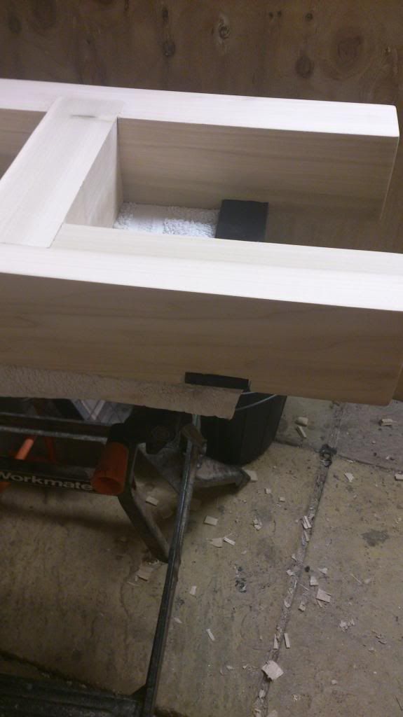

Ian the jointing process was done using a router and i find thats a much neater job , I keep borrowing my dads trend one . Think i need to dig deep and buy my own , verry useful tool , and if make cabinets extreamly handy for the grooves etc .

I'm thinking of attempting my own mortice and tenon joints with nothing more than a set of sharp chisels, a couple of decent wood saws and a lot of patience. It won't look as clean as that job you're doing there but as long as I take my time I reckon it should be OK.
Re: Lister A trolley re make
Post by matt86 on Mon Jun 10 2013, 17:48
Ianhw77k wrote:I'm thinking of attempting my own mortice and tenon joints with nothing more than a set of sharp chisels, a couple of decent wood saws and a lot of patience. It won't look as clean as that job you're doing there but as long as I take my time I reckon it should be OK.
nothing wrong with doing the joints by hand , i have a nice set or irwin chisels and a wet stone to sharpen them , nothing worse than a blunt chisel .... ends up splitting the wood in some cases . I jointed all the rafters in the shed with that set i bought just for the job .
just mark up your lines and saw the outside lines to the depth and then lots of cuts between the outside cuts , that way have lots of small chips being knocked out rather than big chunks and a risk of taking too much out .. Sorry if im telling a granny how to suck eggs here Embarassed

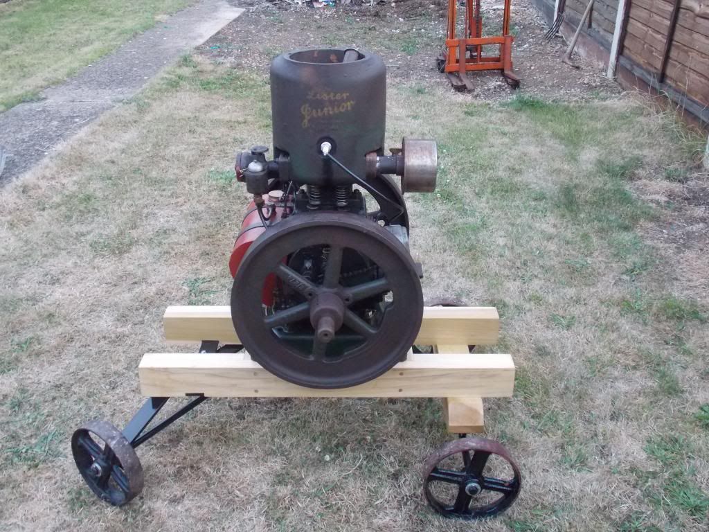

Right lads with everything on over the last month ish i have been too busy to finish of the trolley . Well i have finally got the trolley done and the engine on the trolley . All i need to do is to make a handle up for it , superposed to be taking it out this weekend , so i better pull my finger out lol! lol! lol!
All joking aside i walked away for 5 minutes and some scouser nicked my bloody wheels !

Post by Matth92 on Thu Jul 18 2013, 20:46
It looks a bit overdone for that grotty old Lister, Look boys he aint even bothered to paint the engine!!Twisted Evil
I remember when I used to paint all my axles and wheels etc, don't bother these days!!

Post by matt86 on Thu Jul 18 2013, 20:58
Matth92 wrote:It looks a bit overdone for that grotty old Lister, Look boys he aint even bothered to paint the engine!!Twisted Evil
matt stop swearing at me "paint" spit spit ... only reason why i paint the wheels and axles as made from new steel thats unpainted and stop it rusting ... Tell you what aerosol enamel paint is great give it 1 coat on a warm day and dies lovley with good protection and not much hassle
