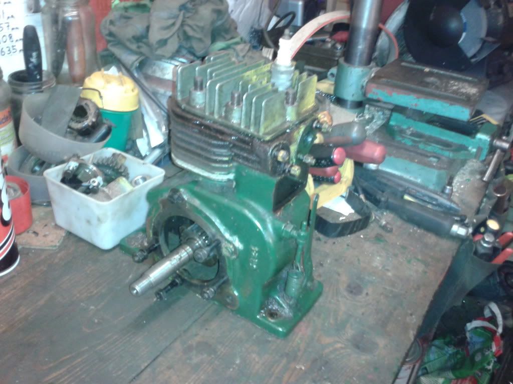

So, onto the green one. This one has a distinct rumble when spun over by hand. It also has no compression whatsoever & the oil is in a right state. There was also no spark from the mag on this one. So I decided to strip it down last night.
I got the cowling off, got the pump off (eventually) & got the sump off, big end apart & governor gear removed (so I can now stand it on the bench on it's open base without risking damage to the big end dipper or governor gear, which normally protrude into the sump). The rumbly bearing is the one on the output side of the crank shaft, & wouldn't be that difficult to replace, but there was a lot of crap in the pump seal housing (someone obviously hasn't emptied the drain on this part....

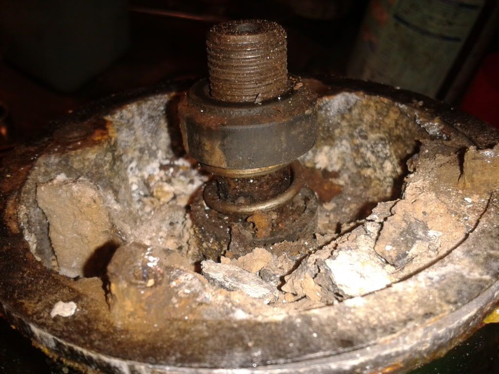

& if you look a little closer you can see I had to drill the heads off 2 bolts here to get it off. The heads of these bolts live inside the pump, with the water, & are made of steel. the top 2 came off, but the bottom ones were rusted down to rounded off lumps....

But, my main problem with this engine is the cylinder head. I just can't get the damn thing off!!! Mad Mad Embarassed Crying or Very sad
I've removed the nuts, but it won't budge, & with that stuck on I can't remove the piston, so therefore can't remove the crank shaft to get at that noisy bearing!
I think this one could be made to work again without too much expense. I could either get another coil for it or convert it to that energy transfer system I'm so keen on. I bet I could get another main bearing pretty cheap, the seals aren't too bad, but if the drain plug was left out whilst running then that wouldn't matter so much (these pumps tend to let water past the shaft anyway, you just need to remember to drain them down every time you stop the engine or leave the plug out & put up with the small amount of water loss).
But, although the orange one works, I have no idea what state the pump is in, so I could keep the green one as spares, although I would rather get it working again.
Anyway, does anyone have any special tricks to get the heads off these??? (Kev?) I've tried turning it on it's side & hitting upwards on the base of the head with a large screwdriver, but it isn't budging. I bet some clever sod has plastered it with red hermitite Rolling Eyes . It looks like it might be stuck on the studs though (or possibly as well as sealant, although I haven't seen any signs of sealant yet, so it might be just the studs).
I have heated the head up, around the studs, & put some easing oil around them. After lunch I will go out again & have another go.

The head is now off! cheers
My god that took some work! Embarassed That was a real fight to the death.

The main problem is getting the 2 bolts out which I had to drill the heads off. They pass through an aluminium casting & have corroded into the holes (much like the cylinder head studs).
