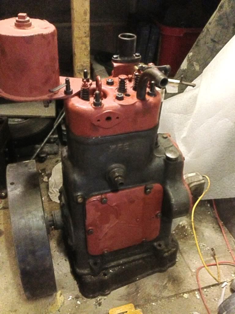

My latest restoration project is this Rushton 6 ps ( Power starter ) it is a twin cylinder engine one of which is a compressor used to charge a vessel to kick start a larger engine.
My father saw it on a farm and put me in touch with the owner. It was seized and missing the float bowl on the carb but he was willing to sell it.

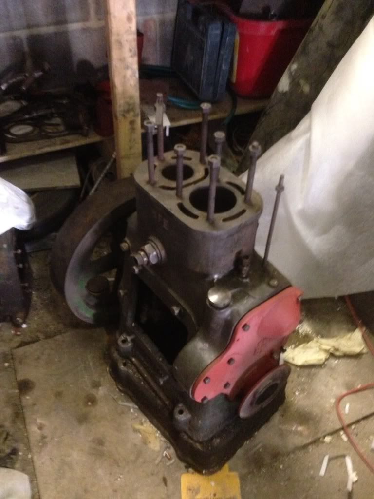

After stripping head off the piston was half way down the bore so I soaked it in diesel and over the next week would gently rock the flywheel each night and it released. The bore is fine and rings are not to bad although after grinding in the valves it is still a bit low on compression so will try and get replacements now I have had some advice from other forum members.
I managed to find a solex carb on ebay which was the same body as the one fitted so we are good to go.

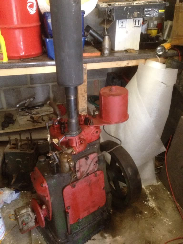

As you can see from picture I have cleaned up all what I had removed and I am temporarily putting it back together to get running then will strip it back again to rub down and paint it properly.
Will keep you all updated with progress as hoping to get it on the rally field this but working away at the moment which is hindering progress.
I would be interested to hear from anyone who has had any experience with these engines.

I've no experience of the 6PS but plenty with the smaller 2PS. Have you checked the big ends? If they are like the 2PS, watch the shims. They need to be fitted very carefully as any trapped in the gap will stress the whitemetal shells and can lead to cracking. You may find it pumps oil out of the compressor side air outlet. I don't see a plate on the crankcase door but the serial number (six figure) will be stamped in the end of the crank. Looks to be a later 40's or 50's engine. Made from '29 to '65ish with over 6000 produced. Used for starting bigger Diesel Engines so unusual to find one on a Farm. Normally found in Diesel Railway Locomotives, Excavators and Municipal Engine Houses etc.
