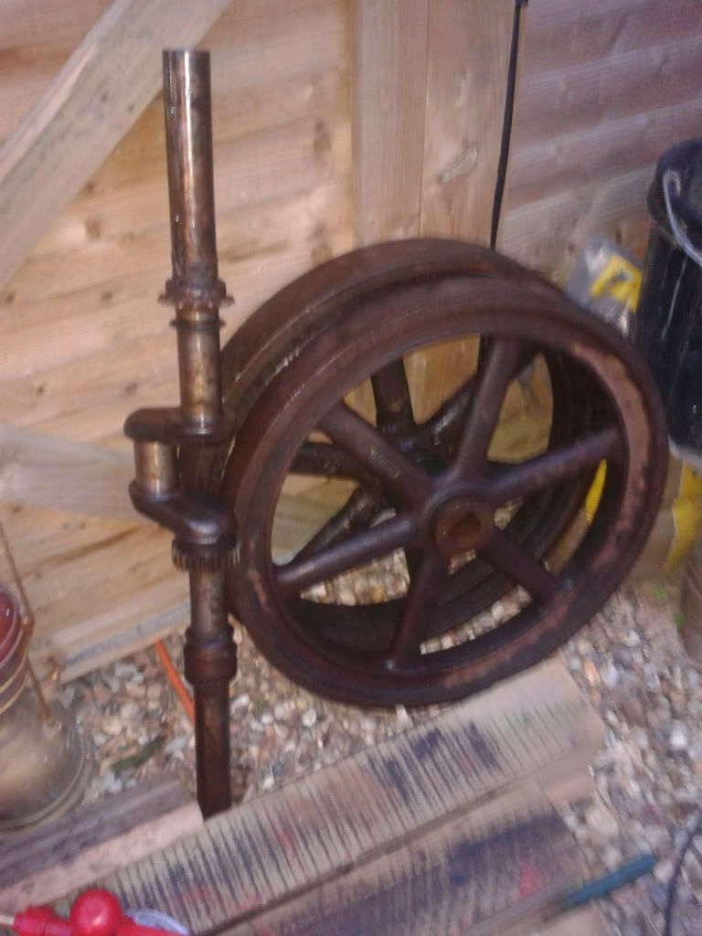

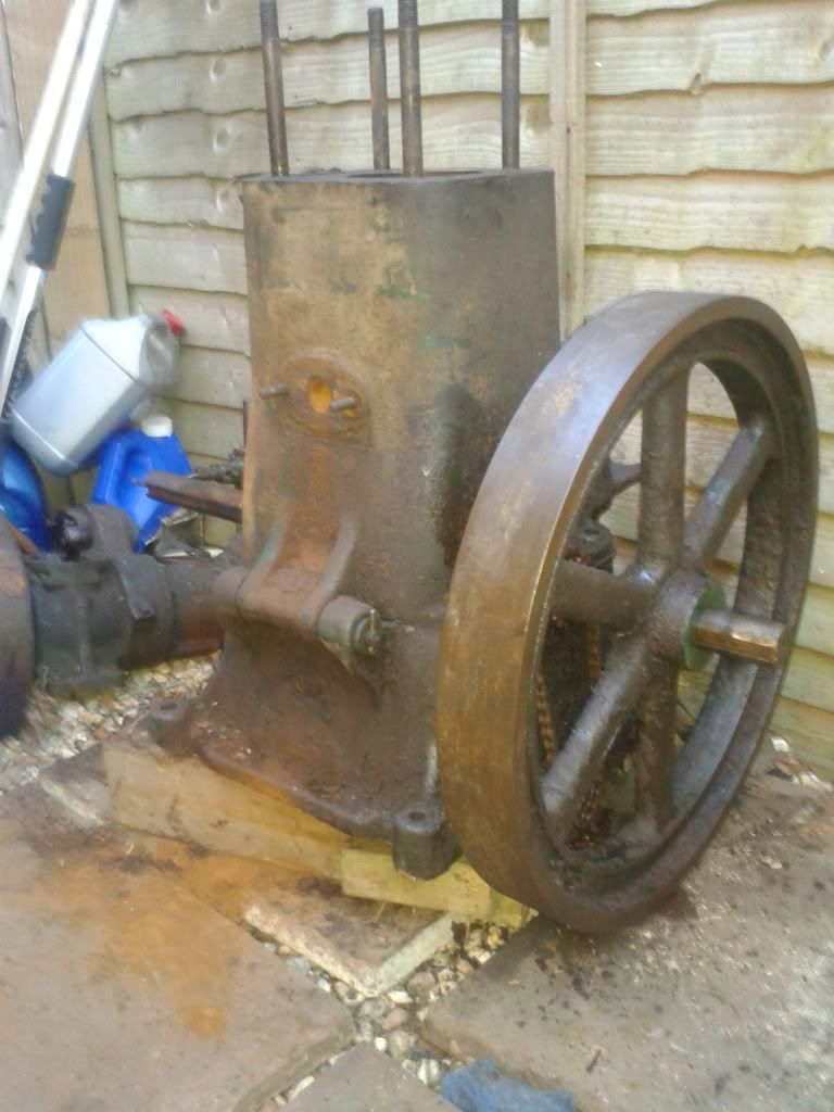

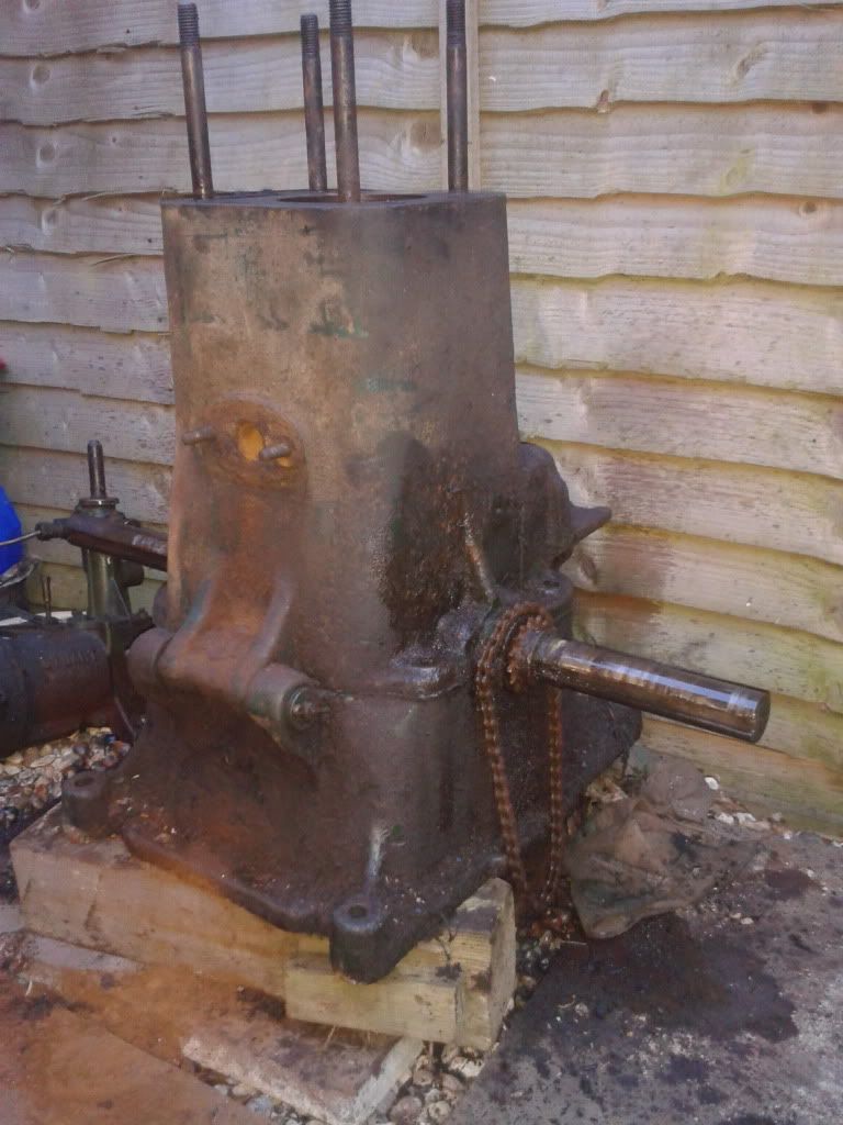

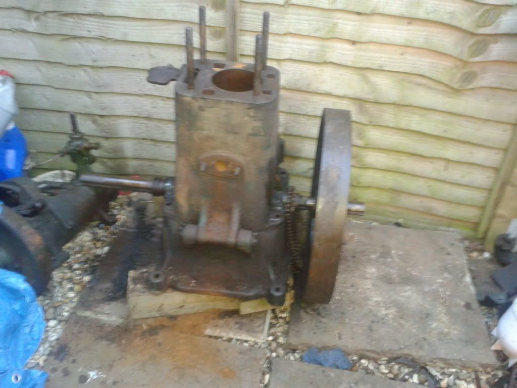

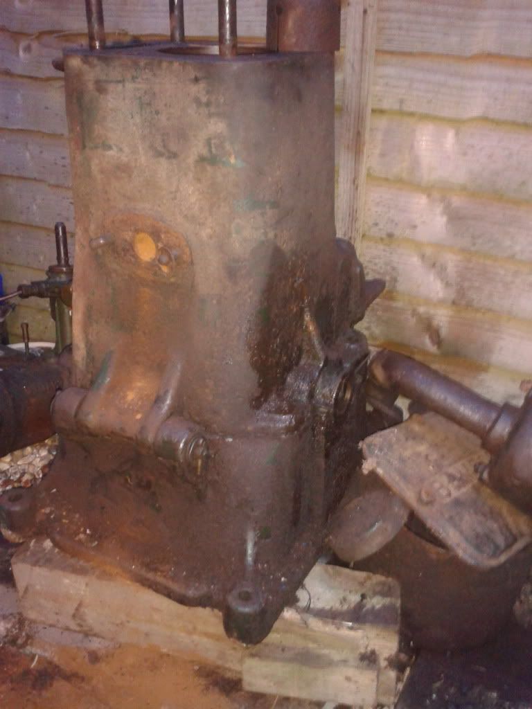

It's been a little while since I've reported on this one, it was still peeping out from underneath it's cover so I decided to have a little play with it this evening.
Mark has promised a visit soon, & said he would bring his gib key puller, so I thought I'd better get it prepared for him. I started by removing the pulley, which has been proving a bit of a pain. I eventually got it off with a 2 legged puller in between the spokes (I didn't have a big enough puller to go round the outer edge).
This engine is still in a bit of a mess, so I didn't get to take many pictures as my hands (although covered with thin nitrile medical examination gloves) were caked in old oil & grease, so the pictures had to wait until it came time to rest or change my gloves.
Anyway, the flywheel gib key was looking at me & I thought I would have a little go. When I picked up my haul of Stuart Turner parts the other day I noticed among them what looked like a gib key punch/chisel type thing. I wasn't sure if it was for gib keys or not, but I had a go anyway. I had been trying to remove the key on the governor side some time ago, but to no avail. I had heated the area several times & dowsed it in my home made easing oil solution, but the possible extractor tool I had wasn't big enough for this side, as the key head was too far away from the edge of the flywheel, but it would fit in the pulley side, so I gave it a bash (with a big hammer).
Low & behold the key moved! :shock:I couldn't believe it! So I went to the other side, found some metal to pack between the tool & the flywheel & after some considerable effort I managed to move that one as well! Shocked....

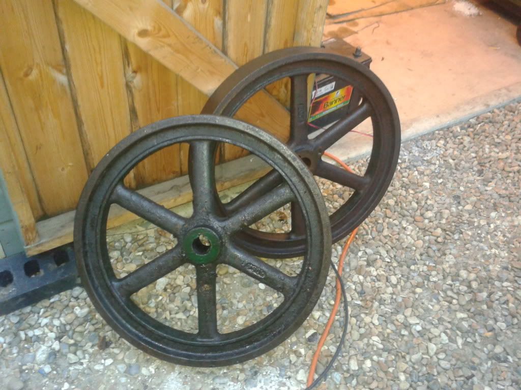

It wasn't easy getting the flywheels off the shaft though, particularly the pulley side (some filing was involved), but eventually they came off (with a lot of grunting & sweating & effort, but I kept the swearing to a minimum as I have religious neighbours & this one's close to the fence)....
So then I thought I would go the whole hog & get the crank shaft out as well (& why not?)....
Which left me with some more bits to clean....
I took plenty of pictures to remind me where everything goes, the gib keys should be fine for re-use (I marked them up so they go back in their respective holes). Now it's pretty much completely disassembled, so just need to get on with the parts cleaning & get priming I suppose.

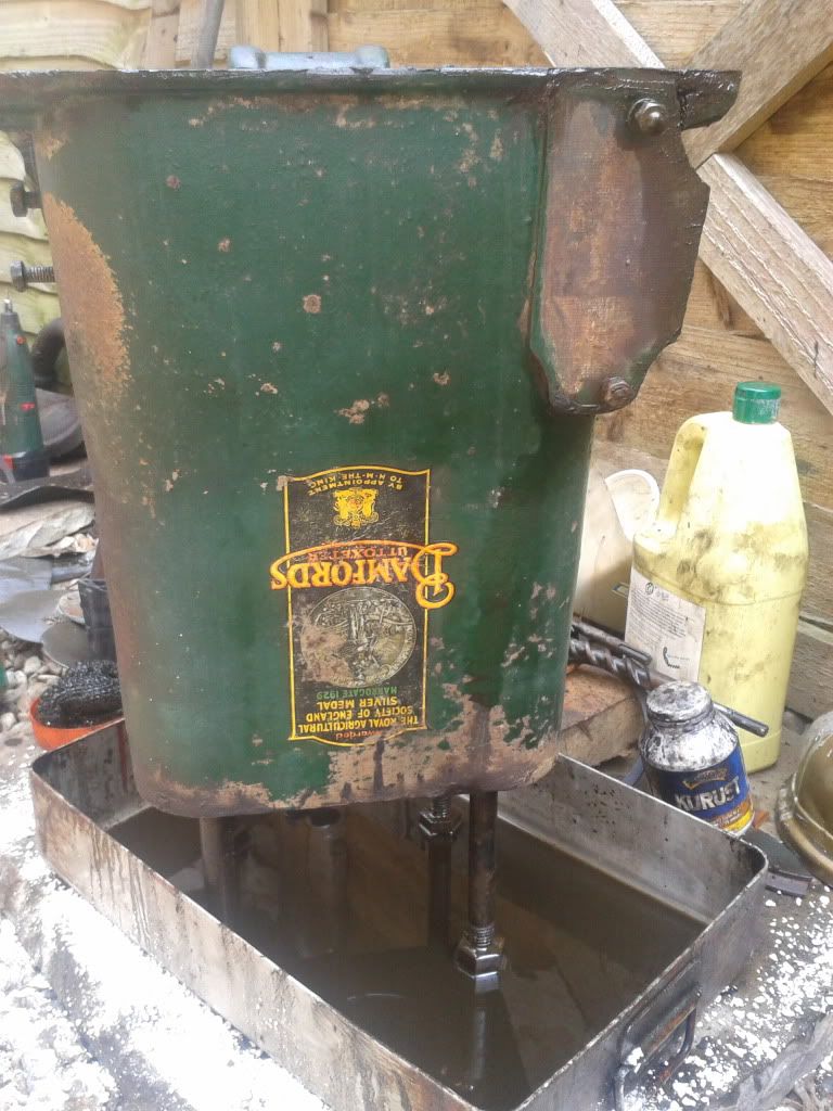

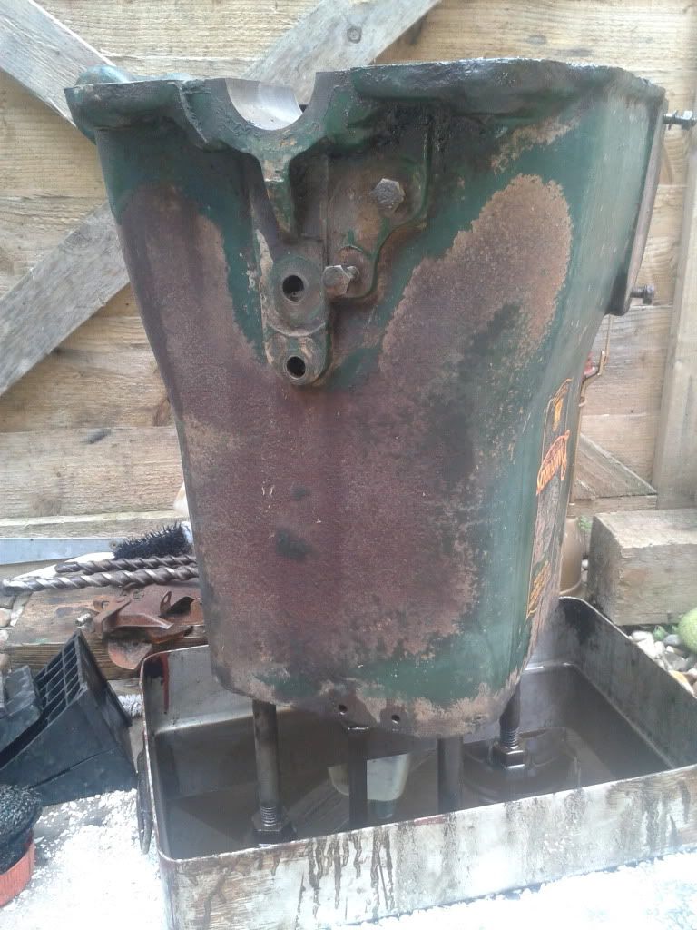

Started cleaning up the grime today, & look what turned up under it all....
Trouble is the other side has pretty much no paint at all....
& the flywheels show no signs of any original paint either (that's if what I have found is actually original).
Sad to say, but I think it will all be attacked with the wire brush wheel on the grinder, then primed & re-painted & a new transfer applied. I'm not so sure the paint on it is original anyway.
I will take plenty of pictures though & measure where the transfer was placed, so a replacement can go in exactly the same spot.

Looks like the paint is not original. As there is a lot and no chips
Re: Bamfords SV 5hp (yet another project, they seem to be getting bigger!)
Post by nutgone on Thu Jun 27 2013, 17:14
Lewis MacRae wrote:Looks like the paint is not original. As there is a lot and no chips
I'm not so sure now, now I've attacked it with the wire brush on the angle grinder. The paint was quite soft & pretty thick, there also appeared to be paint where there shouldn't be.
Oh well, I've started so I'll finish Very Happy.
Post by Lewis MacRae on Thu Jun 27 2013, 17:47
Upload some pics later on
