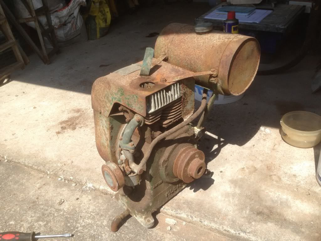

Had a result this week whilst doing some work at a farm. We got talking about engines and my restorations and the farmer gave me a villers engine. It has been stuck at the back if the barn for a long time and won't turn over but i am never one to turn a gift horse down.
Will keep updates as to progress.

that looks like a nice and early villiers mk20-25 dates from around the mid 40s
that is from the angle you took it from anyway lovly split cowl series

Stripped down this morning. Piston is seized I'm barrel and HT lead missing.
Well spotted on Id Kev. Plate shows a Mk 20.
Have soaked bore in diesel so will leave for a few days now and see if I can shift it.
