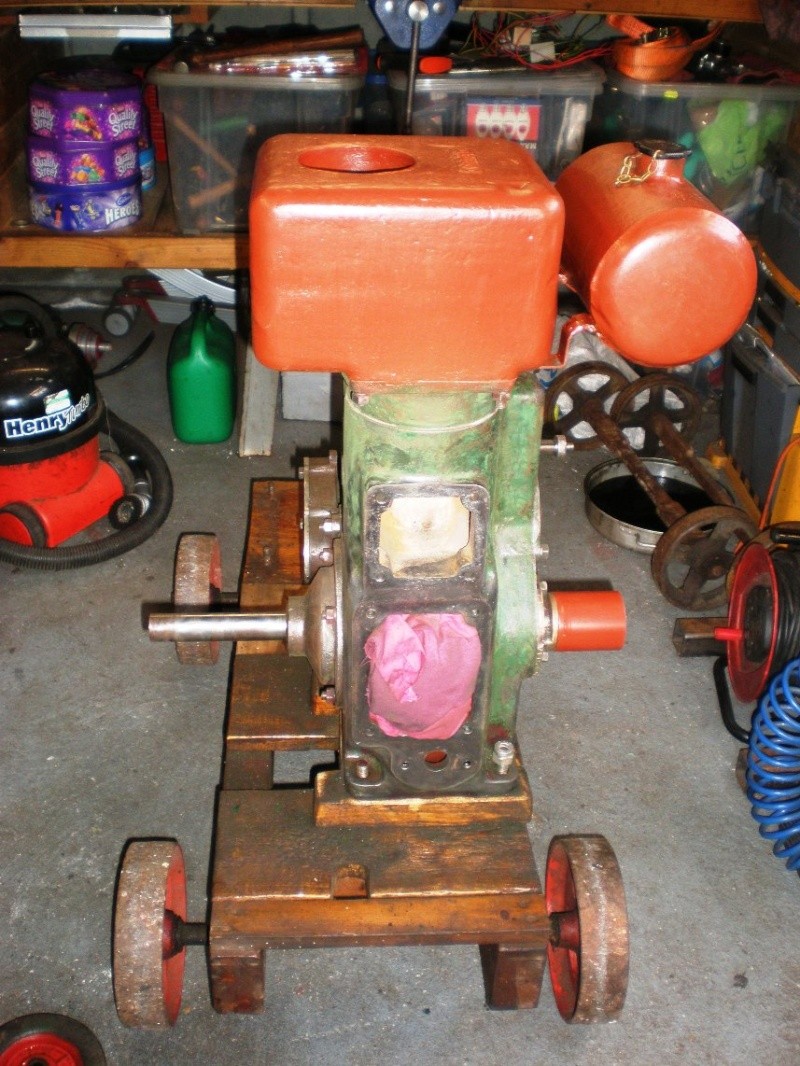

Well with a bit of free time this afternoon thought id crack on again with the PT, waiting on delivery of some small drill wire brushes so cracked on with the extras managed to make a new shaft cover out of steel tube and a bit of steel plate also now has a slot in the end as it should have done to start with, also managed to strip and paint the plates, carb and oil filler neck and have started making a new drain plate as old one was a bit on the ruff side and not very well made also managed to find a new drain tap and fuel tap in my odds and sods box so that was a bonus, hopefully will pick up some topcoat tomorrow so can get on with that then, pics below

Cracking on with it well Abes ...
Am i being shocked this is one that is being painted for once ?
Run out of the grate black have you ???
Re: A couple of new toys to play with
You have cracked on with it since I last saw it. Looks good!
LOL yer this one is going back orignal ie Deep bronze green, still got to use a bit of the grate blackner on the exhaust got to have a bit somewhere lol

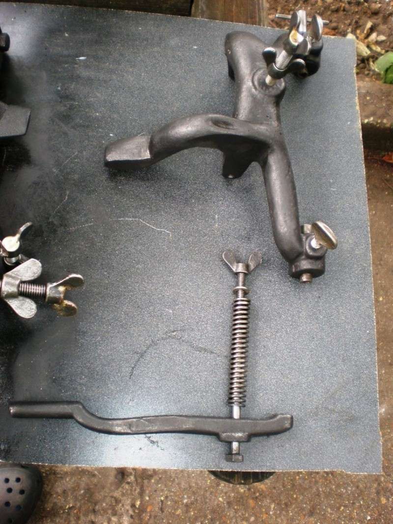

Quick update cant do much with the engine at the moment so thought id make a start on the blade sharpner so stripped it down to bare metal degreased and cleaned then reblackened, need to make a new trolley for it and purchase a new file but other than that jobs a goodun pics below

Abes, are you going to use the bandsaw blade sharpener? That would make a brill exhibit that is also practical as you can also use it.
Yer going to be rallied mate something a bit diffrent for a change
Lewis MacRae wrote:Abes, are you going to use the bandsaw blade sharpener? That would make a brill exhibit that is also practical as you can also use it.

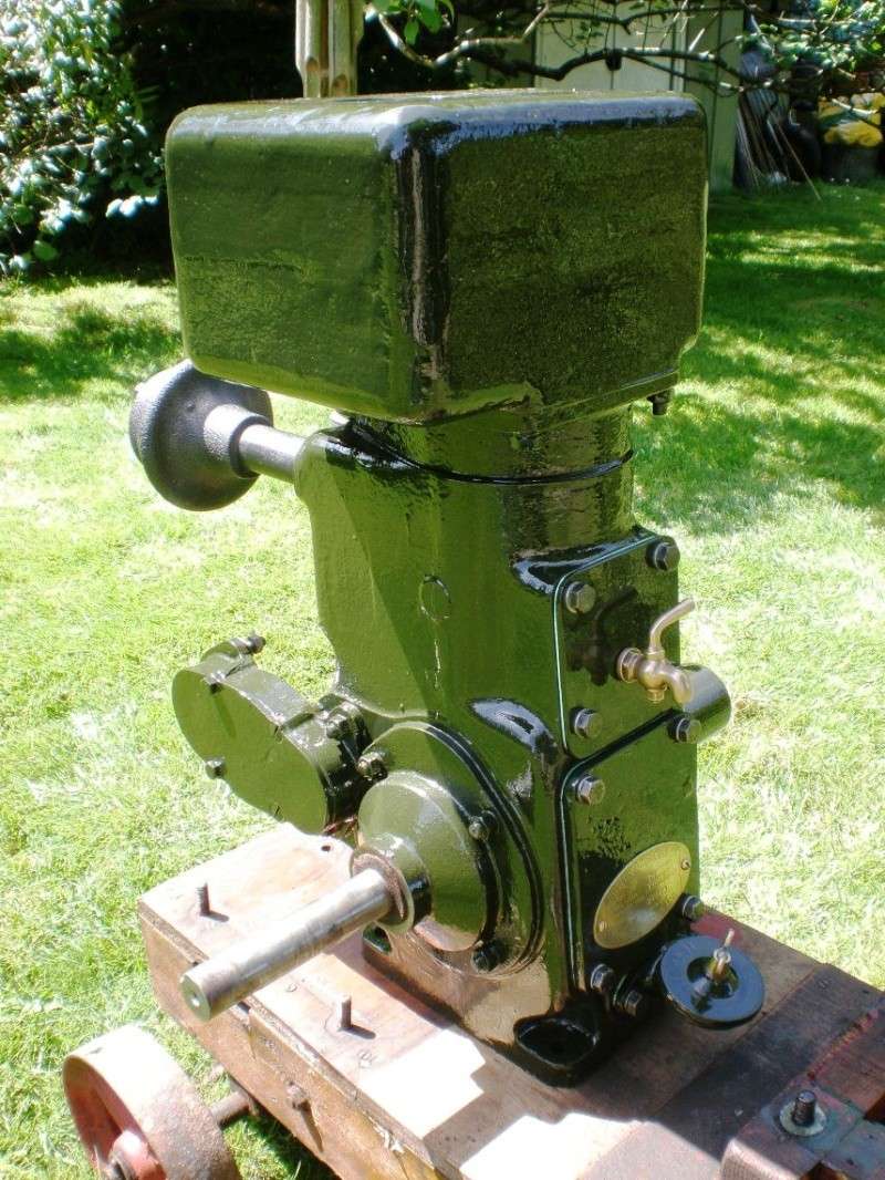

Well after some playing today this is what she now looks like still need to refix the tank, flywheel and mag but these wont be done untill she's back on a new trolley plus need to get the decals, pics below
