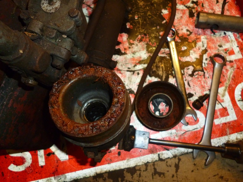

got there tonight to find this well see the pics
no spark plug and all i could see was rust ,grit water and other bad sh1t in there
he was wire wooling the id plate when i pulled up his drive way  whoopsy
atco tank fuel pipe off h/t broken
running only weeks ago her beleaved his mate told him "great mate"
oil bath guaze filter "blob of rust water  bath filter

it was bleeding watery slugy creamy sump oil before i started with the  spanners
2 finger tight bolts and there the engines guts Rolling Eyes
when i got the head off seized valves and a sad looking bore
ht lead and many other wires not connected were they should be scratch
rust and corrosion on the rotors and stators brushes missing ect ect

got the dynamo of the engine
got the crank apart and out
got one good piston ring off the other are to fatuged to be used again:roll: theres a shock lol:roll:
got the head stripped and valves out and cleaned up, ready for a lapping in "seats were very good under that crap and rustb:shock:
stems and sleaves were like new considdering they were seized in solid
so it has a good head, canshaft,valves, conrod, piston and bore
just needs rings and a head gasket making ,if the rest comes up like these did ,but bearings and seals will be needed for the crank and the cam followers are still seized solid in the block base
so will keep messing with it from time to time ,gives the kevs cocktail time to work its way in or not Cool
i must be mental as im still trying to save it for him
