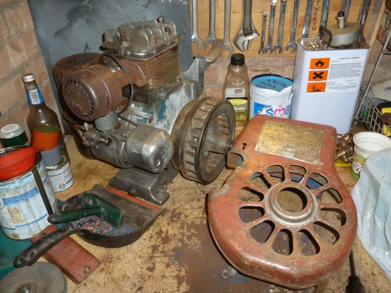

well it under the shed and been getting stuck into tarting it up
heres the pics  of work so far
fuel tank/ culinder before solder repairs and filling in the rest of the pitts and dents and the holes were all on the top of tank only scratch
the dark blue top coat on the repaired tank
scrapped silvers blues and all colours of spray off the cowlings ,back to just a fin remains of the oxide coat  just waiting for a dry day to sand back to good tin and panel beat the biggest of the dents and waves ,then fill the remaining in

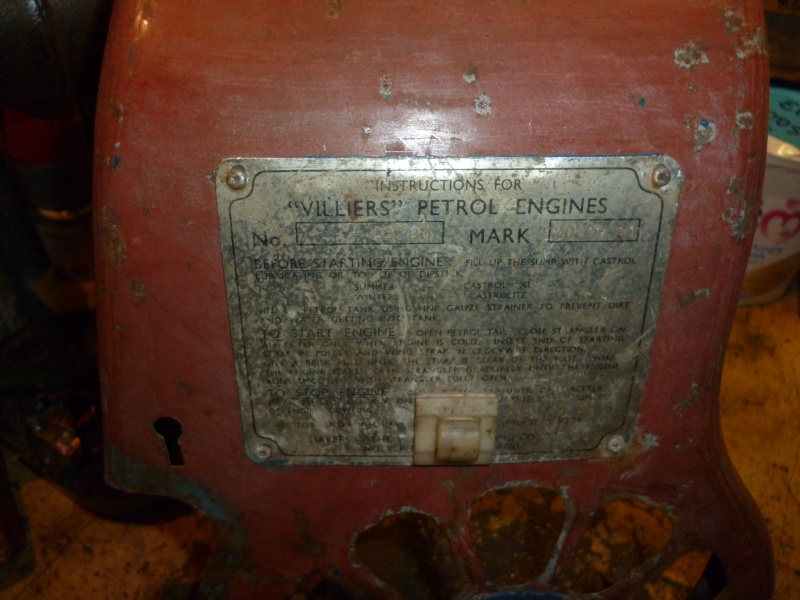

the part number and ajh makers year stamp 1964
the original blue under all the crap and id plate

my little just turned 3 yrs old forman, picked the colour off the shelf , shoock the can,got a flathead screw driver of the tool board, opened it ,got a brush out the shed draw ,mine is out of her vision level ontop of head lol ,bless,and painted all the sump off her own back ,and no paint on her cloths,thank god,thats what happens when dadda dont shut the child gate correctly, but very impresses with her learned from dadda skills and what goes were in my shed knowlodge, it was going to be empire blue not battle grey, but seeing as she started it that colour ,after i finished my tea i did all the rest, all the panels are also hanging and drying will take some more pics tommorow of my skills just look at that stright line ,and she did it all the way around ,up to the sump gasket "flipping auwsome
but for now leave it at my eldests tallents
little to deep with the brush in paint "must point this out to her in the future lol

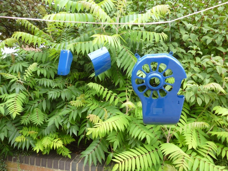

heres the cowlings hanging and drying yesterday and any good weather since sunday see the original square of paint good match me thinks
wont be seen as id plate goes there ,but good for one of the next owners to find when they deside its time for a repaint,also on rear of id plate ive put restored august 2013 by me ect ect
cracked on again today as the topcoat covered in one go Laughing
