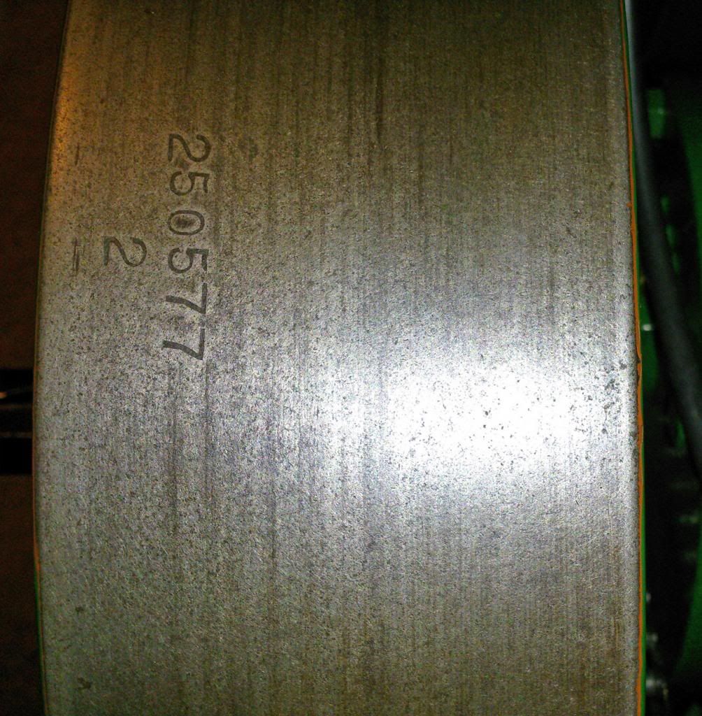

The serial number on my 1940 Lister A is stamped on the face of the flywheel (where the tread would be if the flywheel was a tyre), and towards the outer rim.  Here are a couple of photos that should hopefully help explain things.  The single number '2' beneath the serial number is just the flywheel number (they are numbered 1 & 2):

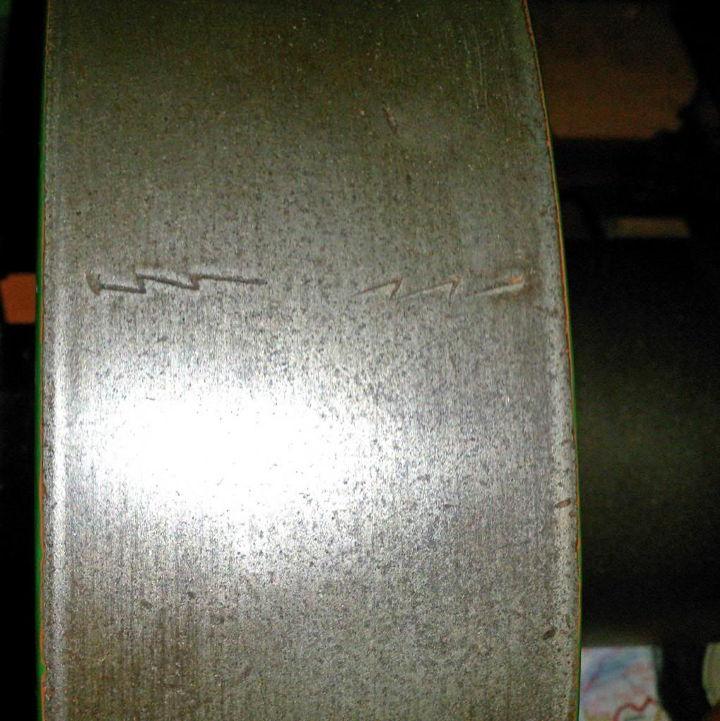

The ignition timing mark is stamped on the flywheel face on flywheel number 1 (on my engine anyway!) and looks like a lightning bolt (However, I think earlier engines might have been stamped with a slightly different [smaller?] symbol):
As I said, this is where the serial numbers are on my engine, but I can't be certain that they will be in the same place on your engine.  The Lister A engine was made for around 40 years and, as you'd expect, they made quite a few changes to it during that period!
If the flywheel faces on your engine are rusty then don't go too mad with the sandpaper, as you don't want to destroy the last remains of any markings, so take your time and go gently!  It took me several years to find the serial number on my Lister D as the flywheel was quite badly rust pitted, but I got there in the end.  Unfortunately, sometimes a flywheel is just too badly rusted and the serial number can't be found... or a previous owner has had the flywheel faces skimmed and the serial number has been removed in the process.  Anyway, best of luck and I hope the above info is useful.

Ah thank you for that, it was no wonder i couldnt see it on either side i will look again this evening when i get home:D

I found the numbers on one of my flywheels it is 264324, it is on the older looking one that is in bits at the moment, any ideas what year etc guys???

As far as I can tell, 264324 seems to date from some time in 1948.   Any luck finding the number on your restored engine yet?
