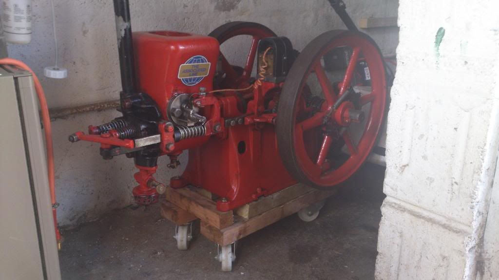

somehow yet another engine has creeped into my collection
an Amanco chore boy which is 1.3/4 hp a latter type with fuel tank in base and a small type mag .

I need to pick your brain about the igniter gasket that does not seal even though its the one that you supplied to Steve .... I assume the igniter face is flat ...
Re: oh no not again ... Amanco chore boy
Post by kevjhnsn on Sat Sep 28 2013, 22:24
so youve been to the midlands area again then mate
the ignitor should be machined to a flat finish when they were new mate
the ignitor gaskets are the weak point in my eyes on the 2-4hp amancos, if the timing or exhurst opening time is out to much pop goes the ignitor gasket every time, ive done it and seen and heard of others doing it too

Cheers Kev but i sort of guessed that , i was asking Chris if it had been faced off when he had it as he rebuilt the igniter .

no it doesnt run but it did a while ago .
not too much wrong with it though .
Leaking gasket joint sorted now but i have found i have a air leak from the igniter shaft now , need to get that sealed , and sort out the fuel line too , oh and the bolt for the adjuster for valve timing needs to be replaced and someone has put a very thick metric locknut on Mad
so just a few bits , oh and on plus side the timing is correct .

it my just be a bit of rusting or grit got in the valve set type seal on the amanco ignitor ,ive had 2 leaky ones before firing them up again ,but after 5-15mins all good and sealing up again Laughing
or just needs the out side tripping parts moving up to take some play out, other than that its the mica tube and /or washers worn or breaking/splitting with age , and letting the shaft go off line to the valve type seal, but even i found a total rebuild of the ignitor an easy job to do as long as the casting is still sound and round .

Kev there is no end float and spring looks New and so does the mica. I think it's the taper where it seals as it is ridged so not creating a good enough seal in my opinion.

but did notice when you turn over there is alot of compression so it might fire up and settle in as you say .

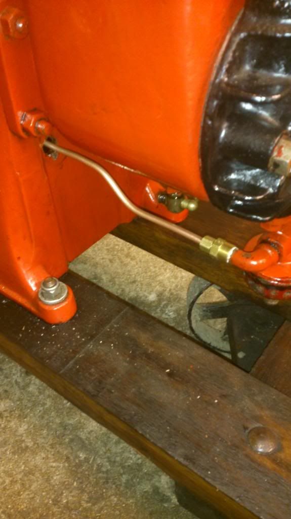

The fuel pipe was staring at me with that gastly tap on there , so i made a new fuel line , lucky i had a 1/4 NPT to 1/4 compression fitting in stock and some pipe .
knocked up a quick pipe but without a non return valve for now as should run without one as i know of people to run them without .

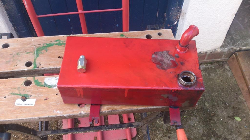

i did notice the fuel tank has no drain tap as such so , i think i will have to weld a steel fitting into the tank and fit a 1/4" drain tap .

fuel tank and the fitting that i will be welding into the bottom with a drain plug , i have already light the fuel tank so it will not explode while welding .
But was full of brown petrol and even a piece of oxidised copper pipe in the bottom , will give a good clean when have the plug in place .

Should your fuel pipe have a check valve in it? Most of the older Amanco have....
well maybe Laughing Anyone know where to get one to fit 1/4 " pipe ?

Only place I know for 1/4 check valves is Frank the tank, I can get 3/8 nooooo problem but 14? No chance!

hmmm 3/8 , now i got a fitting that i can use to go from 1/4 npt from carb to a compression olive fitting for 3/8 pipe , all i would need is a piece of 3/8 pipe no more than a foot .

3/8 is bsp thread so what you would need is a 3/8 male to 10mm compression fitting then go from there to the tank and into the tank that way OOooooorrrrrr go for a 3/8bsp to 1/4 compression, unless the fuel pipe is 5/16. Plus you have all the 3/8 to metric sizes.

I can do some 10mm pipe and fittings to use, and I have a 3/8 clack valve that should do the job.
