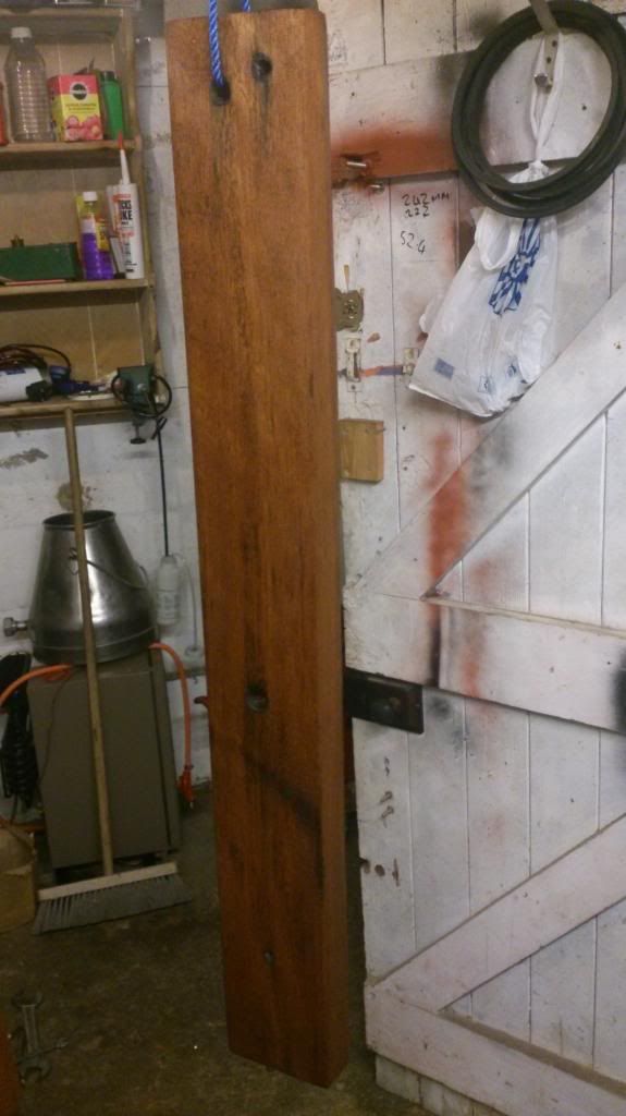

looking a bit better after some work with the plane and sander
given it a coat of tung oil as its a darker oil so after a few more coats il mount the engine back on and then get measuring up for the metal work .

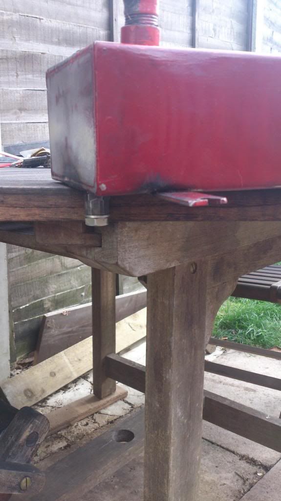

fuel tank has been now welded with a drain plug , just a hydraulic fitting with a internal 1/4 bsp thread for the plug . Then the other part welded to a square of sheet as the tank is around 0.5 mm thin Shocked
and then welded to the tank .
has to flush it out with white spirit and then shove the hose through and now no orange rust is coming out , so thinking i might add a tank filter on the pickup .
