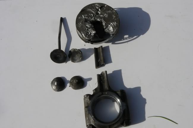

Good plan, set them at 31 thou, or more then you can sit there and sleep to the sound of the rattly tappets.
