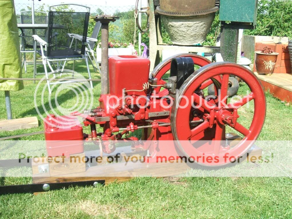

Re: trolley building
Those bearers look dreadful! I have some of those pieces of 3 x 3 about 3ft long if you want a couple of them, like I use on all my trolleys

whats wrong with the bearers ? not big enough ???Matth92 wrote:Those bearers look dreadful! I have some of those pieces of 3 x 3 about 3ft long if you want a couple of them, like I use on all my trolleys
i do have some nice oak that i could use .....

also with one end being light on the amancos steering system will give it the potential to rear up when moving up and down ramps and easy for it to shot off left or right too, thats what ive seen from others and learned with my own ones ,even just one axle and barrow handled ends on main beams will be easy to move and load too,as soon as you get the head end up 18" its only about 10-15kgs weight in your hands
just cant get it in my caravan yet :lol:front window jobby

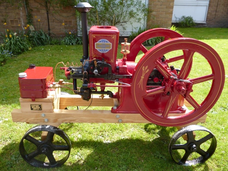

Mine was a 2 wheel job and when I was at a rally I took the wheels off.
wheels on for moving...
Wheels off for running...

thanks Rob and Kev , its true if your wheels are fixed it's safer for when transporting as no fear of a axle turning when strapping down and pushing up the ramp .
Kev , wont be able to do a trolley as long as yours , im limited to 3 ' long and that gives me space to maneuver.
Rob great design , no fear of it going anywhere when wheels off Was yours a petrol paraffin ? looks to have some extra parts on the side .. A rod and lever / bracket .... whats that about ?
Yes it was a paraffin engine, no idea what all the extra bit were for, never found out, ran like a bag of bolts so was never one of the "top 10" engines in the collection, passed it on a while ago for a Petter M 1 1.2 pear top. This also runs like a bag of bolts but that's the way Petter M's run:lol:

always use under a load any parraifin /kerosene or tvo engines, or if no load just run on the petrol onlymatt86 wrote:that seems odd looks like to be some kind of throttle linkage , i have been told the paraffin engines dont run as well compared to the petrols unless they are working hard when on paraffin . Ah swap for a petter m errrm not my cup of tea , im yet tp find someone to convince meVilliers wrote:Yes it was a paraffin engine, no idea what all the extra bit were for, never found out, ran like a bag of bolts so was never one of the "top 10" engines in the collection, passed it on a while ago for a Petter M 1 1.2 pear top. This also runs like a bag of bolts but that's the way Petter M's run:lol:
I shall have to try and get this one running like a clock then , matt
anyway
the "extra bit" is indead for a fine tuning throttle adjuster and a spring loading ,as i have it on mine
my trolley is around the 4 1/2ft long mark ,and only just big enough for my taste of stabilaty ,to short and they kick up the front when firing , so this was the shortest to keep it still while running on tarmac/concrete anyway
but mines on 11" wheels so smaller ones will shorten the trolley length up to a near a foot
Kev my engine is smaller than yours and have had it running today on the bearers on the floor and does not jump at all .
so think i can get away with it being short ish
