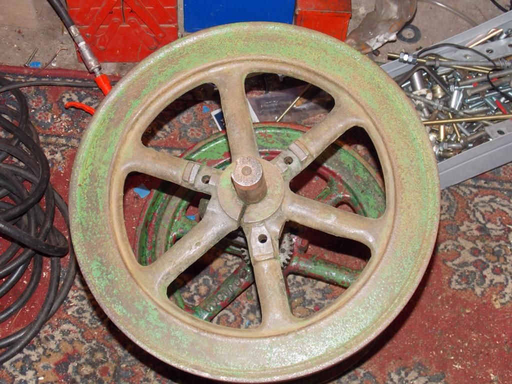

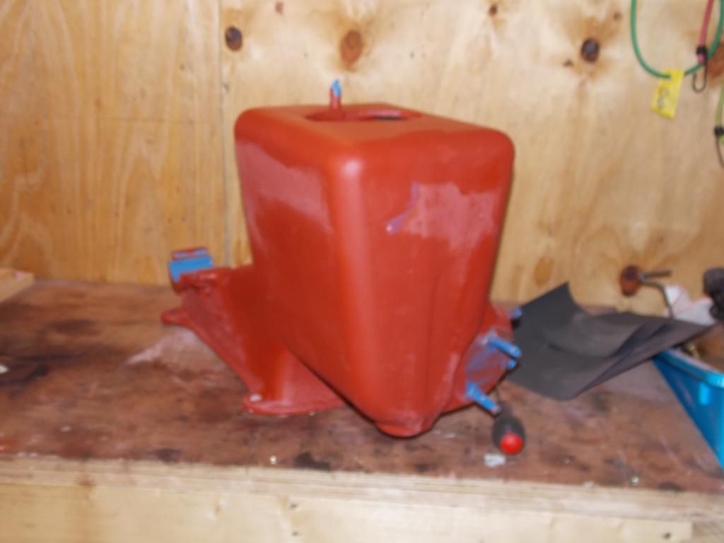

Re: fairbanks headless winter project
just a little update lads ..
have over the week painted the block with 2 coats of red oxide , and then some quite rough casting patches decided a light skim of filler and then another rub down and wet and dry it all smooth , then a recoat on the bits that needed recoating due to being rubbed through .
and have just started the job of paint stripping ...
is it ok to let this stuff dry and come back to it a few hours later or even next day ?
Is that green the primer that was used before hand? Also what Paint stripper do you use? Wouldn't it be easier to take the flywheels of for stripping the paint as they would lie flat.
I have taken on board regarding removal of the flywheels but i have tried various ways to get off and the next stage would be to take into work and press it off but since they been on this many years and are tight they can stay on there with no fear coming off ! I will just have to work around themLewis MacRae wrote:Is that green the primer that was used before hand? Also what Paint stripper do you use? Wouldn't it be easier to take the flywheels of for stripping the paint as they would lie flat.
i think the light green is a primer as a rather flat finish but there is a darker green gloss too which i think is the original colour , I have scrapped the red off what i have used paint stripper on and down to mostly green now , another coat to see if will shift it then a wire brush on grinder ???
im new to using paint stripper as normally get sand blasted of wire brush on grinder but this has alot of areas where wont get in .
Oh its notromoors as dad had 5 ltrs in his garage

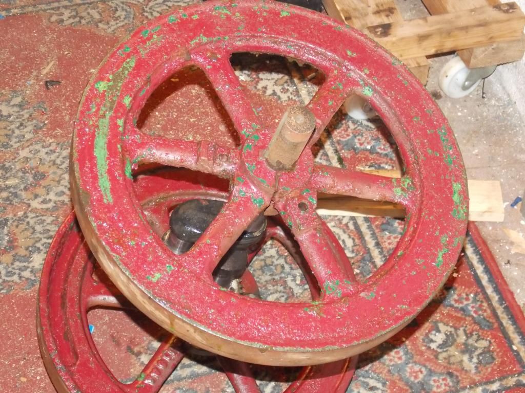

done a little bit more today , but today had been taken up fabricating and welding bits up today for trolleys . and stoves ....
anyway another coat and left for 4 hours ish and given a scrape and a wire brush by hand .... next think wire brush on grinder will be called for .
This paint stripping is not a quick job i can tell you and especially on flywheels too ..
Ye I know what you mean it takes ages. I made the mistake of getting a part stripped back to bare metal then went to prime it two days later and there was some surface rust appearing. wire brush on drill is ok but the brush on the grinder is more harsh isn't it?
wire brush on drill for smaller places but grinder with a twist knot cup brush best , but also can use sand discs for grinder with a backing plate or a flap disc is goo and dont need a backing plate to mount them .Lewis MacRae wrote:Ye I know what you mean it takes ages. I made the mistake of getting a part stripped back to bare metal then went to prime it two days later and there was some surface rust appearing. wire brush on drill is ok but the brush on the grinder is more harsh isn't it?

fully primed now after 3 coats of red oxide and rubbed down between coats , now i need to order the top coat when i know what the colour is .... thing is do i bother with a undercoat ..... we all know we skip that stage and go to top coats
