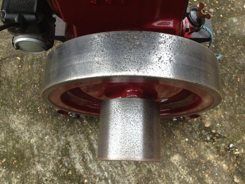

I have managed to get get my flywheel and pulley back to a clean(ish) state, but there is still some pitting that spoils the appearance. I don't want to paint them as I'd prefer a more polished finish. I've done the emery paper while running to get them to their present state. My son has suggested using an angle grinder on them while running, but I reckon that could get us both a Darwin award nomination if it picked up or kicked back. My neighbour has suggested using an old house brick with water as a rubbing block, again with the engine running.... Are they trying to get rid of me, or would this work?
Does anybody have any tips on cleaning them up further?

get the flywheel skimmed on a lathe and that would have a nice face then .
Re: Cleaning flywheels
As Matt suggested skimming would be the only proper way
I thought skimming would be the answer, all I need now is to find somebody friendly with a lathe that could do the job, without charging an arm and a leg.

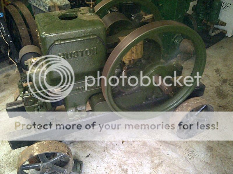

I will be honest but I rarely have problems with flywheels rusting after cleaning the rims, what I do is with the engine running use a beer towel or small towel and hold that against the flywheel, add oil to the towel and make the engine work a bit, do this regular and it forms a "shield" and water doesn't settle on the face so it doesn't rust (much)
My BPR, before Astle this year, this was a pre Astle start up and run, first time in 2 years and no, flywheels have NOT been touched.

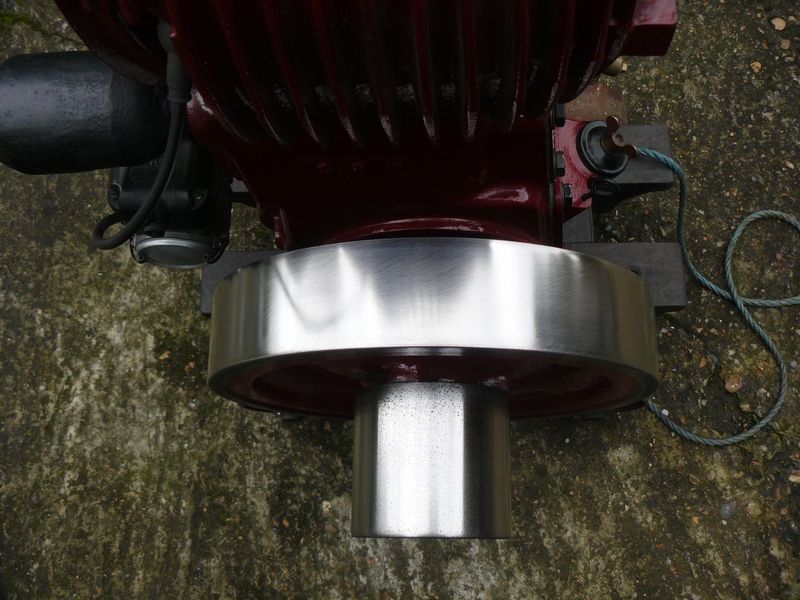

Don't panic guys, I'm still here. I haven't done anything silly with angle grinders.... yet, only a flap wheel in a drill. I spent Tuesday giving the flywheel a good old sand down followed by vigorous but gentle(ish) filing and have got rid of most of the pitting, I took the flywheel off the engine and made a sturdy cradle in a workmate so I could get to work and not worry about iron dust on the paintwork or the flywheel dropping on the floor. It was like being an apprentice again and to be honest I quite enjoyed it, apart from the black dust. It must be 40 + years since I did any 'real' drawfiling and it's looking a lot better than before, it was also a chance to sort out my file collection to see what ones still have a good set of teeth. I'm off work again Tomorrow, so I'll have another go and see what I can achieve with some finer files and some more elbow grease.
Steve
Steve
TomCat- Born to be wild
- Posts : 40
Join date : 2013-06-19
Age : 68
Location : Lympne. Near Hythe. (Kent)
I had another go today and I'm well pleased with the results so far. I had the missus on the crank handle (after removing mag and plug) while I went at the flywheel with an 80 grit flap wheel... bless her. I aimed the grit wheel so it assisted in turning the flywheel to save her arms. After an hour or so and many coffee breaks and promises of treats the polishing was coming on well, after my final offer of a take-away Indian on Sat night was accepted she decided enough was enough and went off to do some girly stuff. I decided an engine powered run was called for, I went for a 120 grit wheel followed by hand pressure 400 wet and dry lubed with brasso for extra lustre. All in all I reckon the wheel and pulley have come up well, although the pulley could with a bit more near the flywheel, but I don't fancy getting too close and hitting the mounting lugs with a flap wheel. They have been given a coating of Turtle wax polish and motorcycle spray chain lube to keep the black clouds at bay and still look shiney.
that looks much better now
Good work, you might want to keep an eye on the flywheel as it is supposed to be closer to the bearing housing than that and may come loose.
That's a quality result Squire - obviously loads of effort but a great look. Also good to read / see how you did it

Top job , That Wolseley is crying out for another flywheel on the other side now though !!
Would look smart imho ! Well done
The right look can always be got with lots of hardwork well done mate looks the dogs danglies
