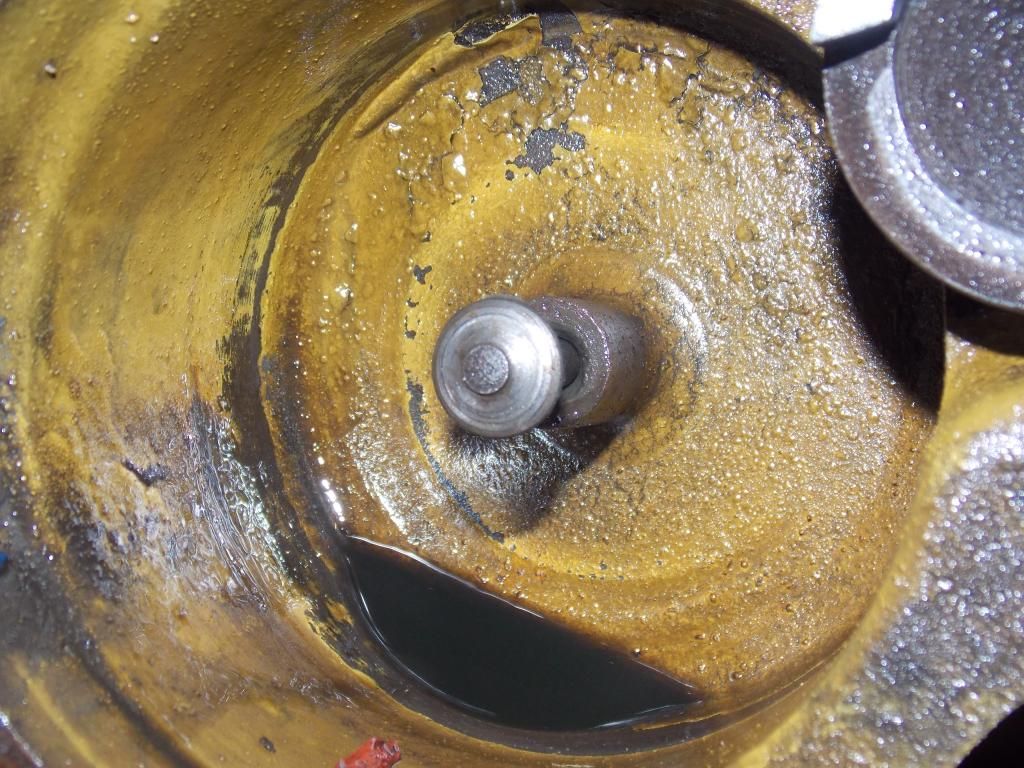

right i thought i would have a further inspection and i have found after removing the timing case that some guvnor parts are very worn ... this does not solve the problem but will be a problem in the future i think as the pin was not sticking through the casing at rest when other i have looked at do at rest .
around the back side of the guvnor pin is very sharp i actually cut my finger ... and the guvnor gear itself fingers are worn too as nothing much left of the fingers ,

you got a manual then from we know were , so we both had the right idea then backed by the bible now Cool
im sure that rod should be 5-7mm thick outside and a small shamfer to it ,now i see what we talked about "if memory is thinking of the right engine Rolling Eyes
cant compair to the last one i have as its down the farm 5 miles away
take a pic of the set up on impulse end of magneto ,then if that matches the remains of the one in my shed then in theory the rest will match up to yours
