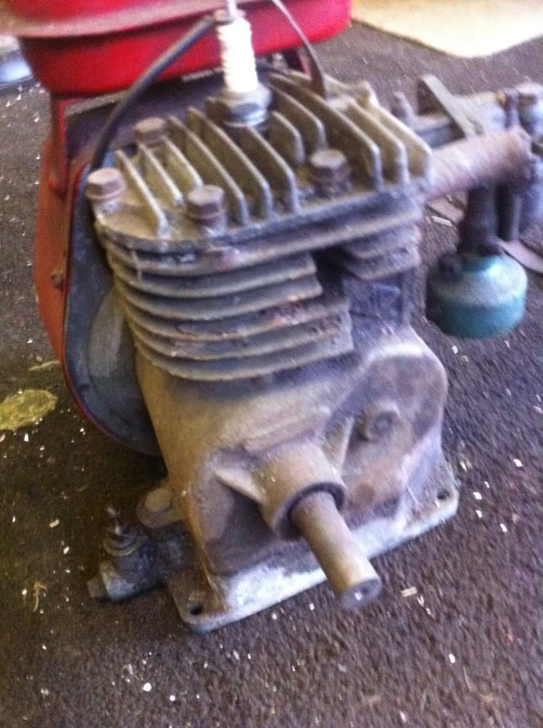

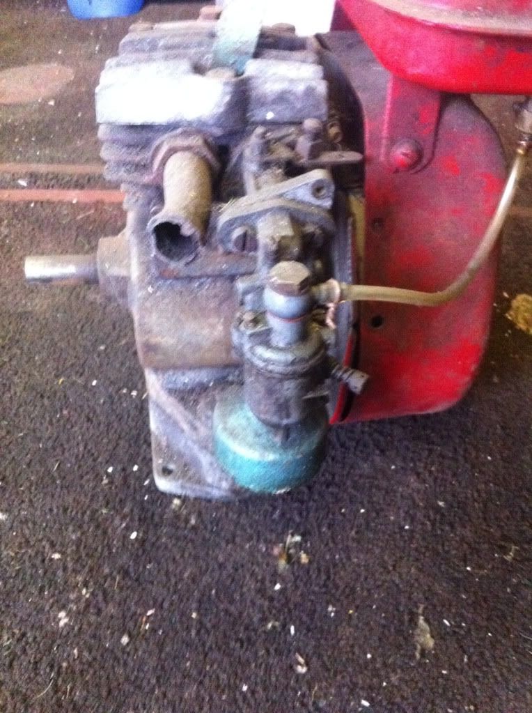

Hi all and thanks to everyones welcome in the new member section.
I said there I've just got a Wolseley WD2 which I have just started work on but in the meantime I have acquired something else, hope this dose'nt mean I'm addicted already
It's a 12v generator/ four stroke engine with a plate that says "Marathon Electric Mfg. Corp." model GDP 300. Been searching on Google for any reference to it with no luck at all so my first question is does anyone here know anything about it?
Second problem is the piston was well seized and the crankcase was full of water! ( well it was only £10! )
I have managed to free the piston and the rings ( after much soaking and praying) but the bore was very corroded. I have removed the corrosion but it's left it quite pitted. I've got a three pronged cylinder hone I could smooth it out a bit with but will it still run O.K.?
Surprisingly the crankcase was almost in good condition despite the water, no problems I hope.

I've now worked out the engine is a Briggs and Stratton made ,I think, in 1943. Hoping to get the engine side of it running (or not!) in a day or two. Also found that one of my original ideas of using the genny/dynamo on its own with my Villiers Mk12 if I couldn't get the engine working is a non starter! The dynamo armature is hung off the end of the engine crankshaft- on it's own it has no bearings at all! This might be common knowledge to most but a revelation to me:shock: All good fun !

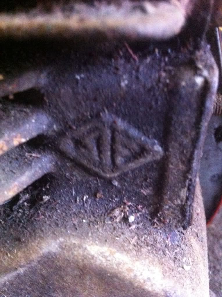

I might have a briggs crankcase here somewhere.
But it look Suffolk punch to me that block. Just had another look at the photo and that is a Suffolk punch engine, fairly early on too.
Bits are alot easier to find. Let me no as I've just broke 2 and have another 3 in stock.

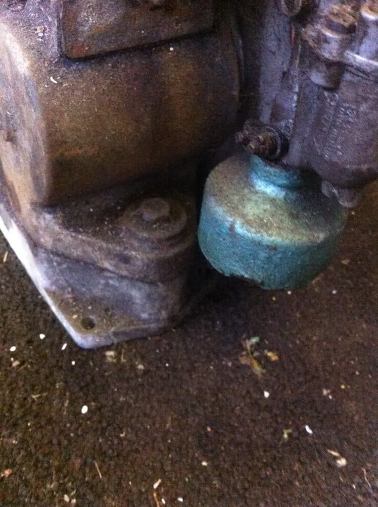

Most likely a Briggs Model N (or possibly a Model I similar to my one), they were used mostly on generators and date from the 1940's area. Most Briggs engine's from that time had oil pumps, they were often removed on overhaul and dippers fitted to the conrod. Check that the pump spring works by putting some oil in the sump (sump removed from engine) and watch it squirt! http://www.asecc.com/data/briggs/engnotes.html
Pics of my 1942 Model I below, wrong carb fitted though!
