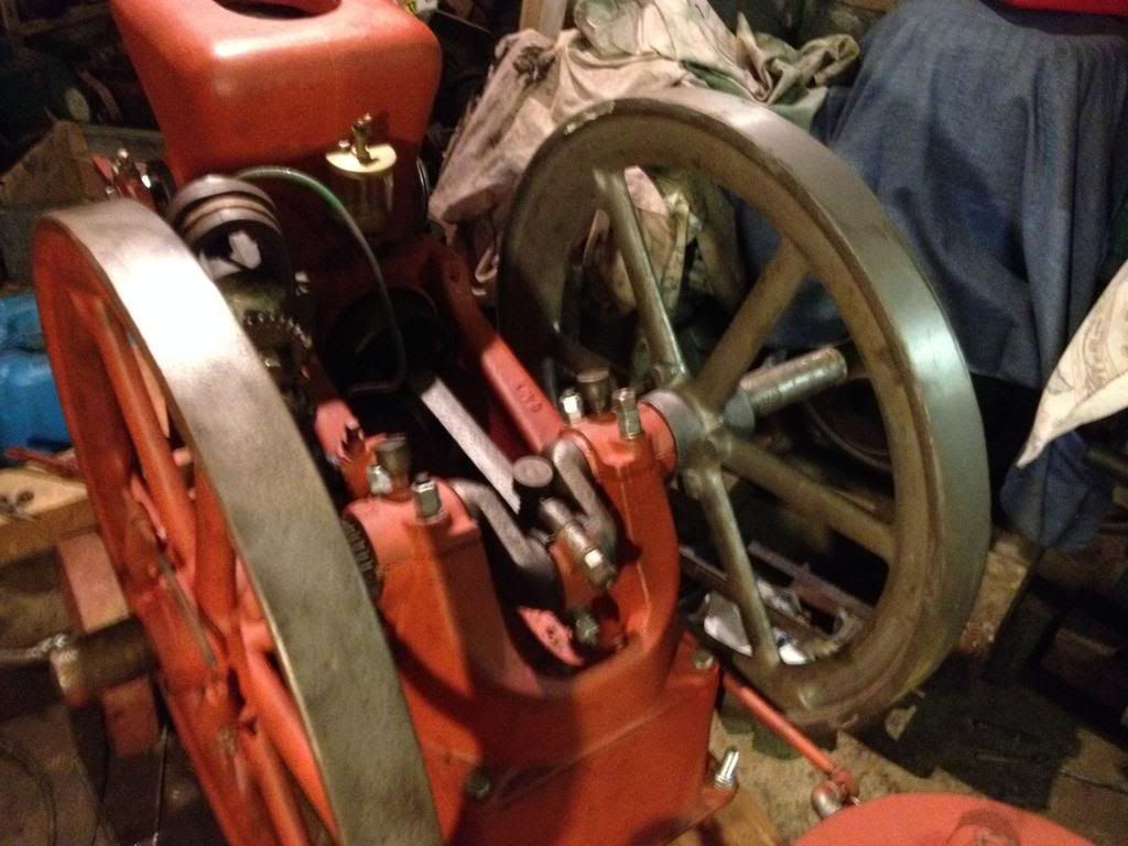

Not much progress on this job today, Just drilled,tapped the holes for the governor weight brackets then bolted them on !

Post by matt86 on Sun Dec 08 2013, 21:53
that doesnt seem to look right in my opinion .... are those bolts metric by any chance ?
Re: Karl's Amanco 3-1/2HP
Post by EarlBathurst on Sun Dec 08 2013, 22:02
matt86 wrote:that doesnt seem to look right in my opinion .... are those bolts metric by any chance ?
Nope, they're UNC, But it has odd sizes as the brackets both had oval holes on one side so i had to use 1/2'' and 3/8'' .

Post by matt86 on Sun Dec 08 2013, 22:08
ahh i see and 2 are flange type bolts too .

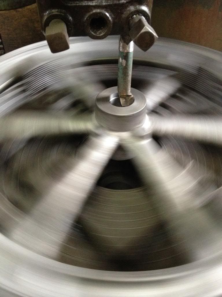

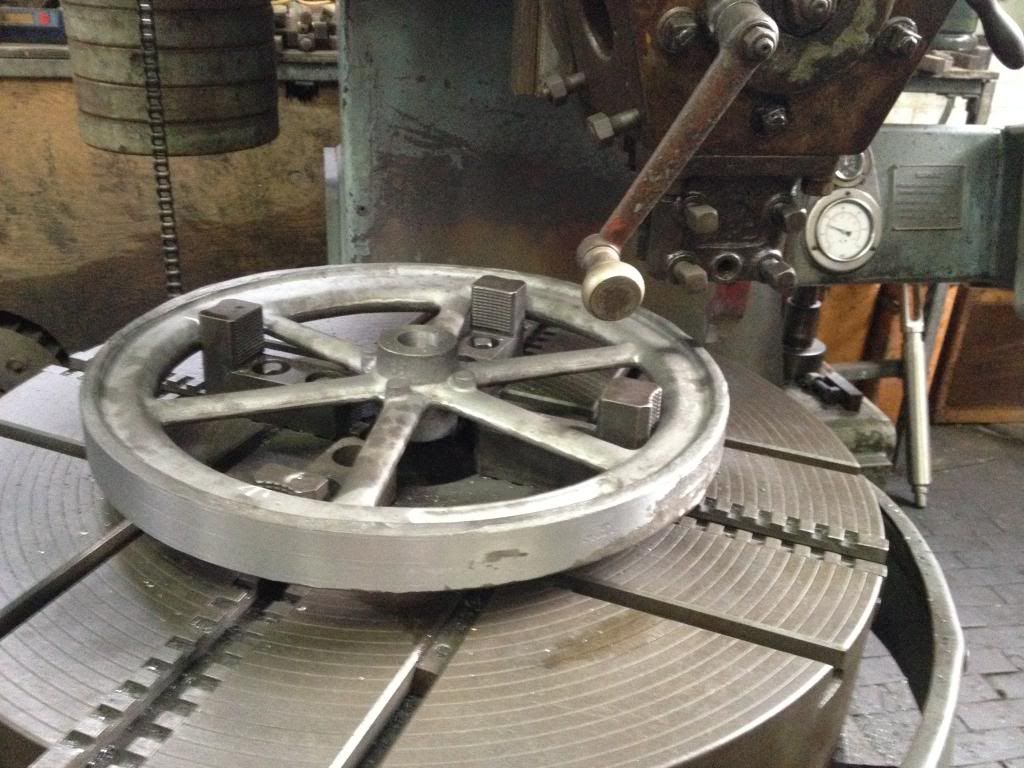

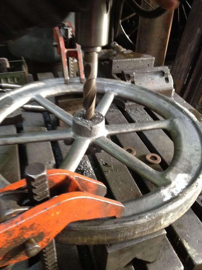

New flywheel machining
Post by EarlBathurst on Sun Dec 15 2013, 20:19
Evening all, Been doing a little bit on the Amanco's new flywheel, i thought i'd share the progress with you, its not 100% finished Yet, mainly due to the need to fettle the keyway.
Cheers,Karl.

nice job there mate like the look of the workshop , was that at Didcot ?
and i assume that machine as not a lathe but does the same thing but verical or is it a mill with a spining bed  confused

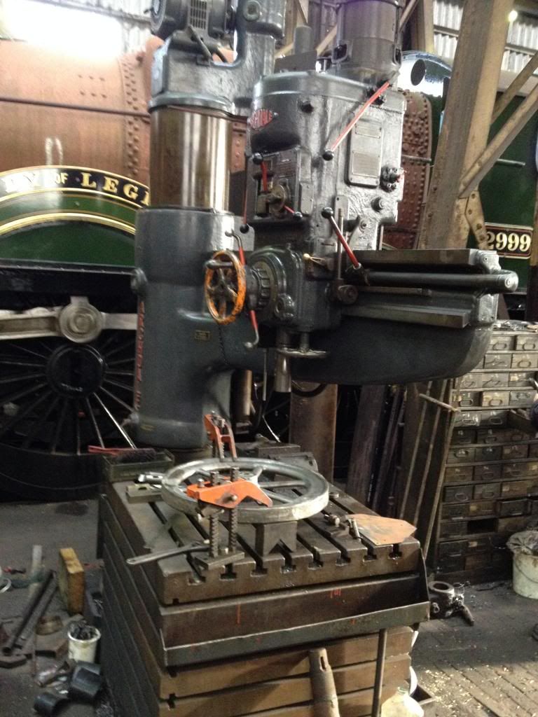

Post by EarlBathurst on Sun Dec 15 2013, 21:08
Thanks Abes, It looks farther forward than it really is , but yes i'm looking forward to it too!
Lewis, Don't forget what we do at Didcot , Full size Steam trains! This toy has a 3-1/2' bed.
here's a few more machines i have the use of;
