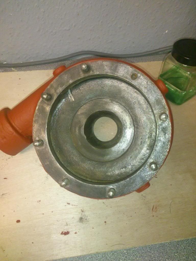

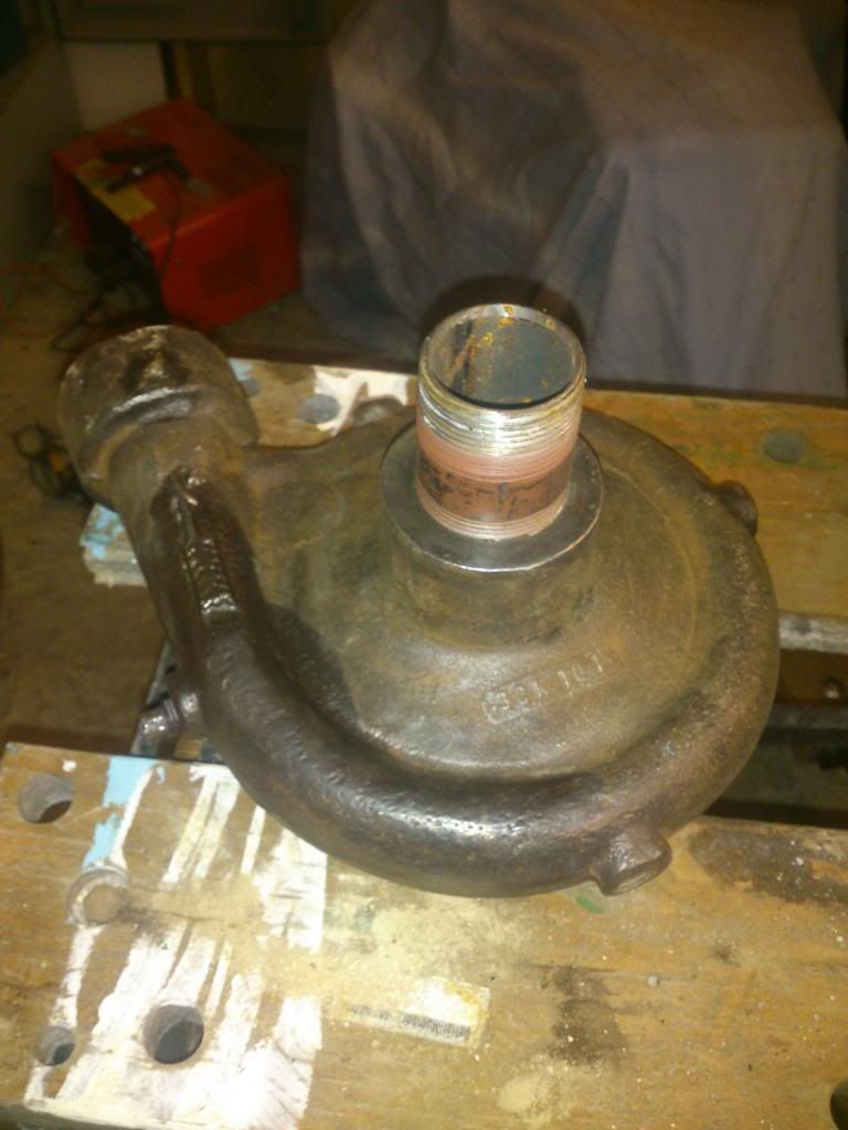

Yesterday i picked up a new pump , went into shed to have a better look at 9Pm next thing a pile of bits  Laughing
needs a bit of clean inside as full of limscale ..
http://illiweb.com/fa/pbucket.gif
Plan for attack is just a general clean and get the limescale out and piece back together with new gland packing make a frame for it to sit on and a repaint at a later date .
Anyone know any good chemical i can use to remove limescale ?

i'd just use general limescale remover for toilets to get rid of the limescale. i don't know if it will affect the paint though.

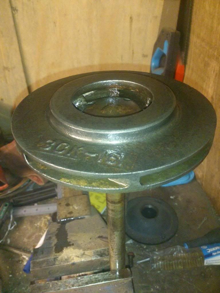

good point i need to actually upload some pictures as its all been cleaned up and both parts are in red oxide now , just a few small bits to clean up and paint then
limescale i order some industrial scale remover and caustic soda and the caustic sode stripped the paint well but it went brown with rust so took wire brush on angle grinder to it .

Post by matt86 on Sun Mar 09 2014, 19:07

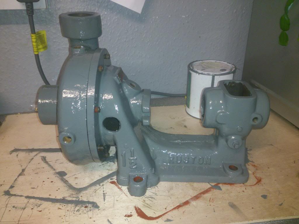

a update got the main parts cleaned up and painted in red oxide

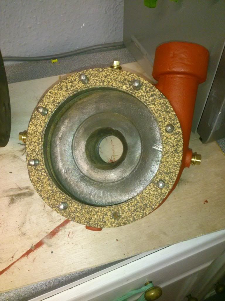

next job is another coat of red oxide on the pump body and clean up all the bolts and make a cork gasket and assemble it and give a coat of top coat once back together .
Re: Ruston rotary pump

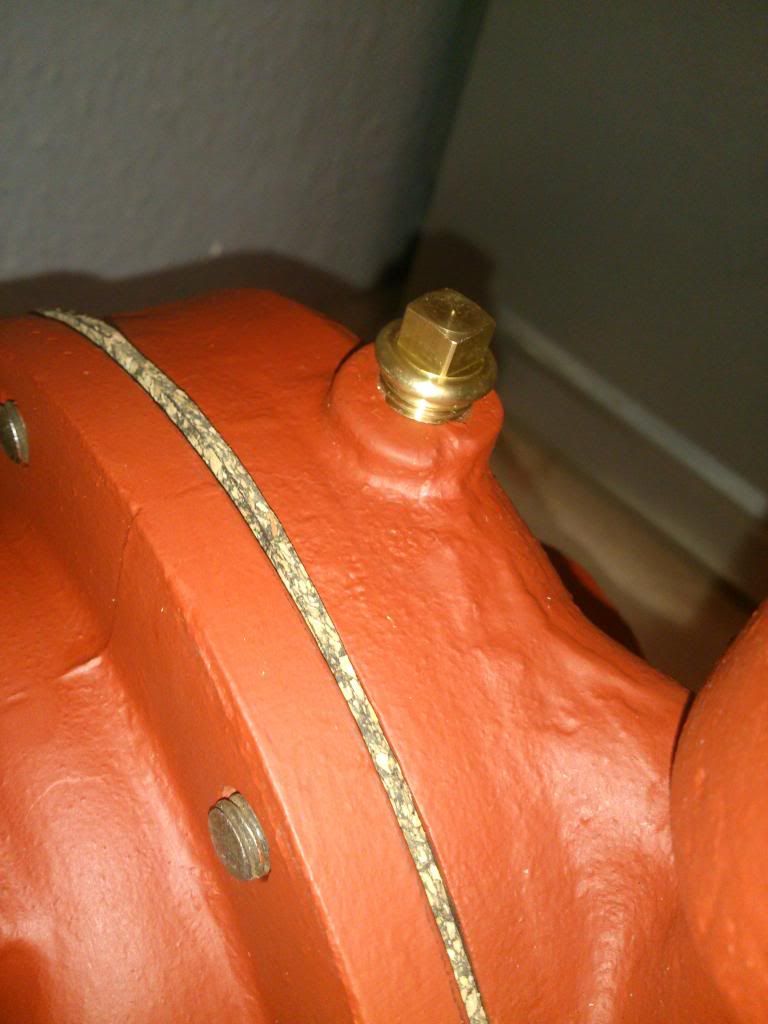

Post by matt86 on Tue Mar 11 2014, 21:10
done another coat of paint on the pump and made a quick cork gasket tonight as you can see most of the hard work done .
also some added bling  Embarassed

got the 2nd topcoat on now

its coming up nicely
and the rotar aint come up to bad either mate,from that lime white lump you started with
soon be blasting the water out fingers crossed

I can. If that cork gasket moves the casing to far away from the impeller then the pump will not pump.
Post by matt86 on Fri Mar 14 2014, 15:16
Good point there Rob! But if it does I got a pattern made from card that I can just use a paper gasket smeared with rtv!

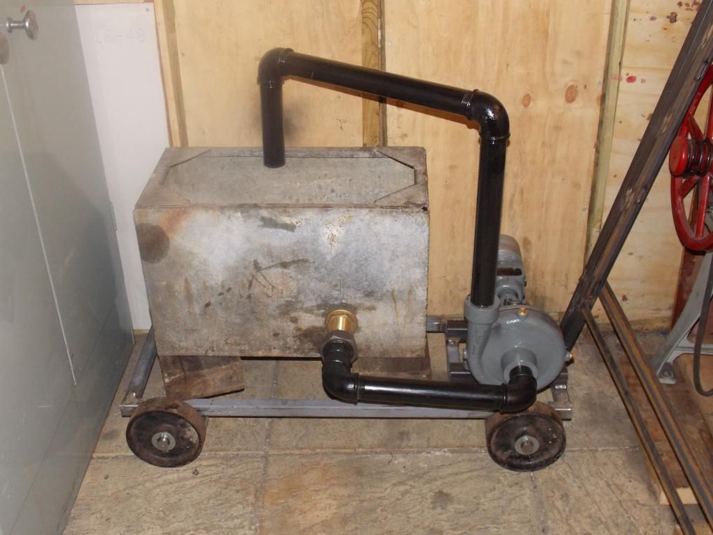

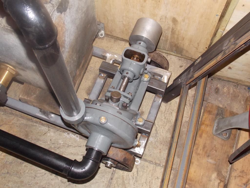

Post by matt86 on Sun Mar 23 2014, 20:48
been rather busy on this got it all back together now with a new gasket and new gland packing , pipework all made and painted and made a start on the trolley now , all i have to do is make the frame for the tank to sit on as you can see its just been blocked up for now . Once that its on with the paint .
not long now till its 1st outing
Post by matt86 on Fri Mar 28 2014, 21:37
trial run on the pump with the petter , needs more work on the tank and trolley yet !
