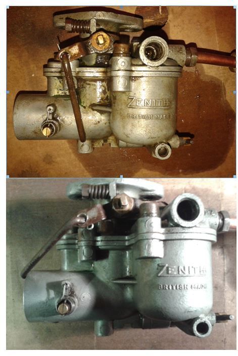

Just came across new WD40 Specialist range. I got a free sample of Fast Acting Degreaser and tried it on the fiddly bits around a Villiers carb. Did a pretty good job.
Look out for freebies in Toolstation, Wickesand and the like.
PS I have no affiliation with any of the above. Tried it again on Zenith carb' see below:
