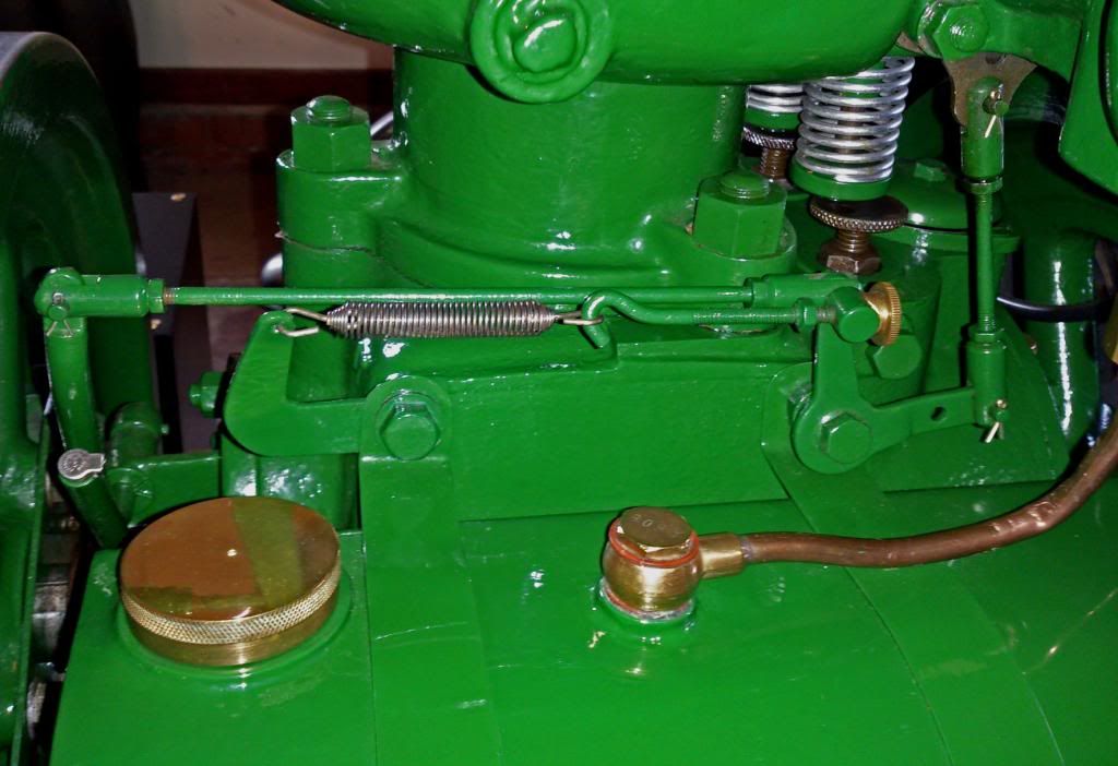

Hi all, my lister A nearly finishing rebuilding, the only thing i need now is a pic of a lister A showing close up of the fuel pipes and other steel linkages from throttle etc, i have box full of parts and a new book but can not see where they need to go.
Any help will be welcome.

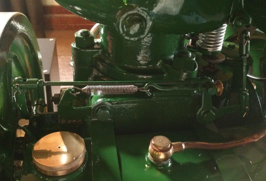

Thx for pics thats helped for the fuel lines, i just need a pic now of the steel rods, springs and linkages that fit just above the fuel tank,

Butterfly or slide?
Re: Lister A help (again)
Post by Rodit on Mon Mar 31 2014, 21:17
I have a slide behind the throttle but i dont know where any of the rods fit.

I don't seem to have a good close-up photo of the throttle and governor linkages on file that would help you... but if you can wait a couple of days for me to get time, I'll take a photo and post it on here for you?

Post by A Lister on Tue Apr 01 2014, 20:38
Here you go, I managed to take some photos when I got home this evening, the light wasn't great so I took one with flash too.  Hope the photos help:

Post by Rodit on Wed Apr 02 2014, 18:10
I would really like to thank those for the photos, i know how to do it now...
