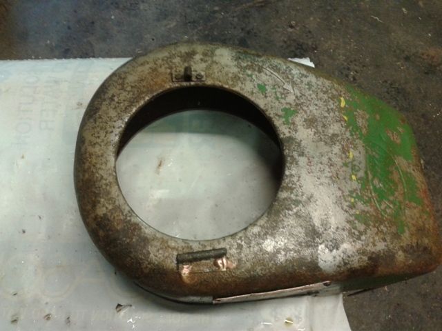

Citric Acid Gel
Post by Woodsman on Tue Sep 23 2014, 10:29
I used a cup full of citric acid crystals in a litre yoghurt pot (Milbona Greek style from Lidl - very nice !)
Stirred well then added about half a cup of Wilkos finest wall paper paste.
Follow the instructions on the packet but go for a pretty thick mix. It adheres quite well to vertical surfaces so good for large items.
Results below - not to bad after overnight soak and a five minute scrub but will apply second coat and post result tomorrow.

Post by StewartH on Wed Sep 24 2014, 08:44
Very nice results - and you beat me to it !
What I like about citric acid is its not as corrosive as other methods - really useful thread!

Post by Woodsman on Thu Sep 25 2014, 07:48
Final result after second application:
Regards Paul

Post by StewartH on Thu Sep 25 2014, 09:22
That works an absolute treat! - now I need to somehow ask the wife if i can lie an engine block in the bath Smile
I take it you were using a stiff brush and water to remove the gel?

Post by Woodsman on Fri Sep 26 2014, 08:30
Dead right. Wire brush and rinse off with water. Reckon it's ready for primer now. Very Happy

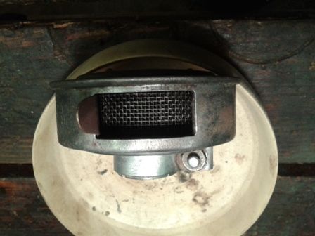

Post by Woodsman on Fri Dec 05 2014, 17:35
Been working on the Villiers MK25 and, as seems usual, the air filter mesh was a mass of rust. So we thought why not try the magic potion?
First soaked in paraffin for a few hours to loosen up any remaining oil, then heated it up with hot air paint stripper to burn off residue - a tad smokey, should have done it out in the fresh air.
Then dropped it in citric acid solution overnight and look at the result. Apologies for not taking a before pic, you'll just have to trust me Smile
