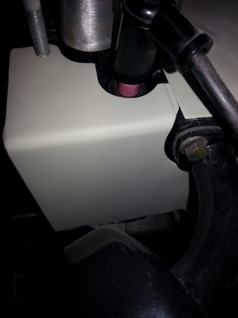

Cowl cosmetic operation
Post by Mark15 user on Mon Oct 13 2014, 16:48
Dear Forum members,
I've started the cosmetic work on the cowl.
The most work was to straighten the top plate near the spark plug.
The cracks where welded by TIG welding.
A local welder helped me with this job.
To get more strength for the bolt connection I've decided to weld on a ring to the plate.
Also a few dents on the radius near the flywheel where filled.
After straightening and removing the rust some filler was added . (See picture)
I've used Motip spray putty which fills up small skratches.
A lot of sanding, and refilling later the original shape came back Laughing
I've finally found the right top coat color.
A local car parts shop has made spray cans for me with the right color.
Due to the sunshine the green color looks very bright on the picture.
However the real color comes close to RAL 6001
After all I am confident with the result.  Smile
