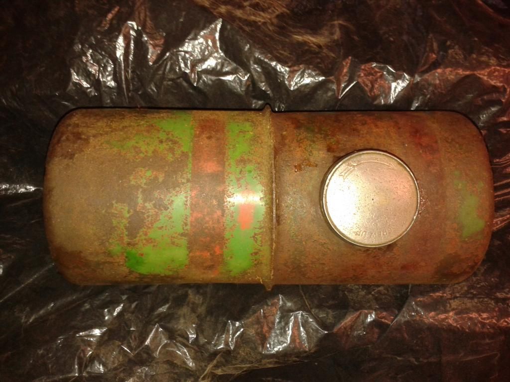

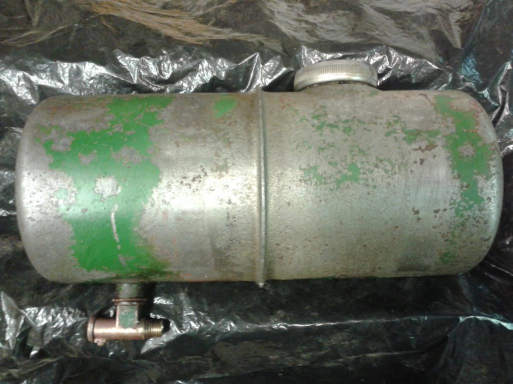

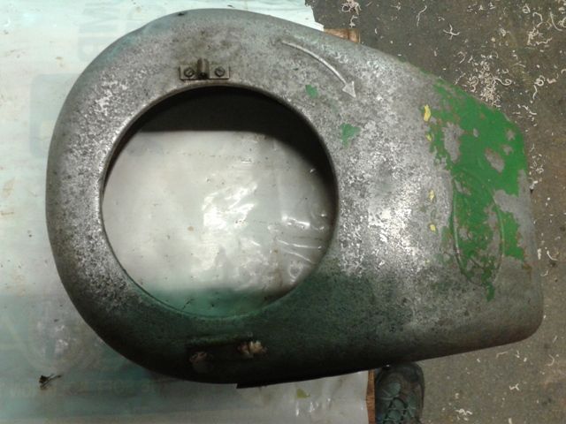

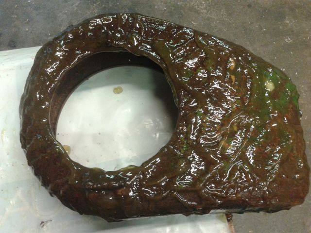

Cleaned up tank by pickling in citric acid solution (see my thread).

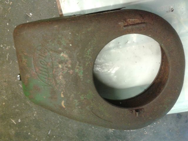

Same for the cowl using same solution mixed with wallpaper paste.

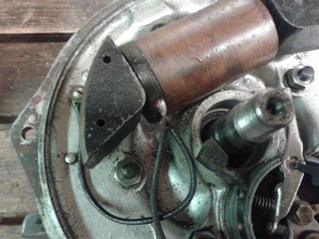

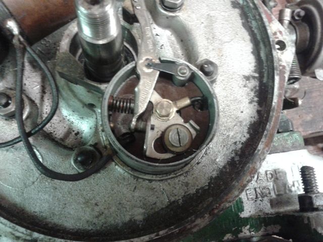

Off with the flywheel to sort the ignition side of things. Points look OK
but coil was goosed
Being a Yorkshireman there was no way I was paying four times what I paid for the engine just for a new coil so I decided to follow the excellent Coil Ignition Without A Battery "how to" by Matt (nutgone) rewound the coil then mounted an external ignition coil. Now getting a good spark.

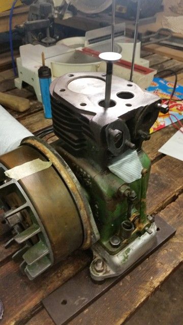

Meanwhile, I showed my son how to use grinding paste and a stick and left him to it - did a fine job.

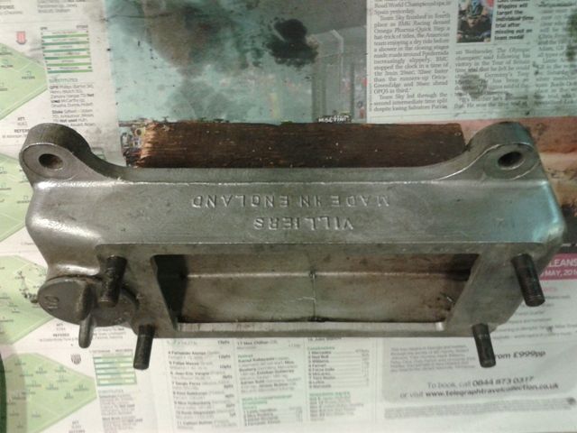

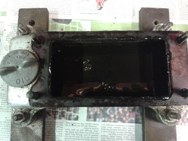

We took the sump off and although it looks like it never had an oil change things look OK. Yes, there are lumps in the bottom!
Now nice and clean.

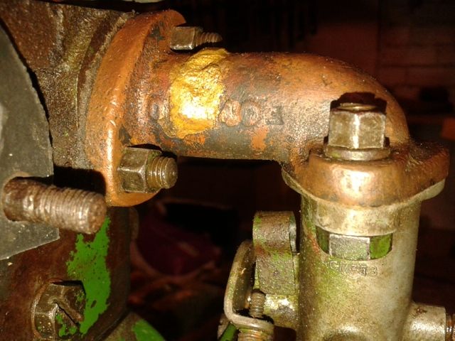

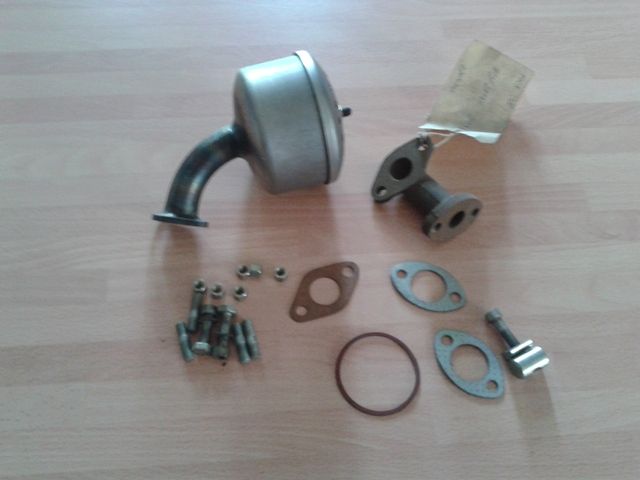

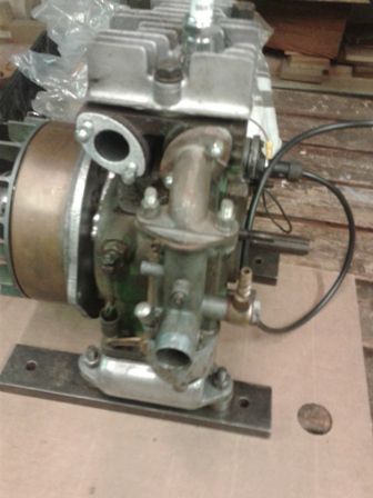

No exhaust and inlet manifold had been repaired rather crudely.
So ordered new plus some other bits and bobs from L&S Engineers. Really helpful people, great service and reasonable prices. Arrived next day!

So I have done more work on the tank and cowl.

Cowl and tank looks very clean. seems that citric acid is the good medicine to get rid of the rust.

That looks like a pretty early Mk10 with the brass id plate on the side of the cowling.

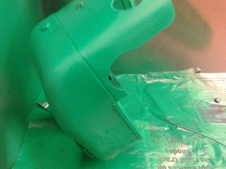

Post by Woodsman on Fri Nov 21 2014, 16:23
Ok, my son has arrived so we can make a start Very Happy

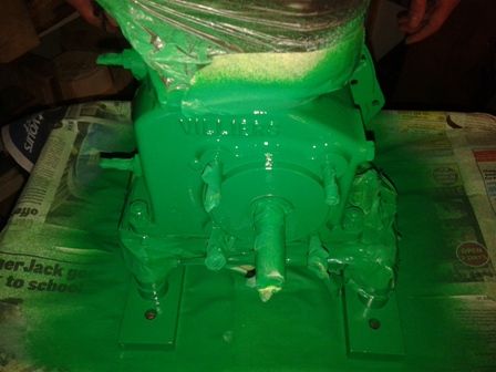

Start priming (boring so no pics) and painting ( yeah - it's bit bright ain't it)
While everything is drying we start fitting new parts.

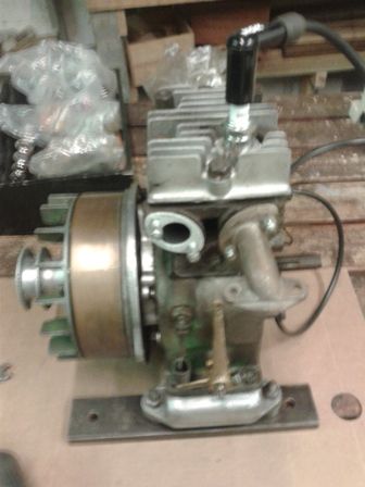

Fit new inlet:
Refit carburetter:
Fit new exhaust:

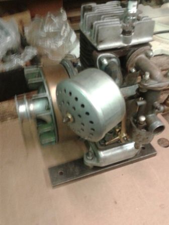

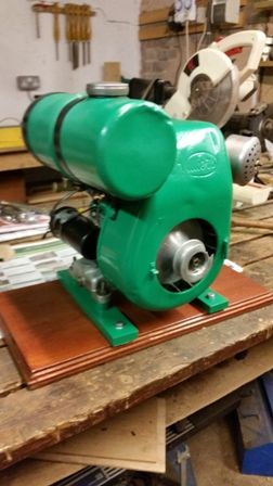

Refit cowl and tank and we're done:
Yeah,  the fuel pipe is in the way should we want to couple something up but - whatever.
Apologies to Steef for not maintaining his high standards on the paint job, but we were more interested in the engineering side of things.
