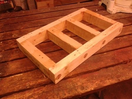

Good grief ! Not only is Steef a meticulous engine restorer, turns out he's a dab hand with CAD software. Nice work Steef.
By some strange coincidence I've just returned from my workshop having started making a trolley for my latest project (more later).
It's not going to be what you would call exhibition standard but it will do to drag the engine around the workshop.
Where would we be without pallets?

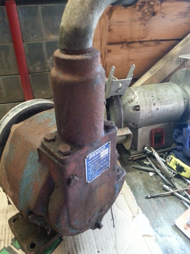

Dear Forum members
Last saturday I've picked up the vacuuumpump
The vacuumpump was still mounted and luckily I've taken a toolbox with me.
I've salvaged the pump, the vessel and a mounting table.
The brandname is Benco from Malmo Sweden.
The balvalve is temporary mounted to keep dirt away from the internal
See some pictures below
Best regards,
Steef Pronk

Trolley frame made from Bankirai
Dear Forum members,
Finally an update on the trolley. After the finishing of the vacuumpump I started the woodworking.
I've used some old wood to continue the made of a wooden connection.(mortise joint)
However the straightness and movement in the connection were not at the level as I had in mind.
To keep the project going I've decided to use screw connections now and keep practising my woodworking scales.
I've found a local woodshop in my hometown which has an attick filled with a varity of wooden pieces in all kind of grades.
I never realised that there are so many different wood grades.
The people over there are friendly and willing to help.
For this trolley I've decided to use Bankirai wood (45x70mm) beams.
Compared with the wood beams I saw at the local shops like Gamma; the straightness is very good.
The pictures below are showing how I've made the frame.
The screws are stainless steel 6x100mm
Hope this is strong enough to keep the frame together.
See also the temporary mock up I've made with the new frame.
The plywood plate is only for a quick fit. It will be replaced by a more decent one from the woodshop.
The next step is to assemble the "wheel suspension".
Keep you updated!
Best regards,
Steef Pronk
