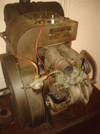

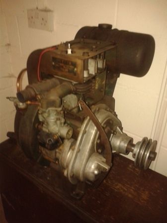

When we started this stationary engine malarkey I promised my son I wouldn't buy anything that I couldn't pick up and put on the bench by myself. Last week I reneged on that promise and we are now the proud owners of a Petter A1.
Engine Number is 556568. It has a Wico Type A 1057 B magneto. and Zenith 24T02 carburetter. We have only limited documentation as yet so any info gratefully accepted.
So far as we know the various marks relate to driving and starting arrangements. Ours is starting handle on flywheel side and drive pulley on governor side. Can anyone confirm which mark?
It has a Wipac sediment bowl in the fuel line which has a small lever, presumably On/Off.
Tinternet suggests that you need to be careful about having your thumb in line with fingers when starting in case of backfire but our handle has a ratchet arrangement.  Again Tinternet suggests closing 'strangler' when starting but ours also has a decompression lever. Seems you would need three hands - any suggestions?
We also came across a few comments about not cranking whilst HT lead was disconnected and it should be earthed to avoid damage to magneto coil. Not sure about the science there - surely the resistance of an air gap at atmospheric pressure would be greater than compressed hot fuel vapour?
Does anyone have service/repair info for Zenith 24T2 carb and/or Wico 1057 magneto?
Regards Paul

A nice looking A1 there.  You presumably have a drive from the half speed shaft (camshaft) which is different from the more usual A1's.  The decompressor shouldn't be needed really, though starting is easier from the camshaft end as it is geared down of course.  Everything looks in good condition. if you take another photo of the front end of the engine and email it with the one on the forum and the engine number etc to Jim Perkins (retired Petter service engineer) at jimp1115@btinternet.com he will date it and tell you who it was supplied to originally.  He may even scan a manual for you if you ask him nicely!

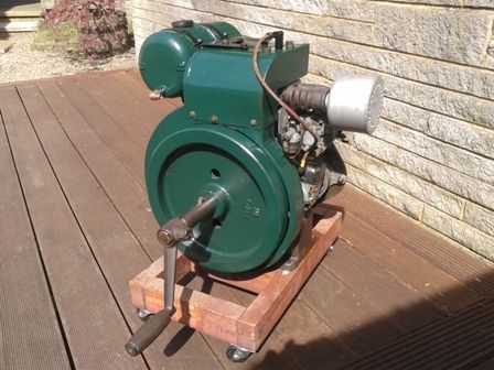

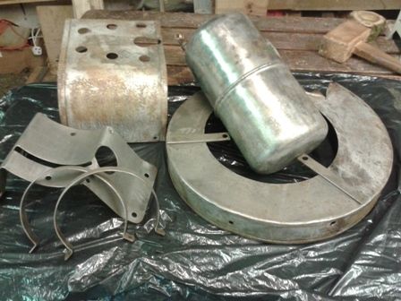

Post by Woodsman on Fri Apr 10 2015, 16:01
Tin work is coming along nicely.  Needs a bit more work on the top half of the cowling then we'll throw some primer at it.
Regards Paul

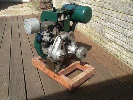

Post by Woodsman on Mon Apr 27 2015, 08:33
All done ! Don't look too carefully at the paintwork - got bored with rubbing down.
Regards Paul
