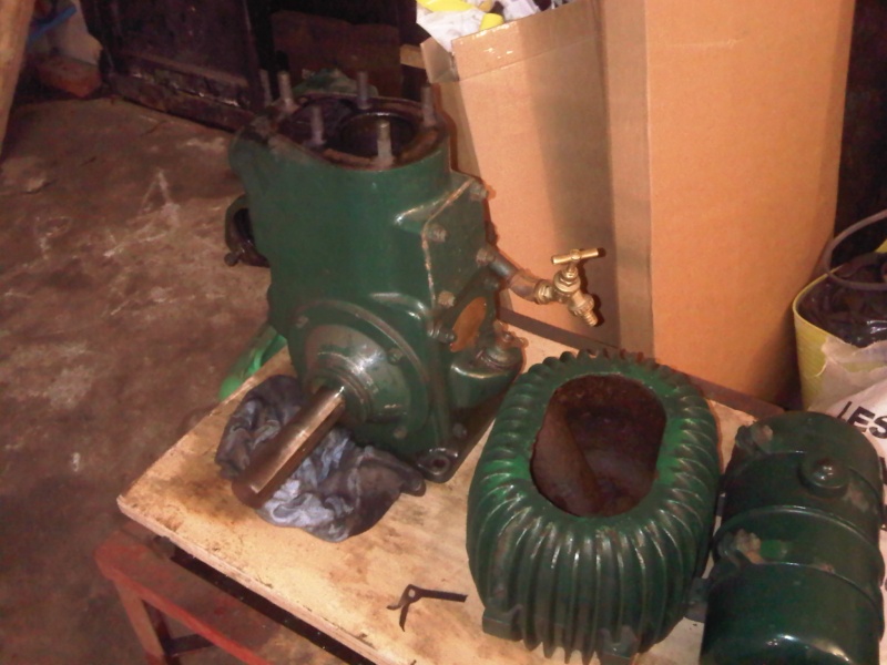

Well for a few months ive been wanting to do a restoration but i didnt know which engine of mine deserved it until tonight!!
I decided to give my Wolseley WD8 the treatment!!
This will be my first proper paint strip off, decoke, valve ground restoration!!
Tonight with some help from John i took off the Flywheel, the head, water jacket door and tappet cover!!
Here are some pics below
As you can see in the second picture there has been alot of build up rust but some of this was caused when i first recieved this engine as the hopper was really flakey with rust!
The piston had alot of carbon along with the valves etc so all of that will be cleaned!
Its funny to see my engine in bits!!
Anyway i dont want to rush with the restoration so i will post things when things have been done more progress!
Hope you enjoy

So how do you remove the valves to grind them in? I've never done it but, would like to know. Also how easy do the cylinder head nuts come off, looking at all the rust that fell out they must have been well rusted up or did you fill the hopper with diesel for a few days first and let it soak in.
Stu
Stu
Re: Wolseley WD8 Long Period Restoration begins!!
Nuts SHOULD be brass Stu, and the valve's are accessed through the tappet cover (shown removed in the 2nd from last pic). Same as a PT, the valve's are retained by a pin through the valve stem. The water jacket plates can corrode away so need to be checked while off.

Foden wrote:Nuts SHOULD be brass Stu, and the valve's are accessed through the tappet cover (shown removed in the 2nd from last pic). Same as a PT, the valve's are retained by a pin through the valve stem. The water jacket plates can corrode away so need to be checked while off.
Pete
Exactly that Stu
Hi Pete!
Yeh my water jacket plate needs replacing as its thin and rusty
I cant wait to crack on but need the paints first before i take off the old paint
