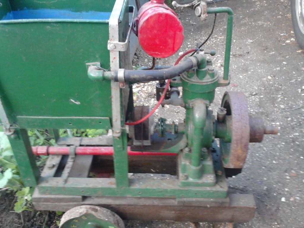

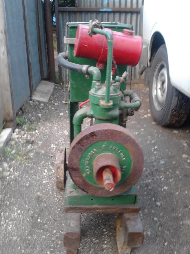

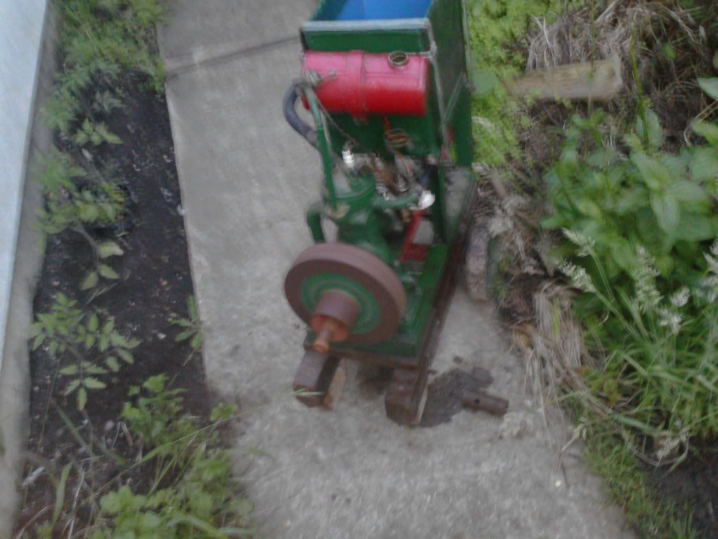

Amazing what you can pick up on your way to Lidls! Very Happy
She is a burg supreme 1hp (?) from the 20's/30's , managed to get her going but needs a bit of tweaking

Have found the problem with the mag, the points are very unusual, inside the back of the mag there is a ring with a step which goes halfway round, which works like a cam as the points rotate, and there is meant to be a piece of bakelite which hits the step, but it looks like a bit has come off, probably why it stopped!
What I plan to do is file the bakelite back flat, then stick a little piece of circuitboard to it to make up the difference

Well I tried it but it came unstuck! next step to drill out the rivets that hold the pad in and try to file a new one out of nylon, want to keep that mag on there because ut really looks the part
