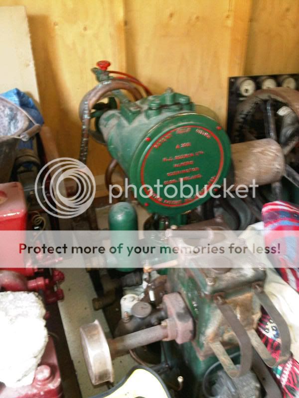

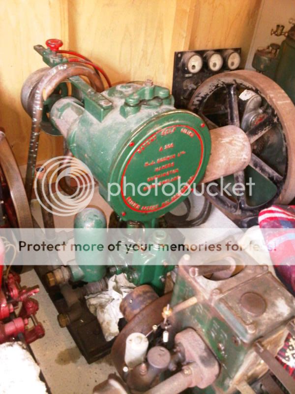

Post by Villiers on Mon Apr 25 2011, 12:20
Here are some photos of mine Mike.
Suffolk boy born and breed, strong in back and thick in head

Post by mike d on Mon Apr 25 2011, 23:40
nice one rob....
mines getting there,but like i said due to my back problem,it all takes longer now...
im hoping to get it sorted soon....very similar to a Lister H1/H2 when you remove the brass covers,the valves and rubbers are the same...
did you know Godwin made a lot of the Lister pumps...read the Lister book...
perhaps why thay are so very similar on the inside...
regards...mike...
