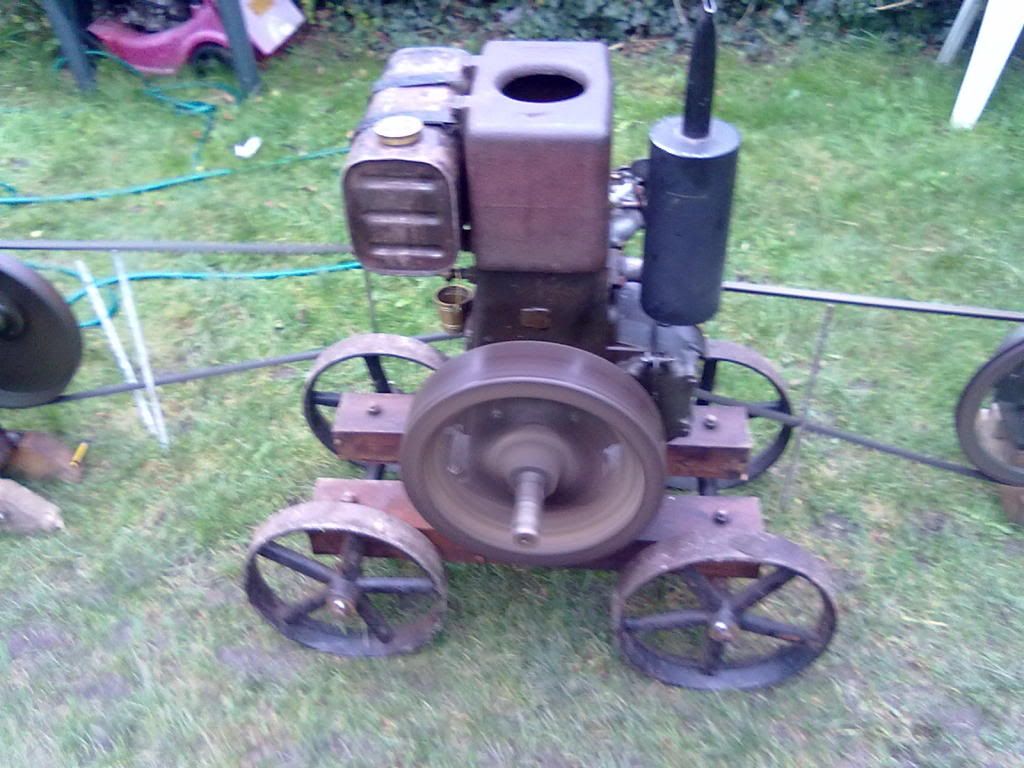

Ruston PT 1.5hp 1946, purchased last year as a non runner, but did get it going for a few minutes without too much fuss, but the frost damage turned out to be much worse than first thought, and on closer inspection it appeared the engine had been left full of water for quite a while, but this has all been cleaned out, frost damage has been repaired, just needs a set of rings, the new main bearings fitting into a Wolseley WD housing, as they are slightly different to Ruston bearings, but if a cut out is made in the housing for it to clear the timing gear housing, it will work fine, the thread on the end of the crank also needs attention.

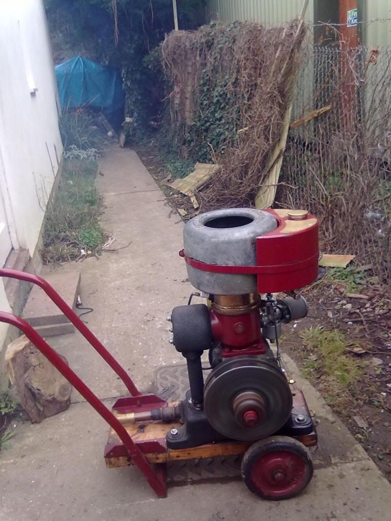

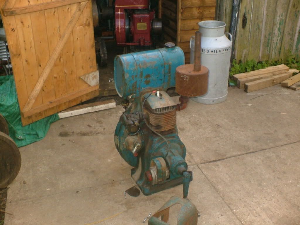

Ex-Aerograph Villiers WX11, bought as a runner

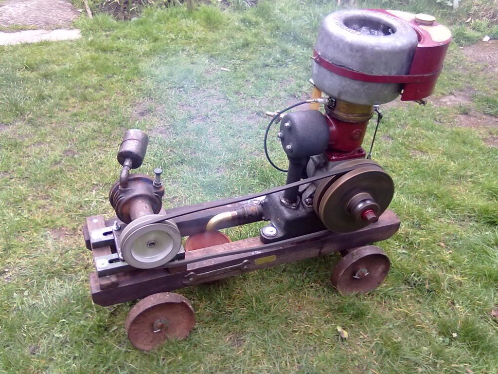

now part of an alfa-laval milking set

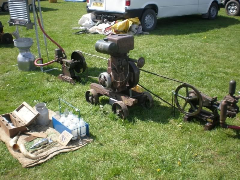

1942 Fowler 1PAL

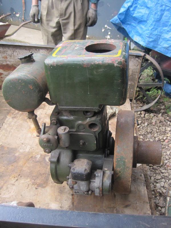

1958 Wolseley WD8, unusual petrol/paraffin version, bought as a non runner at the GDSF last year, got it back to the van, and put my NOS mag on it and away she went, will soon be getting the nasty paint took off and an oil change
